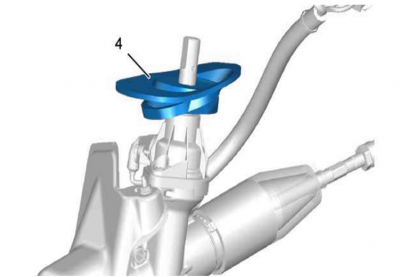

Ok, so these type of racks with the electronic power steering are built on to the rack and aren't available separately from the looks of it.
The steering column should fit onto the pinion (see picture below:) 4 is the rubber seal.

Maybe this pinion is the issue on my car. I also have popping sound sometimes. And from information I could find, this is symptom of intermediate steering shaft. But this car does not have it.
In which section of service box did you find this rubber seal?

@GiveMeABreak
Would you please share where in the service box you found this image? I went over all sections and couldn't see anything like this.

It's not shown in Servicebox parts so is possibly supplied as part of a new rack. This is contained within the removal procedure.

Thanks, didn't occur to me to take a look at removal procedure. I see it now.
