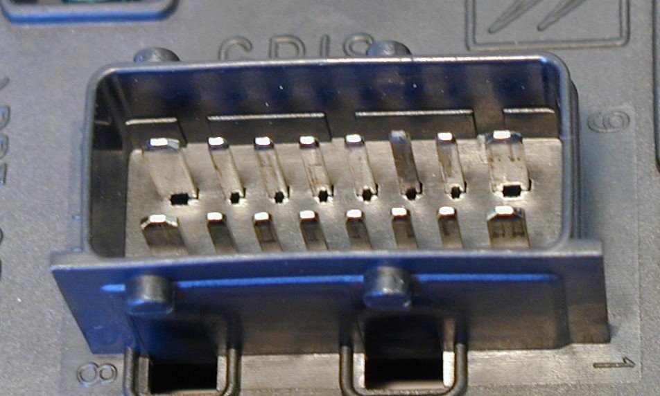

You need to closely check the pins in the 16 pin grey connector, both the plug & the pins in the fusebox the pin normally discolours in the fusebox, on the plug itself you get very slight melting around the terminal, its not normally in your face obvious.

Do you have a mk1 or mk2 ? There are at least 3 16pin connectors on a mk1 BSM
If you don't have a plug like below it sounds like you have a mk2
The first pic shows the discolouration of the pins.

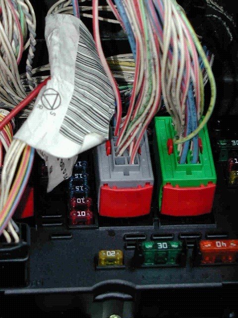

Re: C5 V6 (2005) - turns over wont start :(
Ok that's a full CAN BSM you can ignore the above.
I would regard the C5 you have as a MK2
The fuel pump supply should come from pin 5 of the 28 way grey connector via fuse 5. They are not known to burn out on this fusebox though, just to aid with diagnosis.

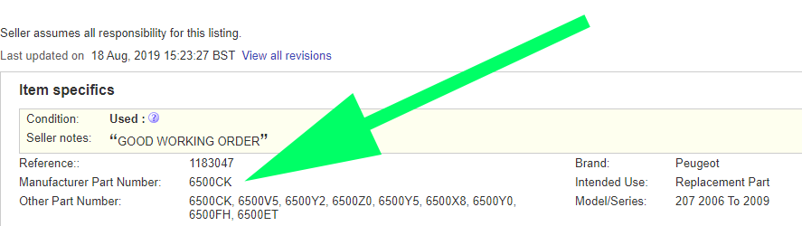

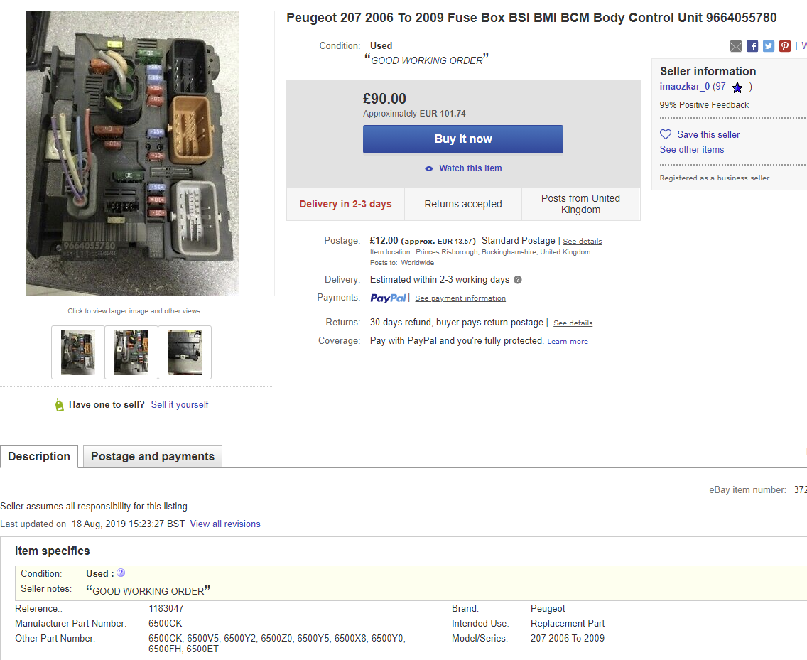

Some sellers are notoriously inept at knowing what parts are correct - and will often list parts as being compatible when they are clearly wrong! A case in point - here is a seller flogging a BSM for a 207.
Click the image to zoom - and at the bottom of the listing, you will see they have probably thought 'what the hell - let's put every part as compatible and let the bu**ers sort it out themselves'
Click Image to Zoom You can clearly see they have listed amongst others 6500CK which is not even listed for a 207!!
A close up:
As it turns out there are only 3 BSMs for a 207: 6500FH, 6500HW and 6500HV
Well 1 part number correct out of 9 - say no more....... like I've always said - flipping useless.

Part number was 6500CK - its the same part number for every facelift C5 (got it from service citroen). However the numbers on the side are different.
