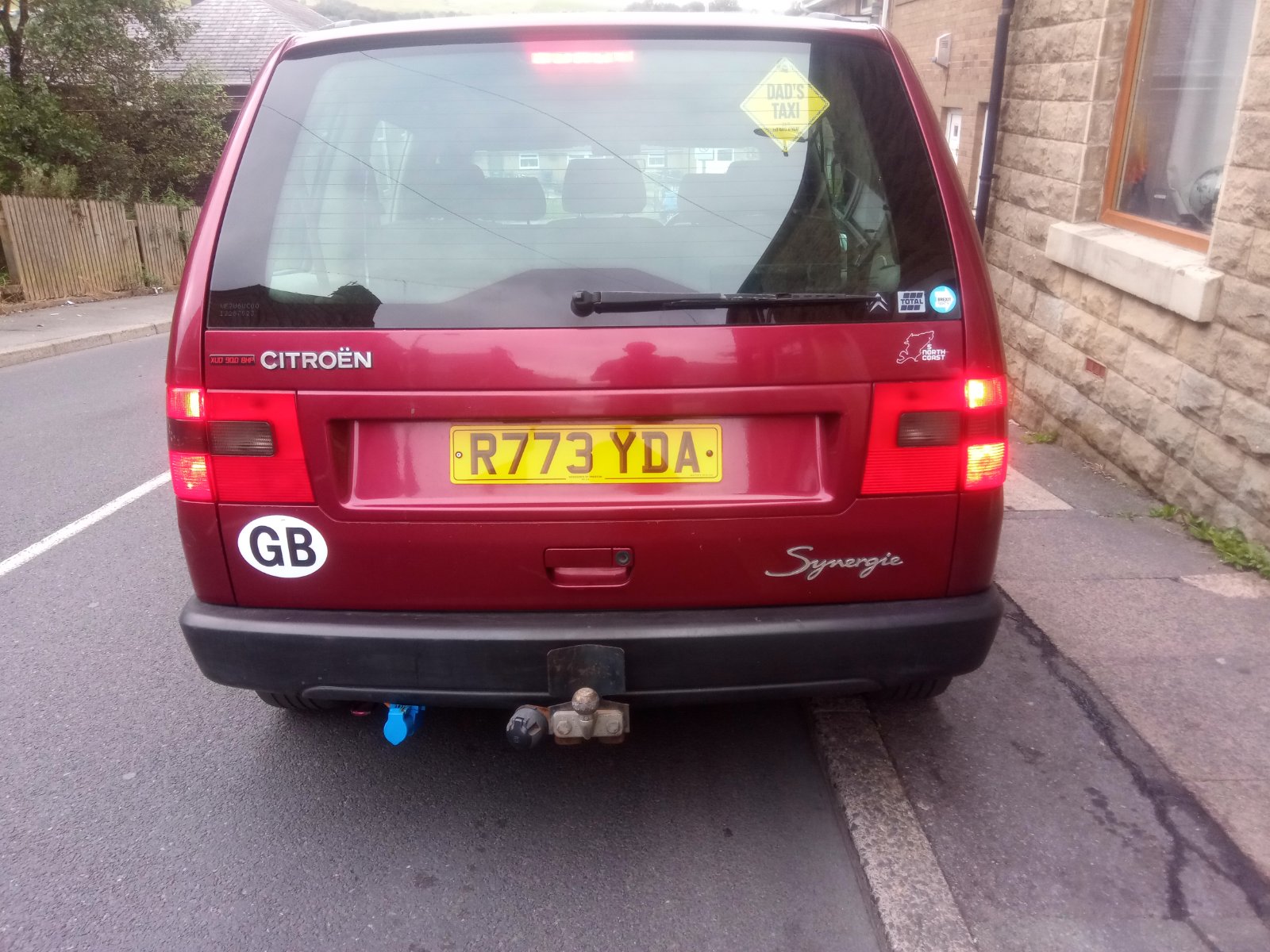

The parts diagram above confirms outers as
top: 21/5 stop/tail
mid: 21 direction ind
bot: 21 stop
The lampholder assembly itself will confirm the interconnections between top and bottom, as well as supply points and earths.
Earths - never assume! 4x21W is a significant brake light load, and needs some good connections. If needed, run an extra earth connection to body.
Left-Right cross connections between light fittings have also been known to fail.

Correct. I believe it to be a feature rather than a fault. The top bulb holders are 21w/5w, the bottom are 21w. As confirmed on Citroen service above.van ordinaire wrote: 16 Sep 2019, 00:13 There seems to be a bit missing the point here, everyone's gone into fault finding mode but, at the moment, we don't know if there's a fault because no one can say what the function of the lowest lamp is.
IF the Synergy has 4 tail lights, the lowest bulbholders should have 5w bulbs in them & if 21w bulbs had been fitted in error they (a) may have burnt out because they're not really meant to burn for extended periods & (b) that overload might not have blown the fuse (as one might've hoped it would) but caused all sorts of other problems. Absent a wiring diagram (& assuming the handbook doesn't help) the colour of the wiring MIGHT help - 'though being a Citroën, probably not![]()
It is 2x tail lights, and 4 x brake lights, although only 2 are being used with the "feature's" preference being to the bottom ones.

Ok. I award myself 50 stupid points. After pulling everything apart and getting busy with a multi meter, I couldn't find and reason they weren't working. The bulbs looked fine, and weren't that old. But I replaced them anyway....... And erm....... It may have been the bulbs
