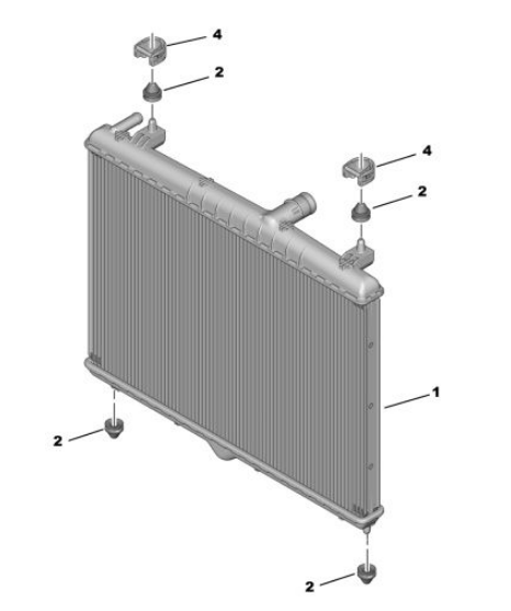

16 is the bonnet lock. The radiator is fitted on elastic dowels (2), so is designed to be firm but slightly pliable - but not enough to move it like you describe.

There should be very little movement of the radiator - perhaps just a couple of mm, against the rubber bushes.

When I checked mine yesterday, the push-fit location lug at 4 (above) was slightly out of its socket. Nothing drastic, but it just wasn't sitting where it was designed to go and didn't seem to want to sit snugly.

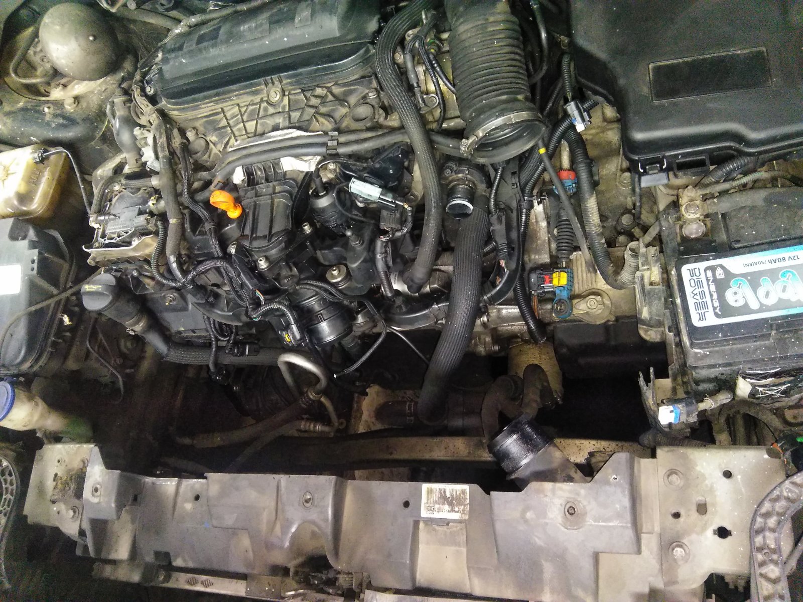

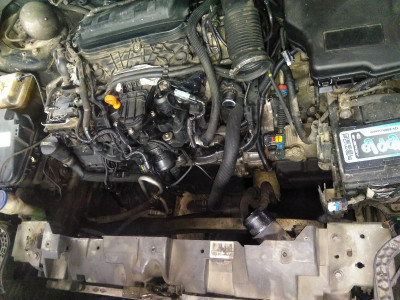

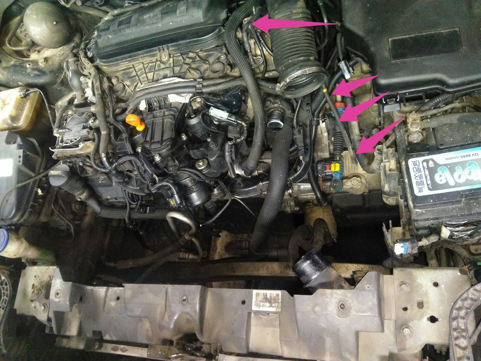

I do not know... visit it today... and new radiator is now on... tests in course...(photo made before)
But, in the bay, there is one confusing tube, (also for "expert")... it is unattached on one side, and we do not know for what it is, and where should go..
Can somebody give some idea... it is tube next to the battery, after ribbed one... tin black hose, with yellow ring some ?0cm from end of tube (look at photo). Other end enters black box on top of engine, were injectors are...but where should other go!?

Re: C5 X7 Radiator burst

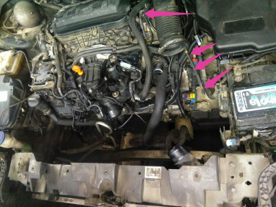

Can somebody identify this hose? From and where should go... ? It starts under black cover (top arrow), and ends unattached...
tnx
tnx

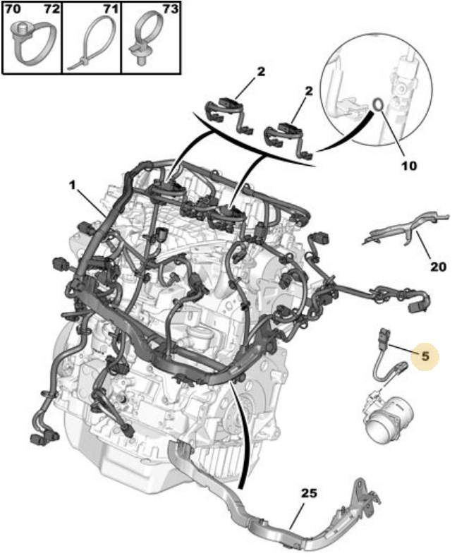

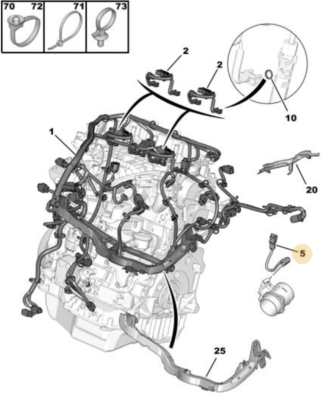

I am trying to identify it - and so far the only thing I can see vaguely near the top cable is the injector harness:

car is working normally... today city ride... temp never rised over 80'C ... no errors... but this hose rimaned under unatached... and now worm is biting me what should it be...Auto industry don't waste hoses just for fun...
As I can see here are only cables... this was rubber hose some 3-5mm inner diam (luce vacuumm ones)... no idea still... Should I try to dismantle everything to see were it starts?GiveMeABreak wrote: 04 Sep 2019, 16:45 I am trying to identify it - and so far the only thing I can see vaguely near the top cable is the injector harness:
- x 1751
Yes, what you have is a pipe, not a wiring/harness.
See whether you can identify exactly where the pipe leads to on the engine block.
