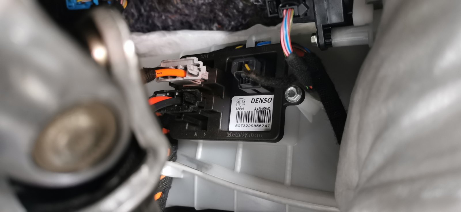

looking at the diagram uploaded and what is visible under my panel it looks like the control unit outlined is in fact the heater resistor unit on mine. Looks similar but not quite.
The heat is working when switched up and so is the aircon. Is there another control unit?
This device is bigger and more towards the central console l. Any help appreciate.

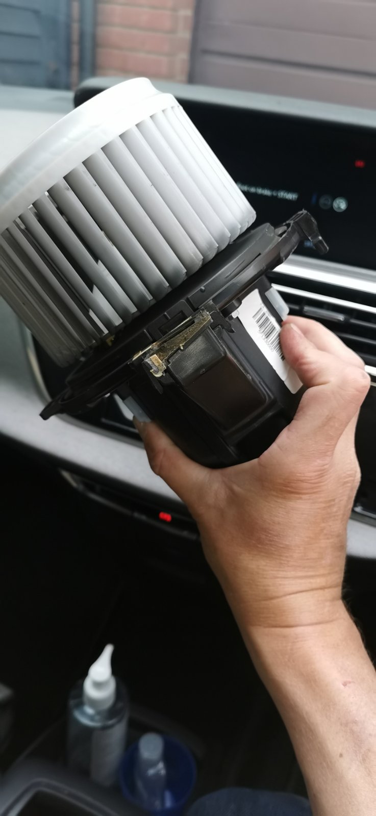

I got the blower itself out to see if there was anything attached to it or behind but nothing.
Could it be something as simple as a fuse?

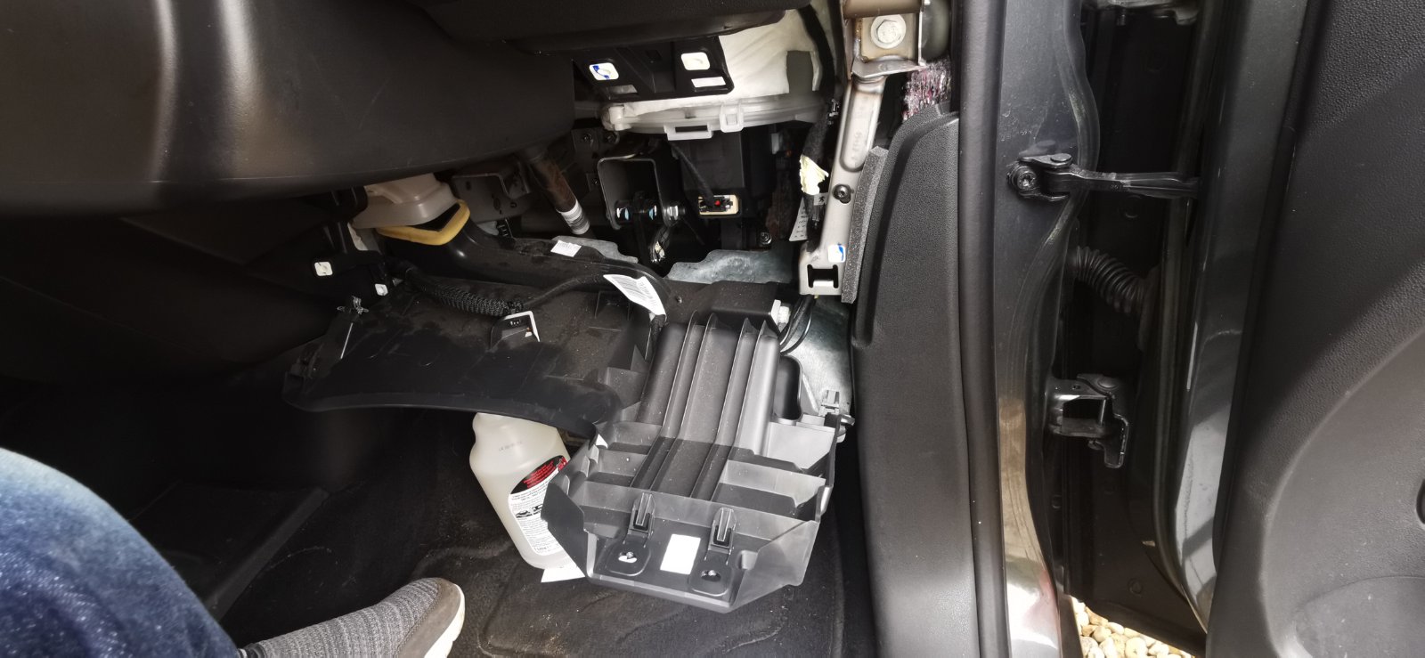

What are you looking for? This thread has multiple posters, so gets confusing as to what the issue is and what you are trying to find. The units in your bottom picture on your previous to last post are either the air distribution or air mixing reduction gear motors. Best to pop your VIN up as not all these are the same for all vehicles....

Hi Marc. Thanks for replying.
I'm looking for the blower control unit as mentiond and illustrated in the previous post history. It may be because I have the Exclusive+ model.

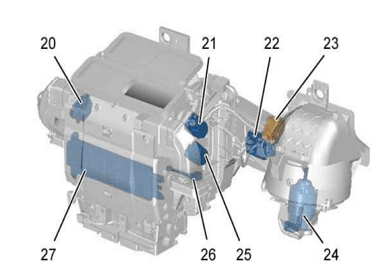

Ok, so these are your system components:
Key:
(20) Mixing stepper motor (left side).
(21) Distribution stepper motor.
(22) Blower motor control module.
(23) Air intake stepper motor.
(24) Air blower motor.
(25) Mixing stepper motor (right side).
(26) Evaporator temperature sensor.
(27) Passenger compartment air heating resistor (*).

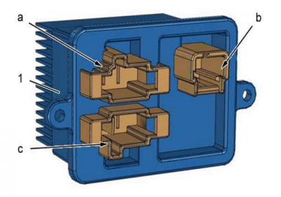

You will have a digital Air Blower Control Module:
(1) Digital air blower control module.
(a) 2 way connector.
(b) 2 way connector.
(c) 2 way connector.
Supplier: Meta System.
Control voltage of the blower motor as a function of the value received
Key:
| Value received (As a percentage) | Control voltage of the blower motor (In volts) |
| 30 | 4,4 |
| 50 | 7 |
| 80 | 10.9 |
| 95 | 12,2 |
| 100 | 12.7 |

Re: C4 Picasso 2014 Exclusive - Air Con Fan Issue (new Shape)
Brill thanks Marc. Thanks for confirming.
The reason I got confused is because when I search the same part it comes up as the heating resistor unit.
I'll source and replace. See what happens.
