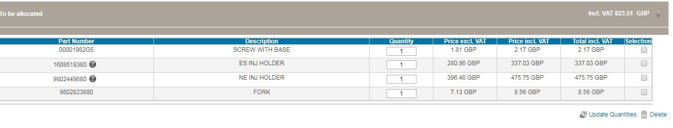

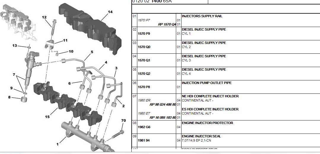

Here's the diagram
You can see the part number was revised. I presume NE is new, and ES is refurbed (although both carry an exchange surcharge). Recommended to replace the fork and bolt at the same time, as otherwise they sometimes break a bit later. Prices....
You may well be able to get a genuine one cheaper from a diesel specialist. You will need to program - although the are the same part no, they have different characteristics which the ECU needs to know about. Oh, and you should probably replace the copperwasher at the bottom (which the injector appears to come with) and re-cut the seat while you are there....
Edit: here's one at about half the price!! https://www.pfjones.co.uk/citroen-ds3-1 ... 13556.html
