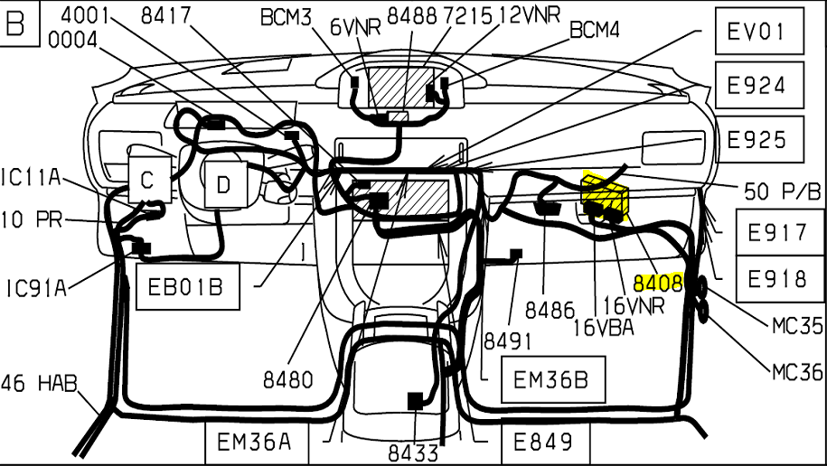

The amp on a left hand drive C6 is located under the passenger (right) side - probably behind the glovebox compartment:
The identifier is 8408 below and I've highlighted it in yellow for you.
Click Diagram to Zoom

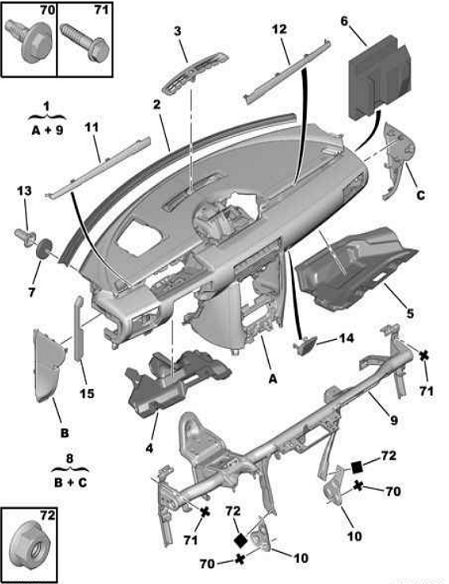

You may be able to partly access it from the end of the dash - open the door and try and see if you can access it by reoving the dash end trims - shown here as 'B' and 'C' on the diagram.
