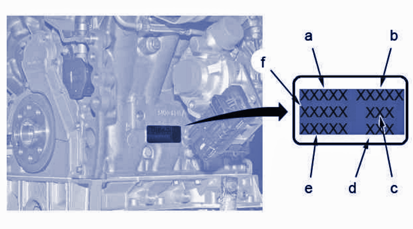

One new question as I do not see the need to create another thread. The engine number on the 2.7 v6. Where on earth is that number as I need it for police clearance. Sigh.

I need the physical spot on the block of the engine for visual confirmation, unfortunately

Re: Citroen C6 brake caliper rebuild
Ok, so the engine identification is in 2 locations:
First is engraved on the Cylinder block:
  • "a"Production line
  • "b"Date of manufacture
  • "c"Legislation type
  • "d"The name of the manufacturer
  • "e"Identification marking
  • "f" production serial number

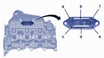

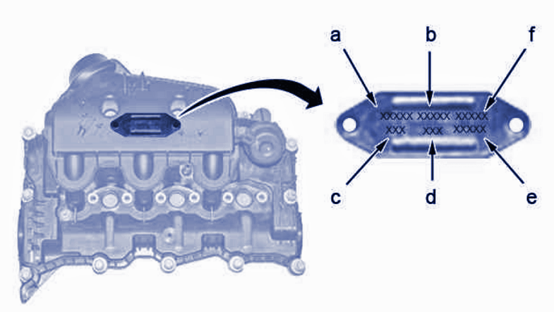

Second is on the plate of the front valve cover:
