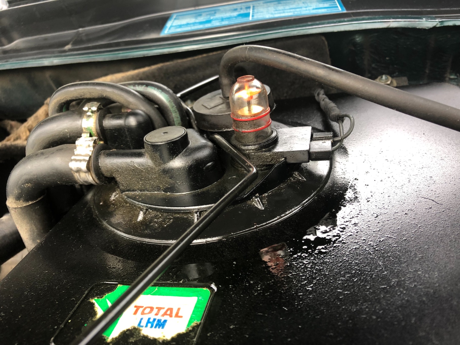

Indeed it is way overfilled, sat at high on idle for 5 minutes before taking the photo attached :shock:
And this is after the blow out...
Thanks for all the replies, New spheres is ordered and in the morning I'll siphon out till it's within spec :-D

I wouldn't change the spheres until the LHM is at the right level, a Citrobics session has been run, and then taken for a decent test run. It is likely the spheres are OK (but having spares is a good thing).

Small thing... It has been known for the LHM reservoir float indicator to get stuck! To check, just unplug it, and rotate about 90° anticlockwise, and it will lift out. A purely mechanical float device.
Orange-yellow disc indicates the level, not the gold metal one.

Just popped out and checked the level indicator. It was not stuck, so it is quite overfilled. I will follow your advice on loosening the spheres, esp in spring after all the salty slush roads we usually get over here. While driving from work today I heard the servo pump (I think) starting to make some whining noise in all corners and some on idle aswell.

Siphoned out ~1,8l of LHM yesterday, going to do a citrobics session as soon as I can! Every corner seems to have the same amount of bounce and it seems to start rising/falling quicker now with the right amount of LHM in the system.
