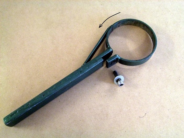

You can make a reasonably decent sphere removal tool that will work with all but biblically tight spheres.
https://www.frenchcarforum.co.uk/forum/ ... hp?t=21850
- x 1746
Re: Just bought my first Xantia, LHM sprayed everywhere.
A DIY item, similar to the Pleiades design

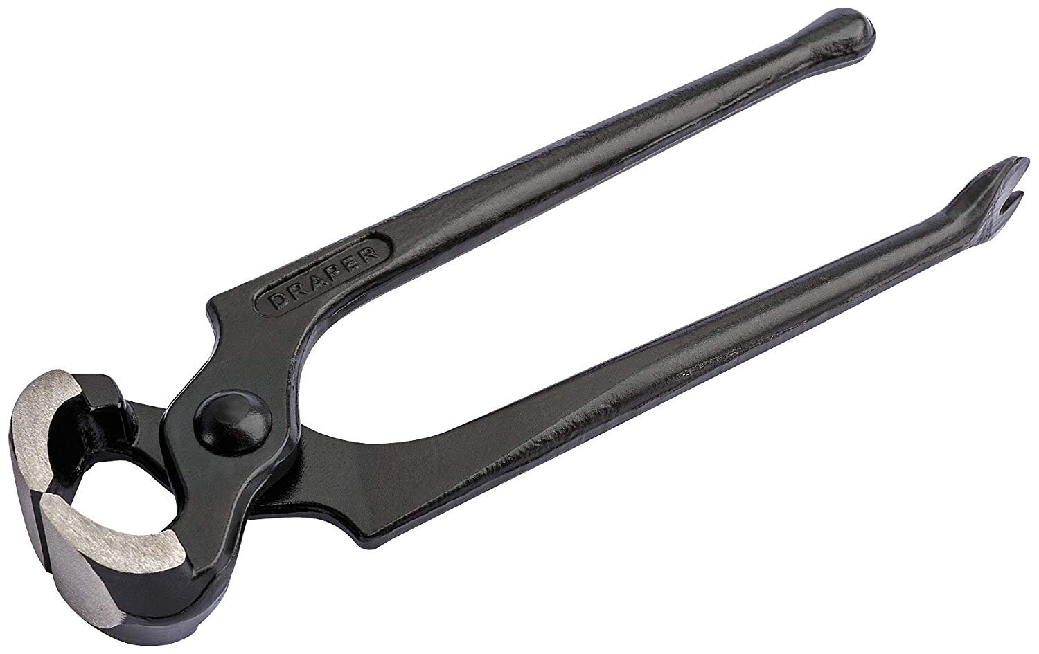

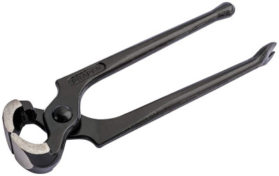

The mechanic I used to use had a gigantic pair of pincers, about five feet long, came from the docks I expect. Made the job very easy.
Like this but the 'pincer' part formed a circle slightly smaller than a green sphere.

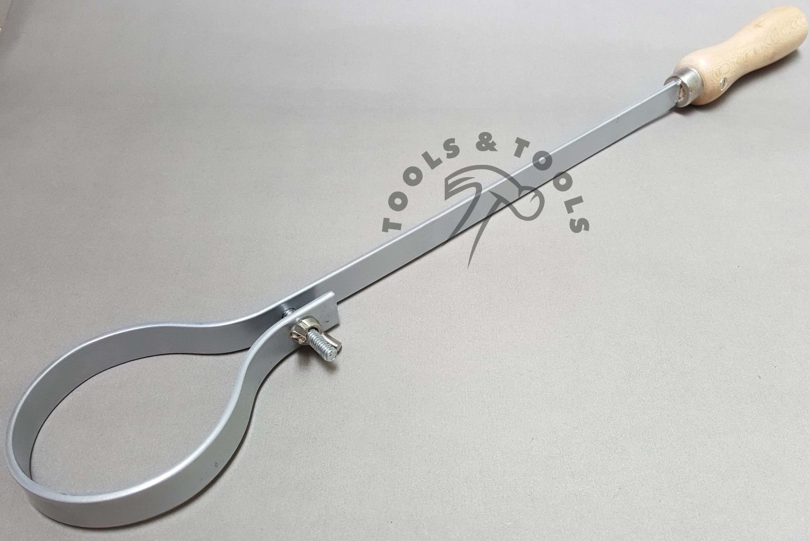

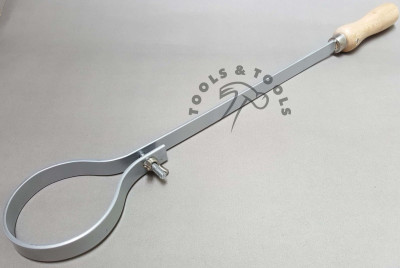

Heavy duty crucible tongs, maybe?myglaren wrote: 17 Jul 2019, 12:45 The mechanic I used to use had a gigantic pair of pincers, about five feet long, came from the docks I expect. Made the job very easy.
- Posts: 28745
- x 5674

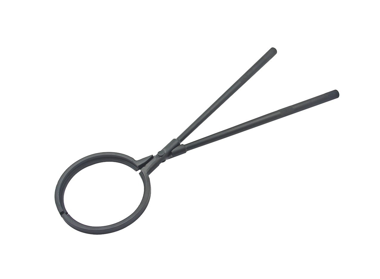

white exec wrote: 17 Jul 2019, 14:21Heavy duty crucible tongs, maybe?myglaren wrote: 17 Jul 2019, 12:45 The mechanic I used to use had a gigantic pair of pincers, about five feet long, came from the docks I expect. Made the job very easy.
Quite possibly. They were close to the Doxford engine works and I would guess that they came from there when the works closed down.
Very similar to these but a bit more brutal
And look what came up on that image search
Could be a possibility for the spheres.
twelve quid
- x 1746
That last one would just b-e-n-d
My DIY one above was originally made with just one 8mm thick handle, but even that was too whippy to clout. Welded on an extra 8mm, and the photo shows the result. Works fine, and not too long to use in a confined space.
