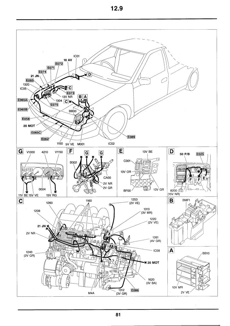

There is a component location diagram for the 1997 V6 linked from this topic: viewtopic.php?f=3&t=40570&p=326638 I think that the 2.1 locations are fairly similar.

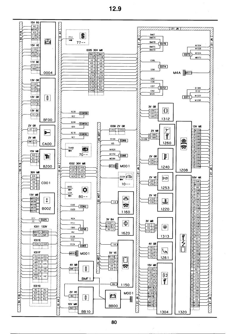

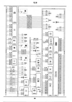

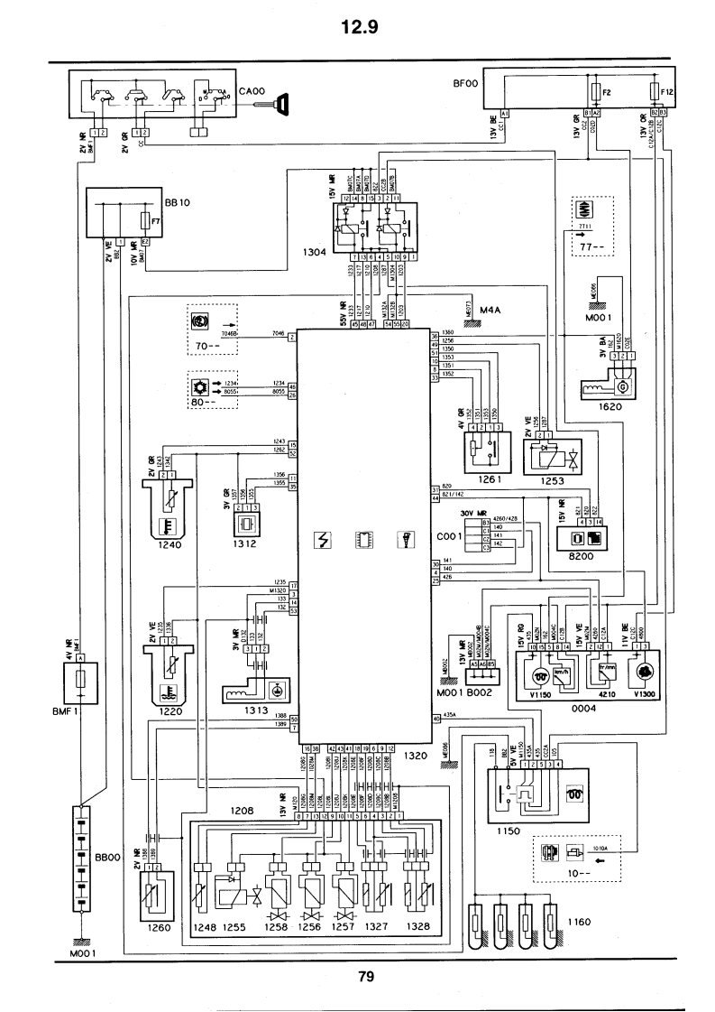

Details for 2.1TD (XUD11BTE) injection-ignition, from Xantia manual.
Might be of help with component location.
