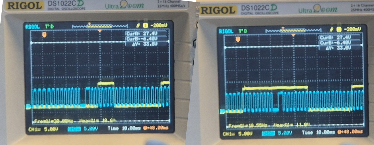

Latest Discovery:
Hooked up oscilloscope and checked crank and cam signals: Timing seems OK from what I can see.
I can clearly see the first and second crank pulses (blue) repeating during cranking. They have same period.
Any suggestions on what else I should check? Can somebody ensure that i see what I should see on diagram?
Thanks in advance for your input!

Latest Discovery:

My car, also a Citroen, but petrol, slipped some teeth and then did not start. Got a p0341. I redid the timing and engine started.
If it keeps throwing same error code, the timing should be the problem.
DO NOT USE AFTERMARKET SENSORS FOR CAM AND CRANK. Put back the genuine ones.
On 1.6hdi, the crank pinion has a notch/hole larger that the woodroof key from the crankshaft, and it you don't find the right position of the pinion the engine wont start. Does your engine crank has a woodroof key that fits perfectly into the notch/hole of the pinion or there is some left-right play?
Come back with an update.
