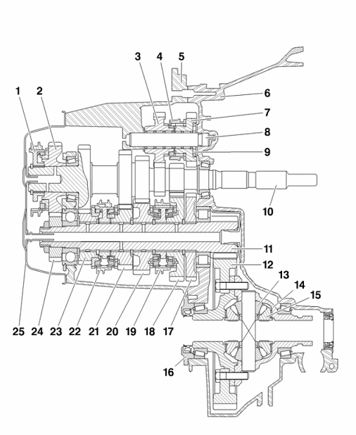

A bit late to the party, but if it helps....
As per VIN, Fastjet has a DW10ATED 110 with the BVM5, ML5C gearbox. The ML5C compact version is an evolution of the ML5T Gearbox:
Key
- Reduction in length: 14 mm
- Improvements in the gear change forces and travels
- New "chandelier" type gearbox control grille with specific gear lever gaiter
- Reverse gear unlocking device
- New flexible support for the transmitter on the hydraulic clutch control
- New reverse gear switch
- Increase in oil quantity due to the engine tilting
| Reference | Designation |
| 1 | 5th gear synchronizer |
| 2 | 5th gear |
| 3 | Reverse gear intermediate pinion |
| 4 | Reverse gear sliding pinion |
| 5 | gearbox casing |
| 6 | clutch housing |
| 7 | Reverse gear sliding pinion |
| 8 | Reverse gear shaft |
| 9 | Reverse gear needle thrust bearing |
| 10 | input shaft |
| 11 | output shaft |
| 12 | Differential crown wheel |
| 13 | planet wheels |
| 14 | differential box |
| 15 | sun wheels |
| 16 | differential bearing retaining plate |
| 17 | Reverse gear driven pinion |
| 18 | 1st gear driven pinion |
| 19 | 1st/2nd gear synchronizer |
| 20 | 2nd gear driven pinion |
| 21 | 3rd gear driven pinion |
| 22 | 3rd/4th synchronizer |
| 23 | 4th gear driven pinion |
| 24 | 5th speed driven gear |
| 25 | Steel casing |

Re: Gearbox Whine advice please
Hi, thank you for the diagram.
Looking at the diagram there would appear to be two bearing in the end of the gearbox, one behind the 5th gear and the other directly underneath. If I take the steel plate of, will I be able to replace the bearings?
Thanks
Thanks
