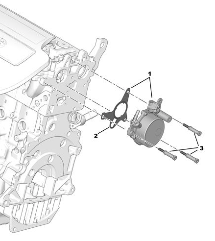

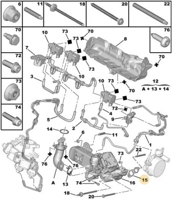

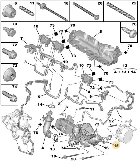

Here's the vacuum pump in the first pic - and again in relation to the EGR circuit

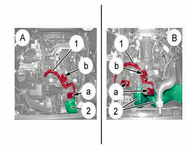

Removal / Refitting of Air Mixer: Peugeot 508 RHX DW10CTED4 with Hybrid Traction System.
Removal
Disconnect the ancillaries battery (BSI Reset / Battery Disconnect / Reconnect Procedure)
Remove the engine style cover.
A Single metering unit.
B Double mixer.
CAUTION: Protect the engine cooling radiator to prevent damage to the fins.
Unplug using a thin screwdriver:
  • The inlet air mixer sensors (at "a")
  • The inlet air pressure/temperature sensor (at "b")
Release and move aside the electrical harness (1).
Uncouple the air inlet union (2).

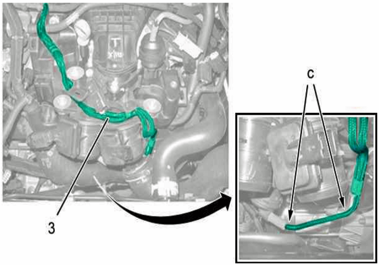

Uncouple the vacuum pipes (3) (at "c").
Unfasten and move aside the vacuum pipes (3).

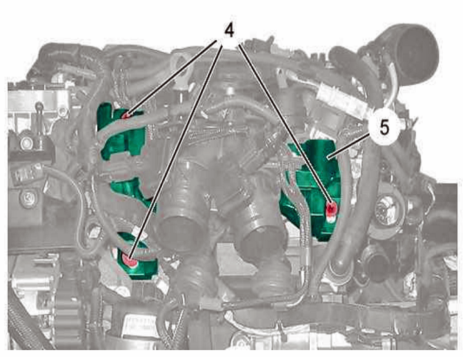

Slacken the mountings (4) sufficiently to allow lateral movement of the support (5).

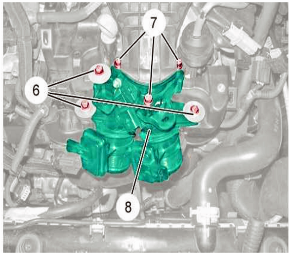

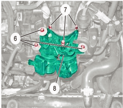

Remove:
  • The bolts (6)
  • The bolts (7)
  • The inlet air metering unit (8)
Refitting
Adhere to the Tightening Torques below:

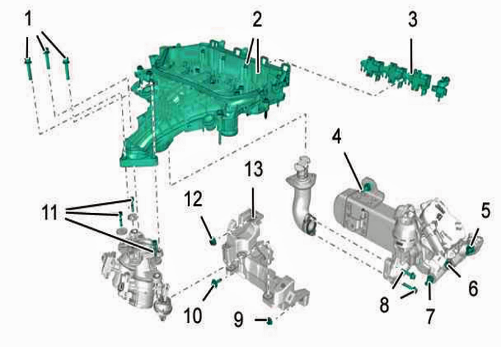

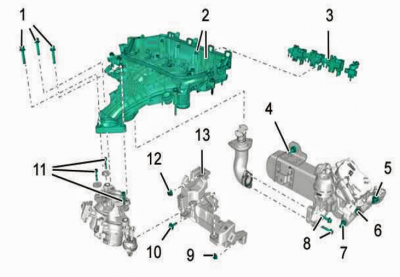

ReferenceDesignationTightening torque
(1)bolts (Inlet air metering unit )0,8 daNm
(2)bolts ( intake air distributor) (*) (**)1 daNm
(3)Fasteners (Piloting electrovalves )0,65 daNm
(4)nut (Exhaust gas recirculation heat exchanger )2 daNm
-Stud (Exhaust gas recirculation heat exchanger )0,6 daNm
(5)nut (Exhaust gas recycling valve)0,8 daNm
-Stud (Exhaust gas recycling valve)0,4 daNm
(6)bolts (Exhaust gas recycling valve)0,8 daNm
(7)Stud (Exhaust gas recycling valve)1 daNm
(8)bolts (Exhaust gas recycling duct)0,8 daNm
(9)nut (Inlet air metering unit support)0,8 daNm
(10)bolts (Inlet air metering unit support)2 daNm
(11)bolts (Inlet air metering unit )0,8 daNm
(12)nut (Inlet air metering unit support)2 daNm
(13)Stud (Inlet air metering unit support)0,6 daNm
(*) Follow the tightening sequence (**) Follow the tightening procedure

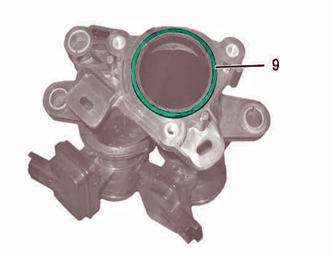

CAUTION: Check the condition of the seal (9); Exchange it if necessary.
Position:
  • The seal (9) on the inlet air mixer unit (8)
Tightening procedure: Assembly of inlet air mixer control unit (8) and its mounting (5):
  • Tighten the mountings (4) by hand; The support (5) must be properly seated, allowing lateral movement
  • Tighten the bolts (7) to torque
  • Tighten the bolts (6) to torque
  • Tighten the mountings (4) to the specified torque
