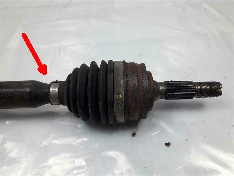

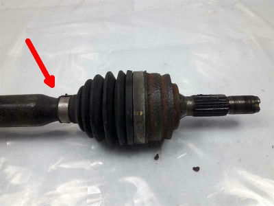

How do the old and the new compare when side by side, can you see a difference?
Maybe just the gaiter is wrong.

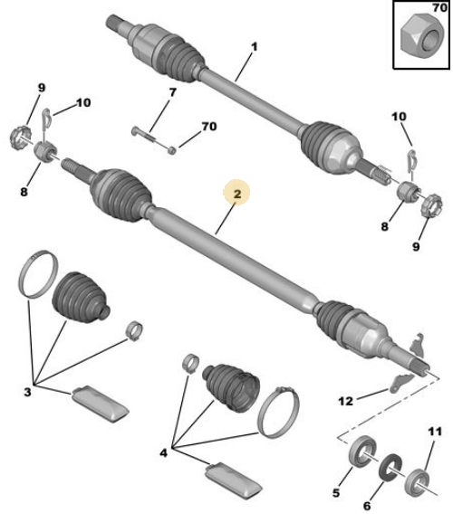

Re: Help! Changed driveshaft and CV boot rubbing on anti roll
There seem to be quite a few wrongly labelled driveshafts out there, but it would seem that you need the one that narrows towards the CV joint as per the picture. That narrowing allows the ARB to not foul the shaft.
- x 6946
Yes, Item 2 in the diagram shows the narrowing clearly as compared to the left hand one (item 1), so one assumes that mist have a different ARB layout so is not required.
