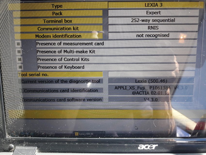

Managed to get the software to get so far on the Lexia side as to identify the interface, without taking it to bits. If I'm reading the info right it seems to say that I have Actia 02.01.12 so maybe it is just to old to work.......?

Finally got to the bottom of this issue - with a big thanks to David Hallwoth for realising what was wrong and sorting it out. We discovered that his Actia box is even older than mine and worked fine with a later version of Diiagbox than I have installed . So my box was tried with his laptop and Diagbox software - and it worked. When my software was inspected David discovered that it was set by default on trying to update the firmware on start up. This probably explains why I got one 'session' using it initially and then it refusing to communicate with the car any more. Altogether this happened with three installations of Diagbox on 2 different laptops.
The cure is to enter the AWRoot file and is explained in an old post here - https://www.frenchcarforum.co.uk/forum/ ... ot#p584251
I now have a working Diagbox system..........bloody marvelous.
