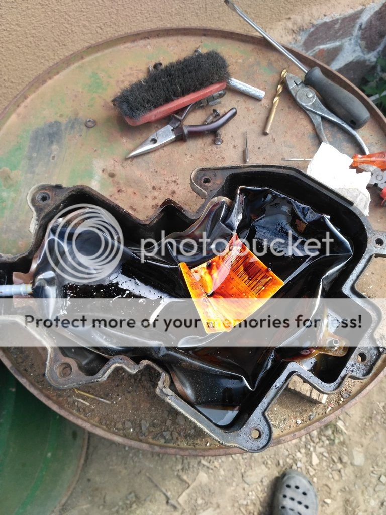

Considering that i cover no more than 15000km per year on that car i decided to get my hands dirty ( wearing gloves all time because of the cerine).

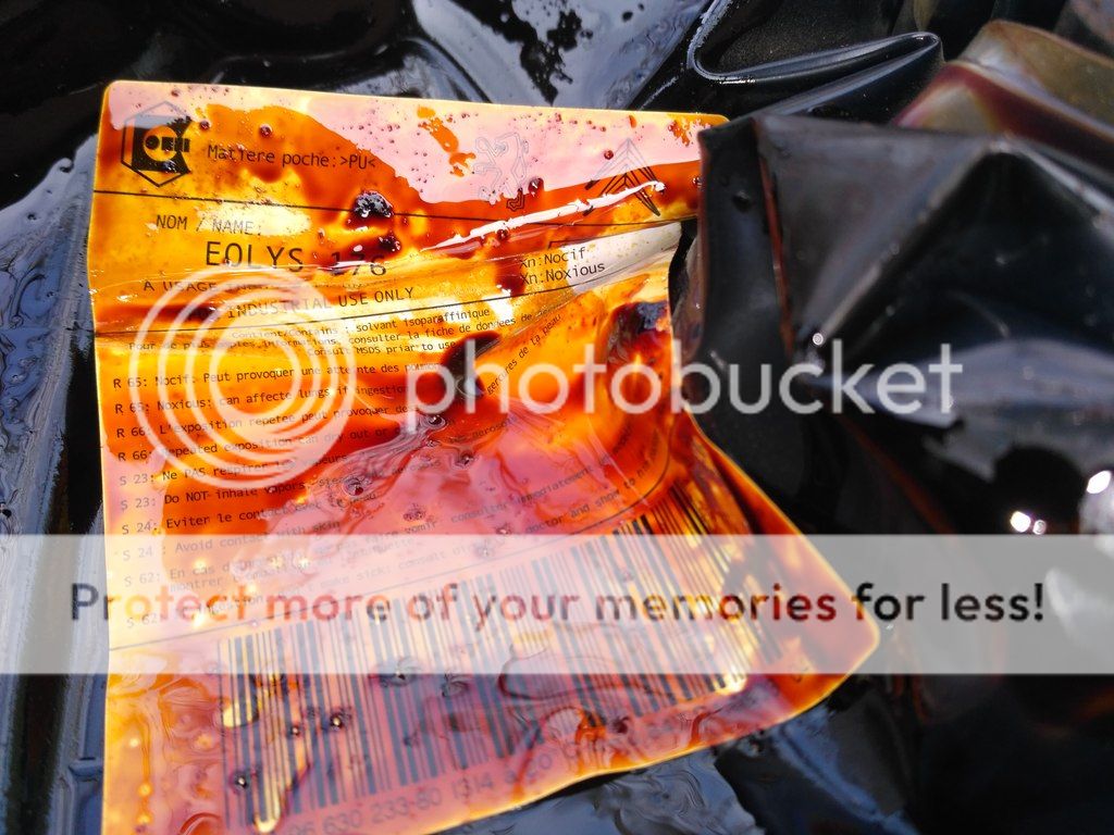

Removed the box and drilled the rusty screws to find this:

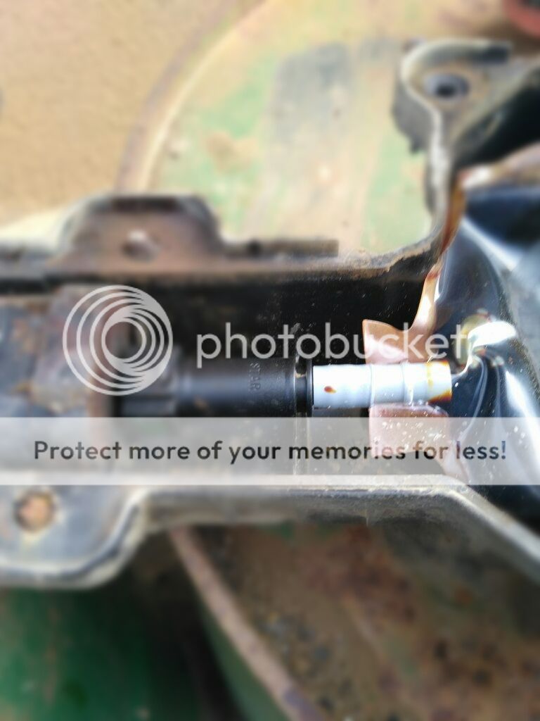

Leaking on back side of this connector - tiny crack

What a mess!
I’m glad I have the rigid tank instead of the pouch system!

I took special silicone and applied over the weak spot and around it.Left it dry for 2 days.
Because of the way it is designed - the pump sucks out the liqud not from the bottom but from the side -so there must be no air inside the bag.
From my partner i found suitable connector to fit the one of the bag and using house and suction pump for priming diesel (5€ from local store) easaly managed to take out the air from the bag.
Leave it like this for several days to see if any leaks will happen and after installed it back on car.

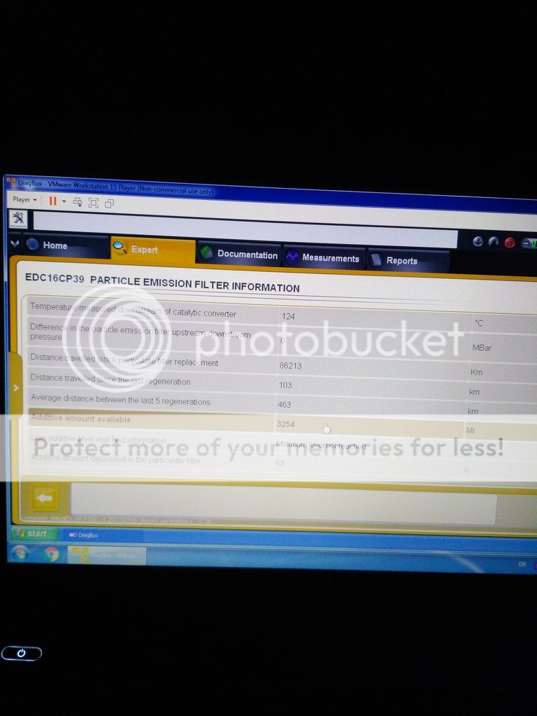

Just cheked again with diagbox and....
3254ml.!
I put 10 more litres - listen and didnt hear any noise/vibration immediately after start engine - probably the liquid is delivered at later moment.
x 6963
Re: ecu wont add eolys to fuel!
Yes, it only injects additive once the car is travelling over 20 KMs per hour
