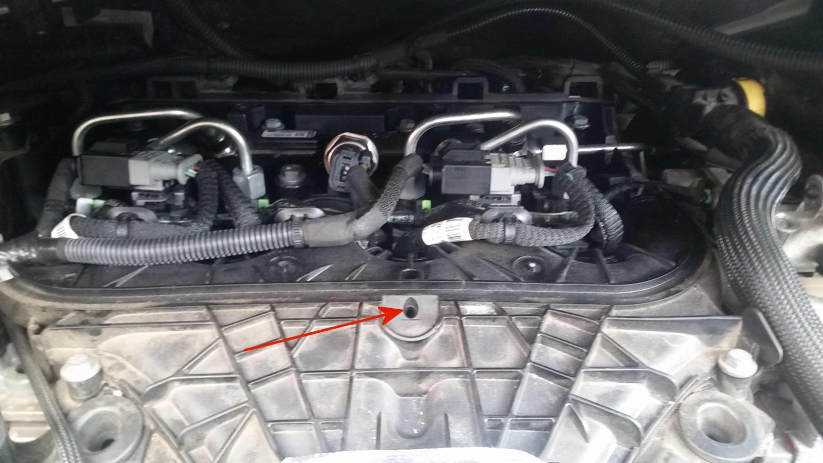

Had another look in the engine bay and there was some signs of smoke. So took off the rubber injector cover, and there is smoke coming out of one of the cover mounting holes. Putting my finger over the hole, I can feel pulses pushing air/smoke out. I have no idea why anything should be coming out of this hole

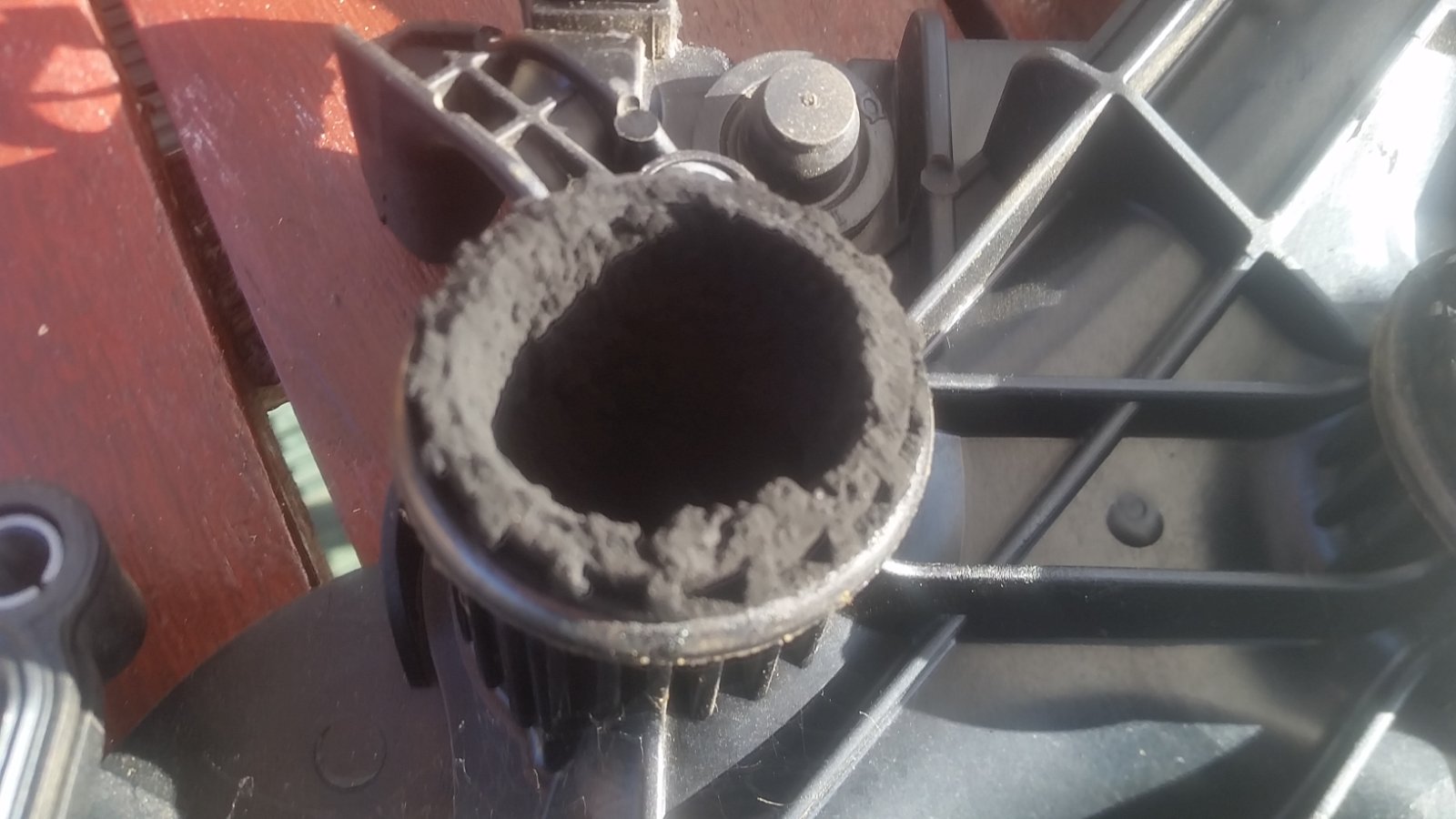

It appeared that the garage had managed to tighten down the injector bolt cover too tightly and cracked the manifold. So I was seeing exhaust pulses from the EGR.
So the manifold was replaced with one from a Ford Kuga with 50k on the clock, showing a light black film
By way of contrast this is a pic of the old manifold.

I wouldn’t be taking it back to that garage again if they don’t know the correct torque settings!
jsoap
- Posts: 29
- Joined: 30 Apr 2019, 15:25
- x 1
Re: Soot on rear doors Expert 2.0 HDi (DW10CD)
I know, it's not as if they need to be more than finger tight. But that's the way it happened and at least he felt guilty enough to only charge £150 for fitting the supplied parts.
- x 6945
Fair play!
