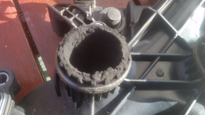

It appeared that the garage had managed to tighten down the injector bolt cover too tightly and cracked the manifold. So I was seeing exhaust pulses from the EGR.
So the manifold was replaced with one from a Ford Kuga with 50k on the clock, showing a light black film
By way of contrast this is a pic of the old manifold.
x 6954
