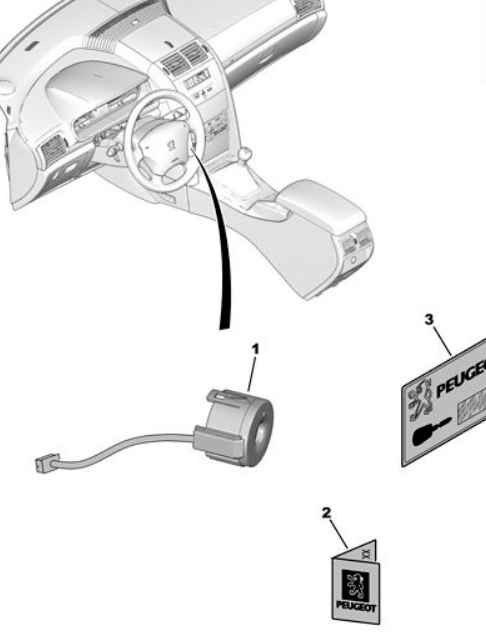

Just to confirm you have the correct remote battery: Remote battery CR1620 (3V)
If the system does not function correctly, the warning light comes on on the instrument panel display, accompanied by an audible signal and a message on the multifunction display. What does the message displayed read?
Ok just seen you last reply whilst I was posting this. If the ignition barrel is slightly loose it is possible that the transponder coil might be faulty.
Item 1 below:
The Part number is: 6160C0
However, you really need to connect up PP2000 and do some tests on whether the key is being recognised or not. I suspect the remote is fine but the transponder coil may be the culprit or the wiring surrounding it.
Item 1 below:

Re: 2006 407 coupe programming issue ? FOB
Yes it has a sony CR1620 3v inside of it.
Is the transponder coil not inside the hard plastic part surrounding the barrel ? That part is firmly in place.
I just had a locksmith calling me, i told him i think that the BSI had kicked out my key and he told me i just need to bring the BSI to him and he will re-add the key to the BSI. I have no idea what he will be using but i assume PP200 or lexia ?
But now, you say the key transponder or the ignition coil might be faulty.
Is there perhaps a how to on how to remove the ignition coil ?
If i somehow find a way to take off the ignition coil, can i send it along with the BSI to the locksmith or does everything need to be connected to the car ? It's a long drive to this guy... in the meantime i'm going to see if i can find anyone that could perhaps loan me their PP2000 hardware, likely i won't come right but it's worth a shot trying.
