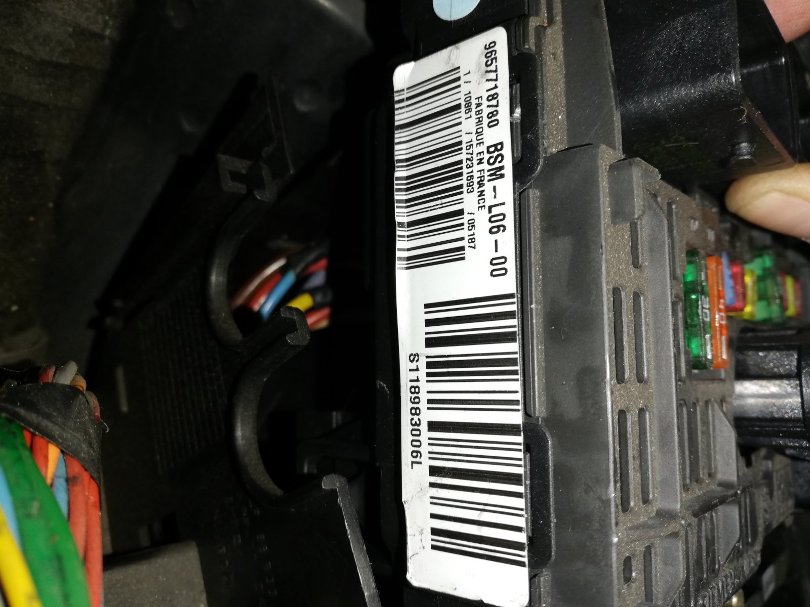

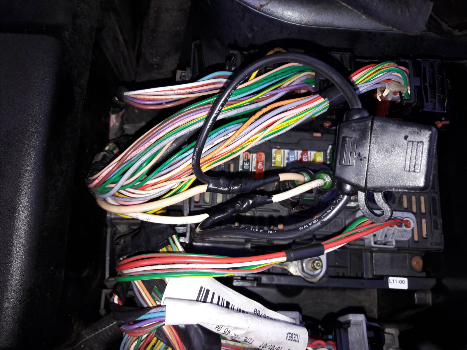

petef
- Posts: 193
- Joined: 23 Jul 2006, 20:46
- x 11
Re: C4 Heater/AC not working
The 'bridge' referred to is detailed in the post I originally started here https://www.frenchcarforum.co.uk/forum/ ... 4&start=30.
I am attaching a photo of the bridge wiring above the under bonnet fusebox - the BSM, which was done by a local auto electrician. Everything then worked fine, but eventually, I decided to replace the BSM itself. Basically I wasn't happy with the potential strain on the ignition switch - if the heater blower was on when the ignition was turned off it would come back on straight away when the ignition was turned on again, instead of kicking in when the BSM relay operated after the engine was started. All I had to do after installing the new BSM was remove the fuse from the bridge.
As Paul says, make sure you get the correct BSM, the original one on I got on ebay was nearly right - except you couldn't turn off the wipers.......
OnlinePaul-R
- Posts: 9364
- x 1938
Ah, that's not the same bridge as I was talking about although it's very interesting and possibly worth investigating.
The bridge I was talking about is across the plug that connects to the control unit.
snawheed
- Posts: 10
- Joined: 25 Feb 2019, 19:47
- x 1
Got car back from auto electrician, its the under bonnet fusebox
