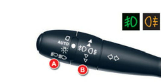

To clarify the fog lights again:
The fogs should only be able to be activated when the lighting position (A) is on the second (AUTO) position or on the fourth (DIPPED / MAIN) setting.
Note that the fogs will of course NOT work on the AUTO setting unless the car has actually switched on the headlights as in the case of it raining or being dark enough.
To activate the fogs when the headlights are on, the barrel (B) must be rotated forwards once to switch front fogs on; it will return to its position and then a second forward rotation of the barrel will switch the rear fogs on.
To then switch the fogs off, a downward rotation - once to turn off the rears, followed by a second downward turn to switch the front fogs off.
Of course, switching off the ignition, will of course turn the fog lamps off regardless, or if the lighting stalk is switched to the first (0) or second (sidelight) positions.

So something wrong with the switch, maybe?
0 and AUTO appear to be the same, making no difference whatsoever. High/low beam are on and all fogs are available in both positions, though the tail lights and number plate lights are off!
Side light position does as advertised, extinguishing the headlights, though not sure about fog lights.
The fourth position, HEADLIGHTS, brings the headlights back on, with the tail lights still working and fog lights available.

I was just about to suggest that the switch might be the problem...
Does Diagbox allow interrogation of the switch status?

There are a few fault codes related to the steering wheel control module Mike - and if there was a lighting stalk fault, it would bring up a 9C86 coherence fault.
I haven't tried any tests myself on Diagbox, but I know the buttons on my navigation system / head unit all have actuator tests. One for future testing I think next time I get a chance.
