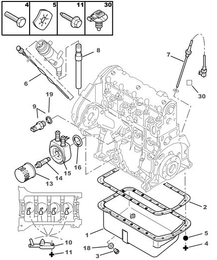

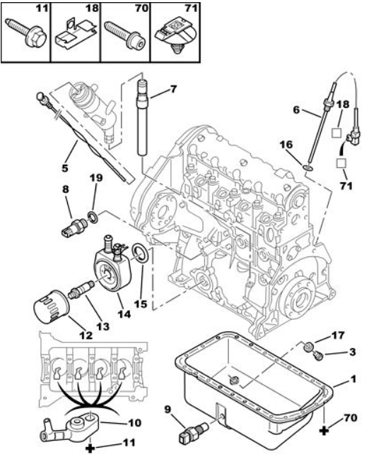

Re: XUD Dipstick Length
Looks like a completely different setup from the diagrams:
| Your Oil Gauge | Pre-Restyle Oil Gauge |

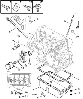

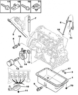

- x 6946
Hi Mac
The part you need is item (6), part number: 117415.
It should be 526 long for your vehicle. They cost £19.44 as of today direct from your Citroen dealer including UK VAT, so the equivalent in Spain most likely.
