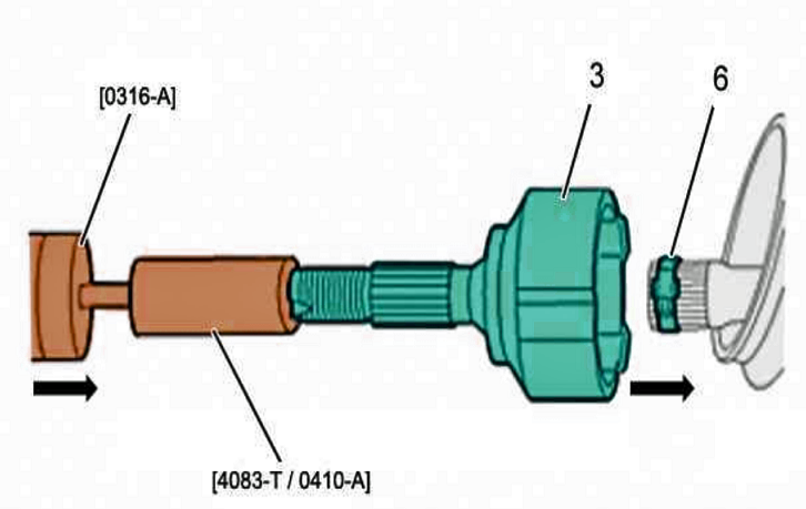

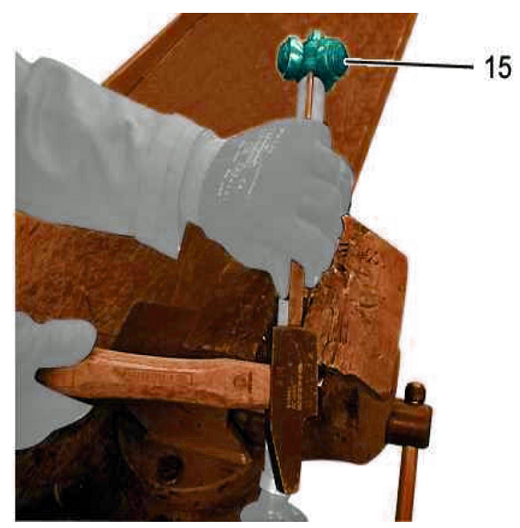

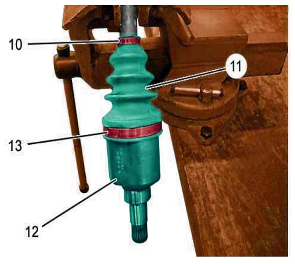

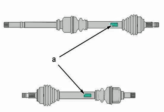

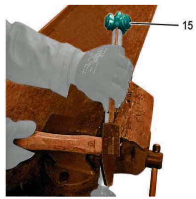

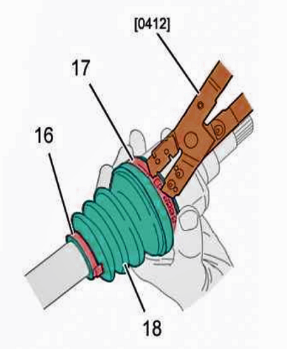

As Richard already pointed out there are several types of Driveshaft fitted to the X7, so the OP will need to identify the correct one from the original shaft label before proceeding with either of the methods below.
Note: Both methods included here, but only one will be relevant!

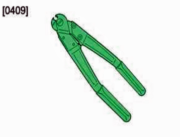

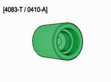

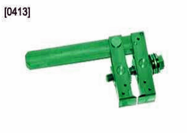

Official Tooling
Preliminary Operations
N.B.: The ABS crowns are discontinued (the function fulfilled by the crowns is transferred to the front wheel bearings).
Replacement: Wheel End Gaiter
CAUTION: Always replace the clips and circlips that have been removed.
PSA and NTN driveshafts
GKN Driveshaft
N.B.: The driveshaft bowl on the wheel side cannot be removed; The replacing of a wheel-end driveshaft gaiter necessitates the removal of the gearbox-end gaiter.

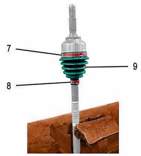

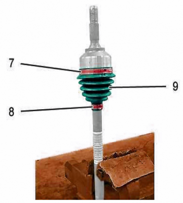

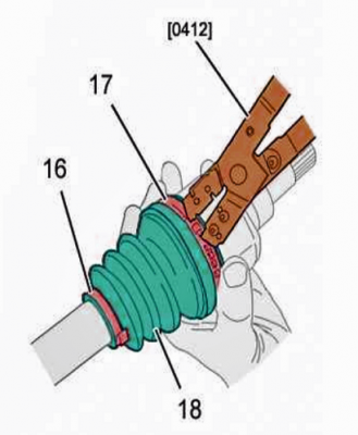

Replacement: Gearbox End Gaiter
GKN and NTN Driveshafts
PSA Driveshaft
N.B.: At the gearbox end, as the spider cannot be removed, replacement of the gaiter is only possible following removal of the seal at the wheel end.

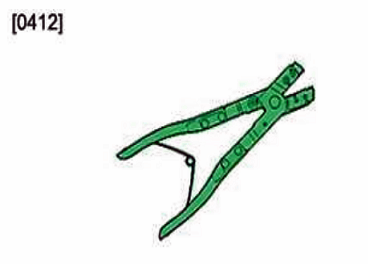

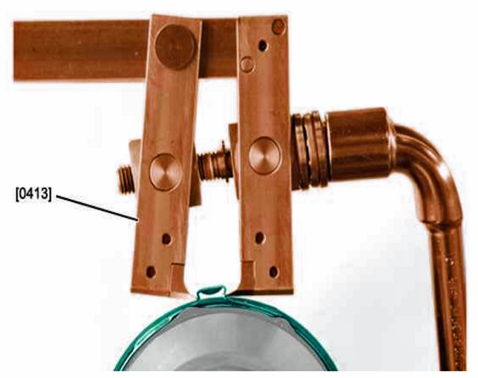

Clips
| The drive shafts are identified by a label stuck to the shaft (at "a") containing the supplier reference. List of suppliers: GKN PSA NTN |
Official Tooling
| Intentionally Blank |

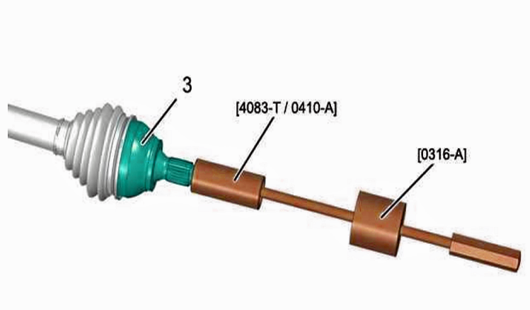

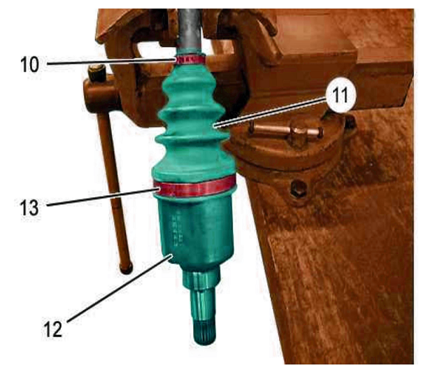

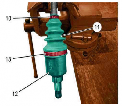

- Remove the drive shafts.
- Support the drive shaft in a vice fitted with soft jaws.

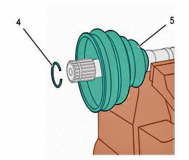

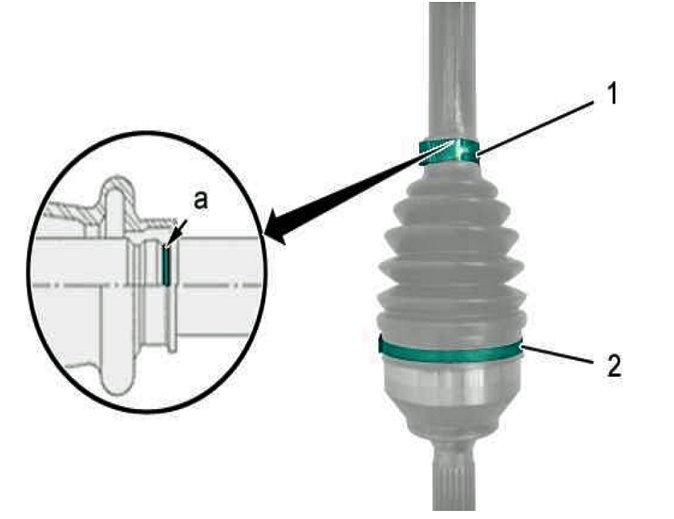

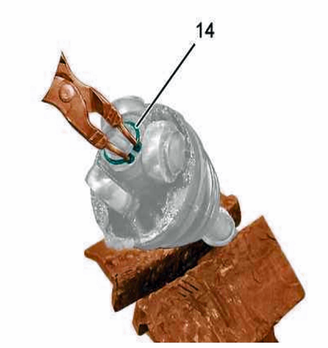

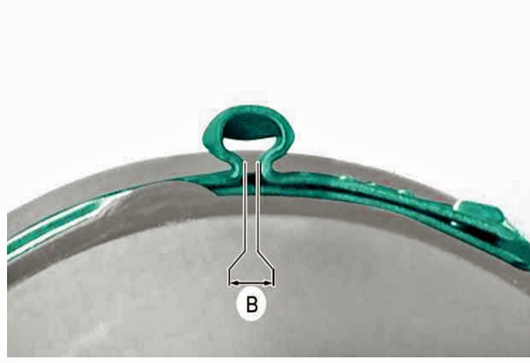

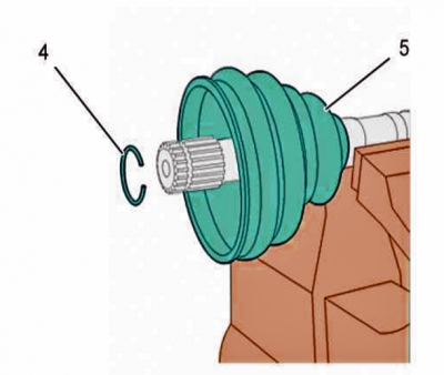

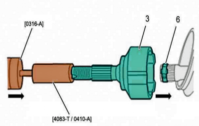

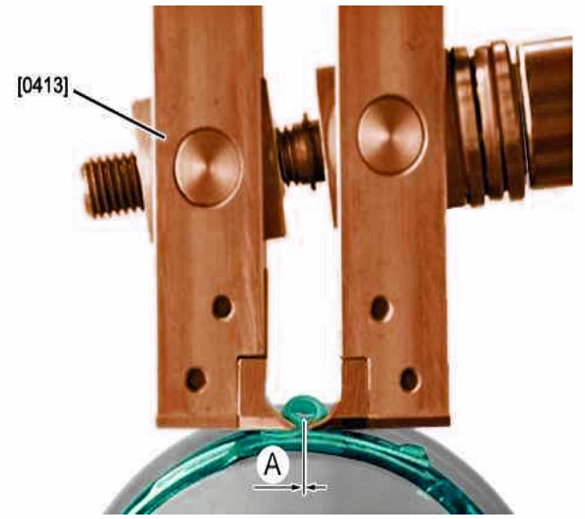

| (1) Remove the clips (1) and (2); Using a hacksaw. N.B.: Mark the gaiter position on driveshafts not having position grooves at "a". | (2) Remove the housing (3); Using the tools [0316-A], [4083-T / 0410-A]. |

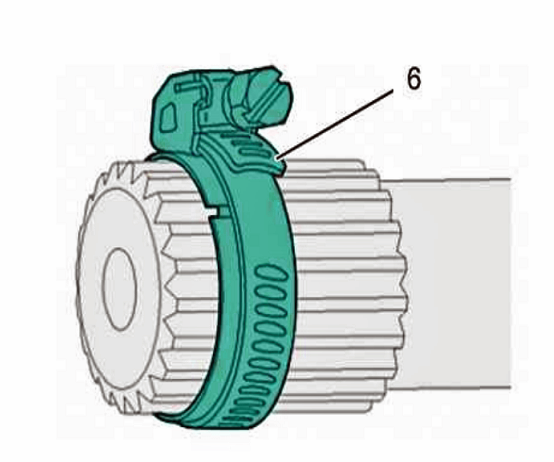

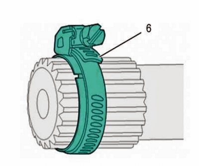

(3) Remove:
The drive shaft gaiter (5) (new) The stop ring (4) (new) | (4) Fit a clip (6) on the stop ring to facilitate force-fitting of the housing (3). |
(5)
GKN Driveshaft
(1) Remove:
Fill the gaiter with all the grease available in the repair kit. Refit:
(1)
| (2)
| (3) Remove the tripod (15); Using a hammer and a pin punch. Remove the driveshaft gaiter (11). Refit the driveshaft gaiter (11) on the driveshaft (new). Refit:
Refit:
(1) Remove:
Clips
| Position the driveshaft gaiter (18) (Observe the marks made during the dismantling operation). Refit the new clips (16) and (17) ; Using the special tool (According to the clips):
| Tighten the wing clips; Using the tools [0413] or [0409]. |
| Tighten the clips : Until there is contact "A" = 0 mm. | After tightening: Check the space "B" = 0,5 to 1 mm. Refit the drive shafts. |

Thank you for these informative pictures, you've been of tremendous help. We tried joint puller but sadly, it did not work which seems to suggest that it is in fact a GKN shaft. The headache continues as the next step is to buy stretchy gaiters and put them on from the outer shaft side.
I'm not sure how good of an idea that is but I guess we'll see

I've seen that tip for using a hose clip as a sort of ring compressor, to hold the c-clip in the groove while refitting the joint, but I can never find one that's correctly shaped, as in the pictures. Mine always have a big lump to hold the worm screw and won't be pushed along the shaft squarely, like the nice parallel sided one in the pic. I've always managed to get them in without it, with a bit of coaxing. Brute force is not the answer and will invariably damage, maybe even destroy, the c-clip.
In answer to Homer's question, I can't recall when the one-piece drives were in common use, but I would have been not long out of school and the cars we found them on would have been out of warranty, in the second half of the 1980s, so I suspect they may have been manufactured in the early 1980's, or late 1970s. Pretty sure they were French, though could be wrong.
They were an absolute pig to change boots on, using the plastic cone to stretch the boot and the task was left to me, with my expendable novice hands. Unlike modern, symmetric shafts, the off side one was longer and had a fat, hollow section which precluded fitting the outer boot over the slightly smaller inner joint. This problem no longer exists, as nowadays the cvs are equidistant from the wheels and the shafts are narrow, solid and, mostly parallel sided affairs.
Schavlik, if I were you, I would be dismantling the inner end and sliding the boot along the shaft. Now that I've seen the pictures and know exactly what I'm talking about, I can tell you it really is not difficult. If your existing inner boots are still in GOOD condition, then with care you can reuse them. All that stands in your way is a single, male circlip, which you can easily undo with incorrect tools, if you don't have a circlip pliers.
I'm a little surprised they show a hammer and punch being used to remove the tripod. I cannot recall ever having to do that, but maybe tolerances are tight enough nowadays to make this necessary. In my experience I was always able to slide them off the splines by hand, with the occasional fiddle to get over the circlip groove. I'd definitely much rather do that than try to get a stretchy boot on without the pneumatic stretcher!
having said that, it CAN be done with a cone made from plastic bottles, if you're determined enough
