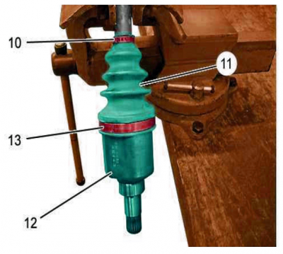

- Remove the drive shafts.
- Support the drive shaft in a vice fitted with soft jaws.

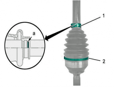

Replacement: Wheel End Gaiter
CAUTION: Always replace the clips and circlips that have been removed.
PSA and NTN driveshafts
| (1) Remove the clips (1) and (2); Using a hacksaw. N.B.: Mark the gaiter position on driveshafts not having position grooves at "a". | (2) Remove the housing (3); Using the tools [0316-A], [4083-T / 0410-A]. |
(3) Remove:
The drive shaft gaiter (5) (new) The stop ring (4) (new) | (4) Fit a clip (6) on the stop ring to facilitate force-fitting of the housing (3). |
(5)
GKN Driveshaft
N.B.: The driveshaft bowl on the wheel side cannot be removed; The replacing of a wheel-end driveshaft gaiter necessitates the removal of the gearbox-end gaiter.
(1) Remove:
Fill the gaiter with all the grease available in the repair kit. Refit:
GKN and NTN Driveshafts
(1)
| (2)
| (3) Remove the tripod (15); Using a hammer and a pin punch. Remove the driveshaft gaiter (11). Refit the driveshaft gaiter (11) on the driveshaft (new). Refit:
Refit:
N.B.: At the gearbox end, as the spider cannot be removed, replacement of the gaiter is only possible following removal of the seal at the wheel end.
(1) Remove:
Clips
| Position the driveshaft gaiter (18) (Observe the marks made during the dismantling operation). Refit the new clips (16) and (17) ; Using the special tool (According to the clips):
| Tighten the wing clips; Using the tools [0413] or [0409]. |
| Tighten the clips : Until there is contact "A" = 0 mm. | After tightening: Check the space "B" = 0,5 to 1 mm. Refit the drive shafts. |
