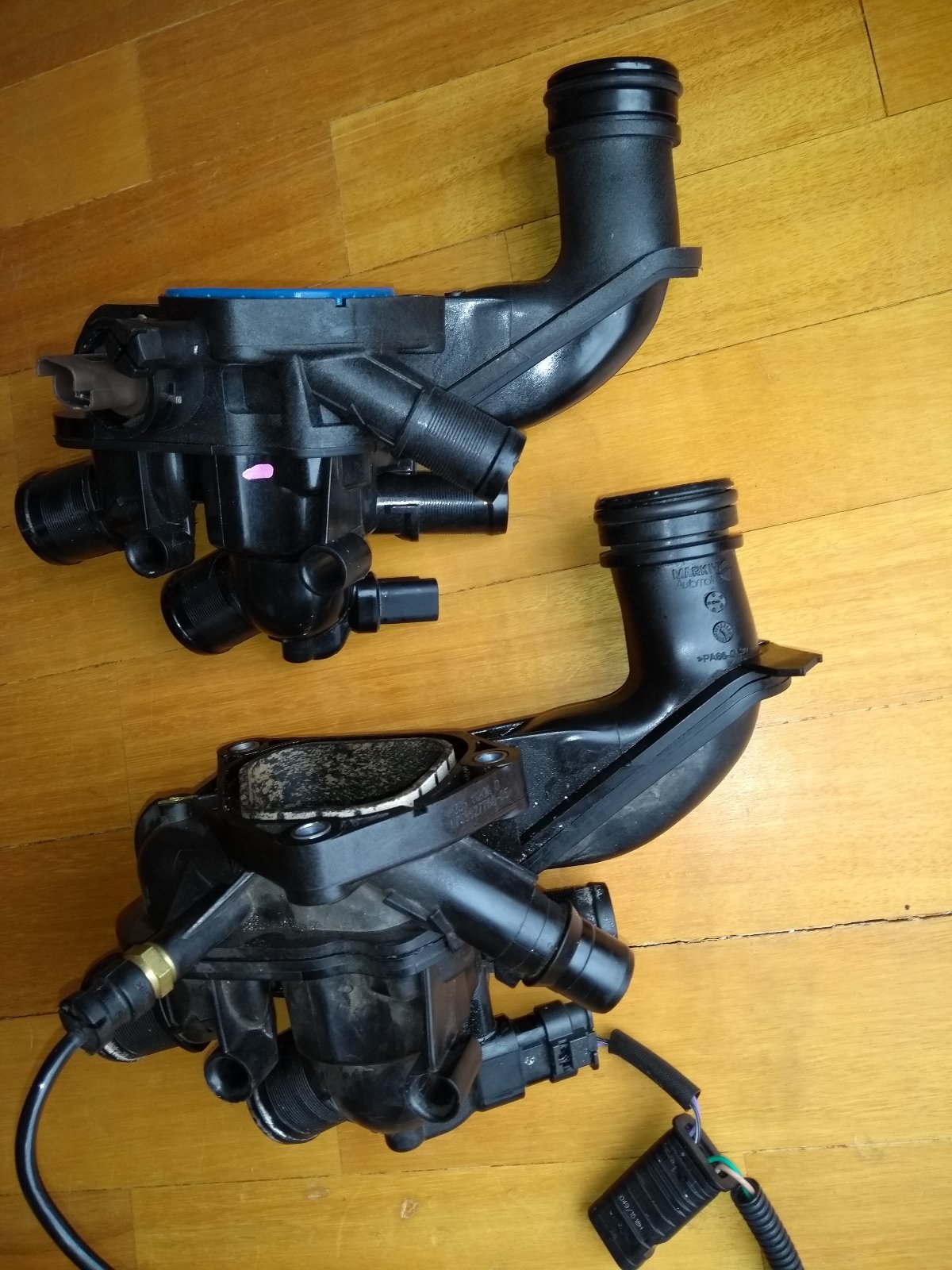

Cutac wrote: 06 Dec 2018, 18:31 I have it already.
I've got this and now I need this '98 043 153 80'.
Interesting, that is yet another variant to the 5 I knew of. Is that a genuine Citroen part or after-market?
Just check that your top heater hose has the clip-on fitting required by that thermostat, not the clamp fitting that some have. The diagram in the parts listing above shows a thermostat with a clamp fitting, not a clip fitting.
It also shows the temperature sensor in the other (horizontal) position, but that is not so important. There are actually 4 different positions for the temperature sensor on these stats, integral in the end of the housing, screw-in vertical through the bleed orifice, vertical clip-in in front of the bleed orifice, and horizontal clip-in from the front.

That's an aftermarket, one made by Facet.

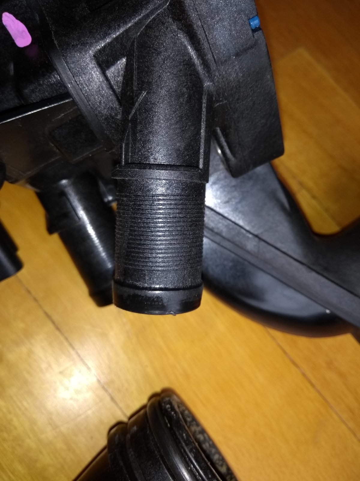

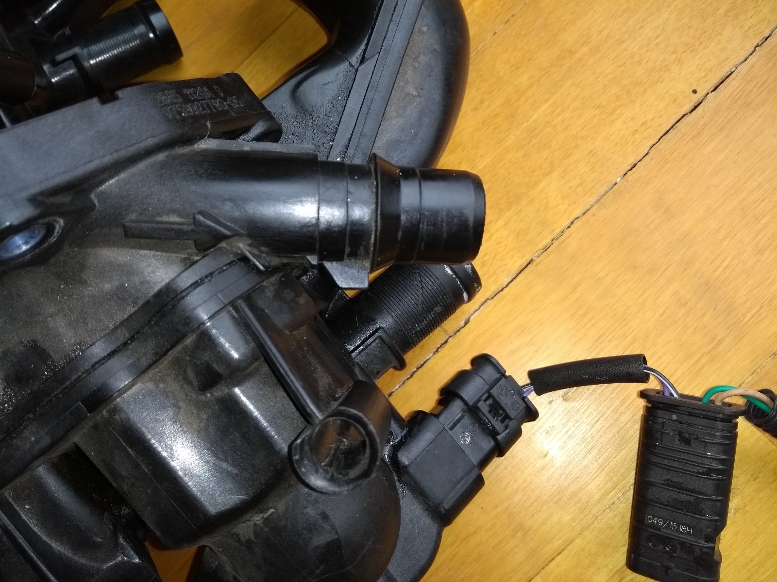

What's the difference between a clamp and a clip? If the fitting is different, I can always add a clamp with a screw.

Here are some pictures of the 2 types of fitting:
xantia_v6 wrote: 11 Jan 2018, 04:01 IMG_20180111_170407727.jpg

Ahh, I get it :)
But both can be taken care of using a good clamp :mrgreen:
