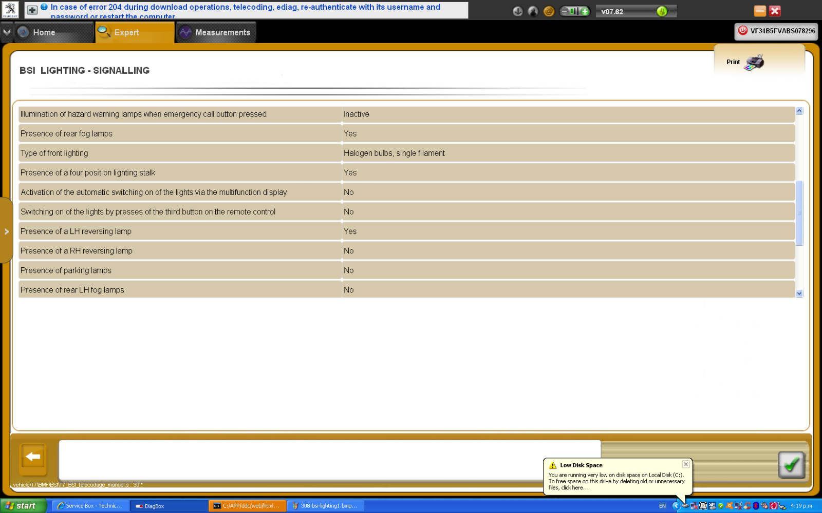

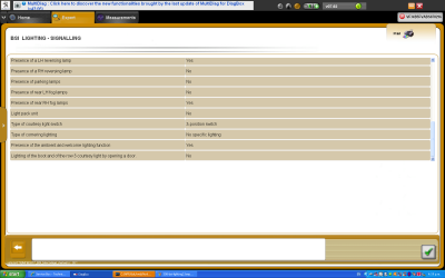

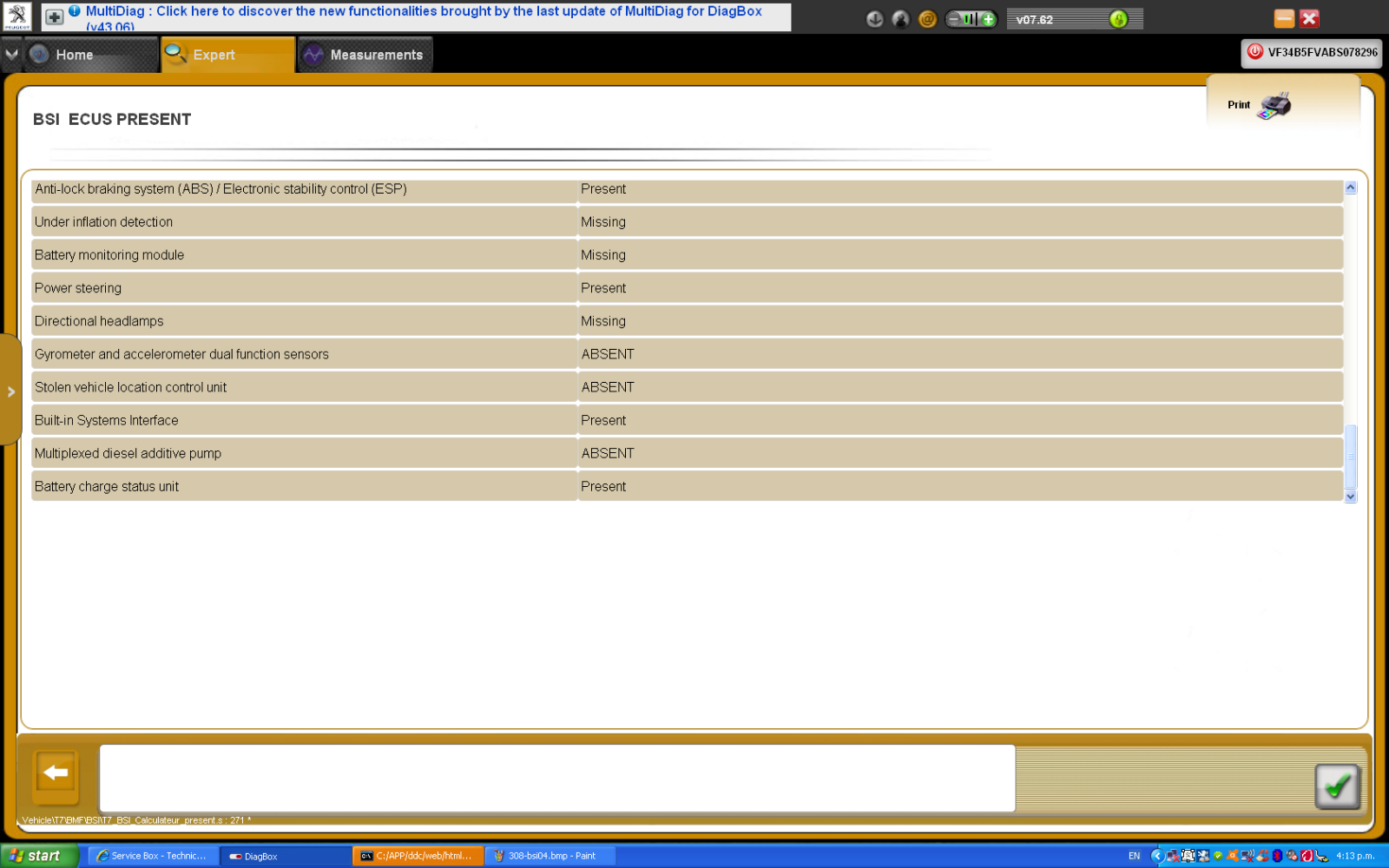

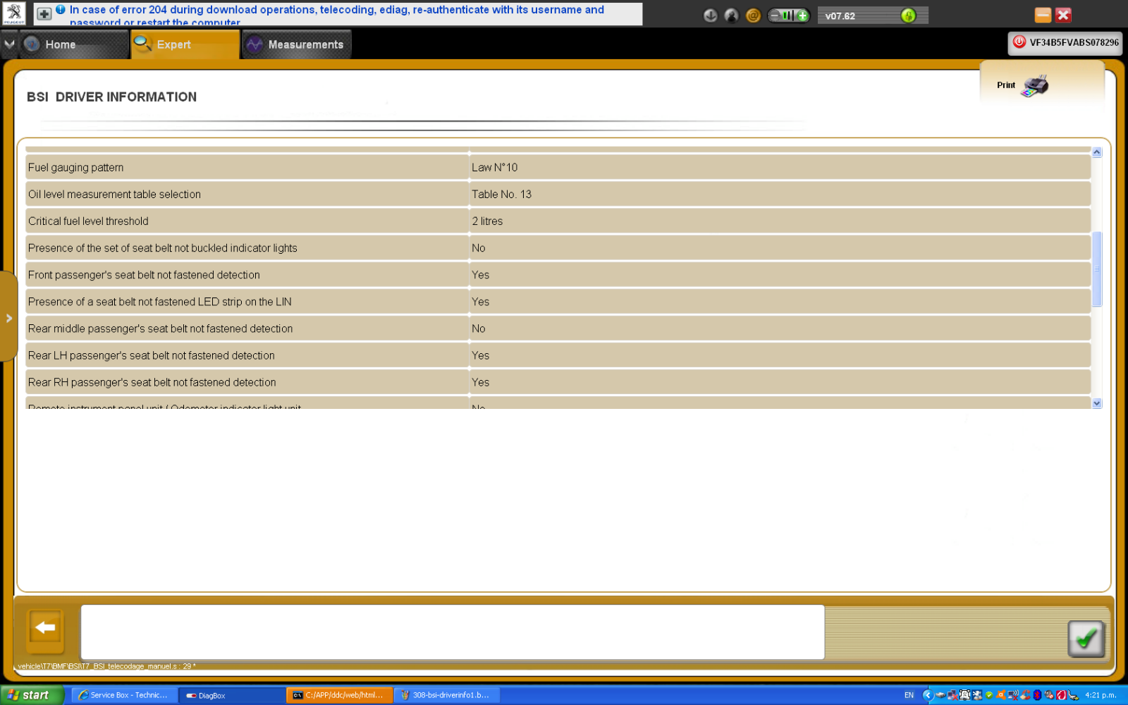

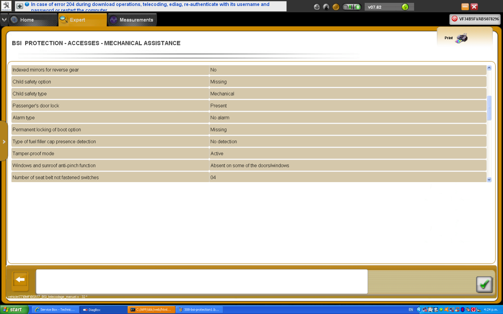

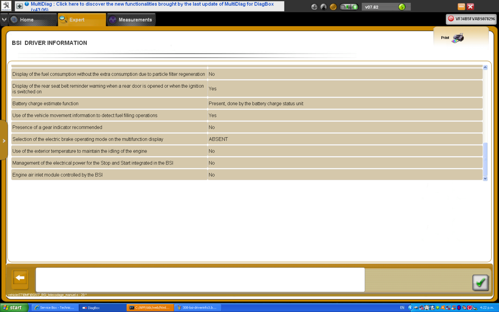

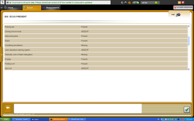

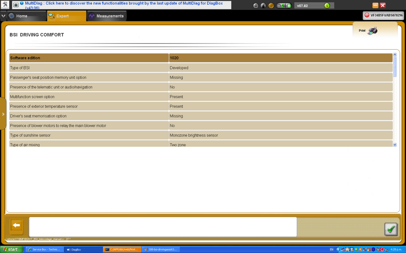

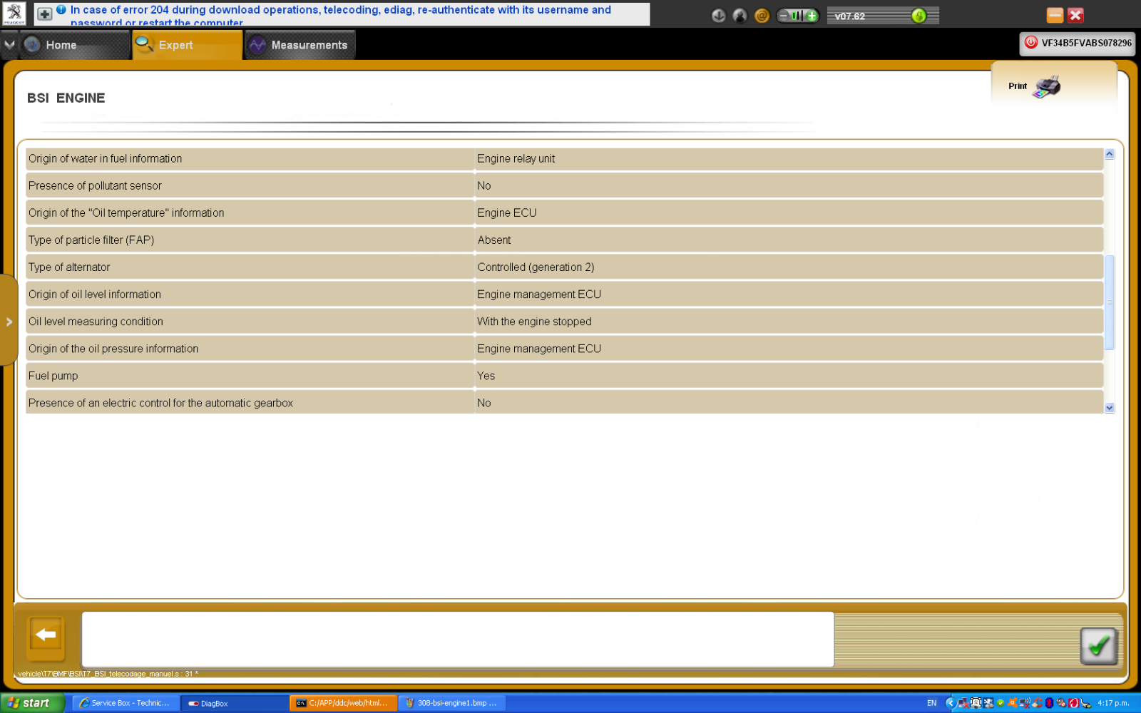

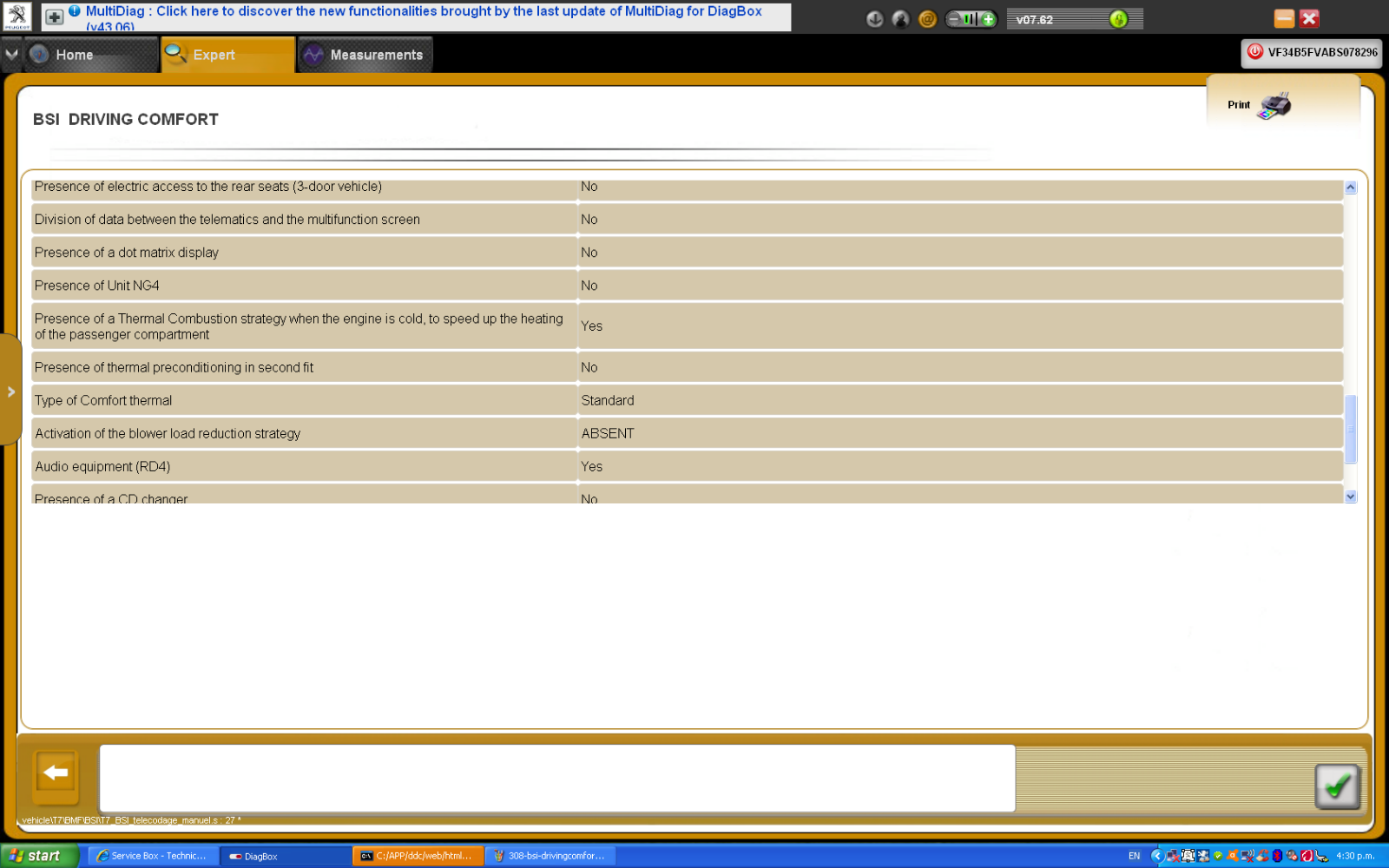

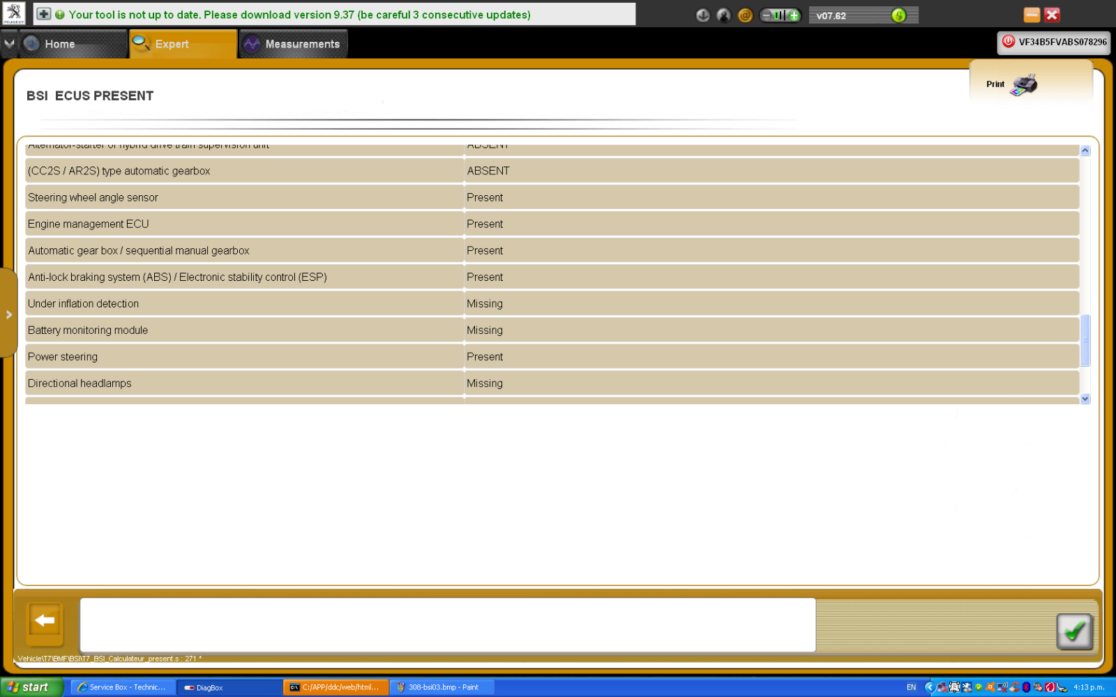

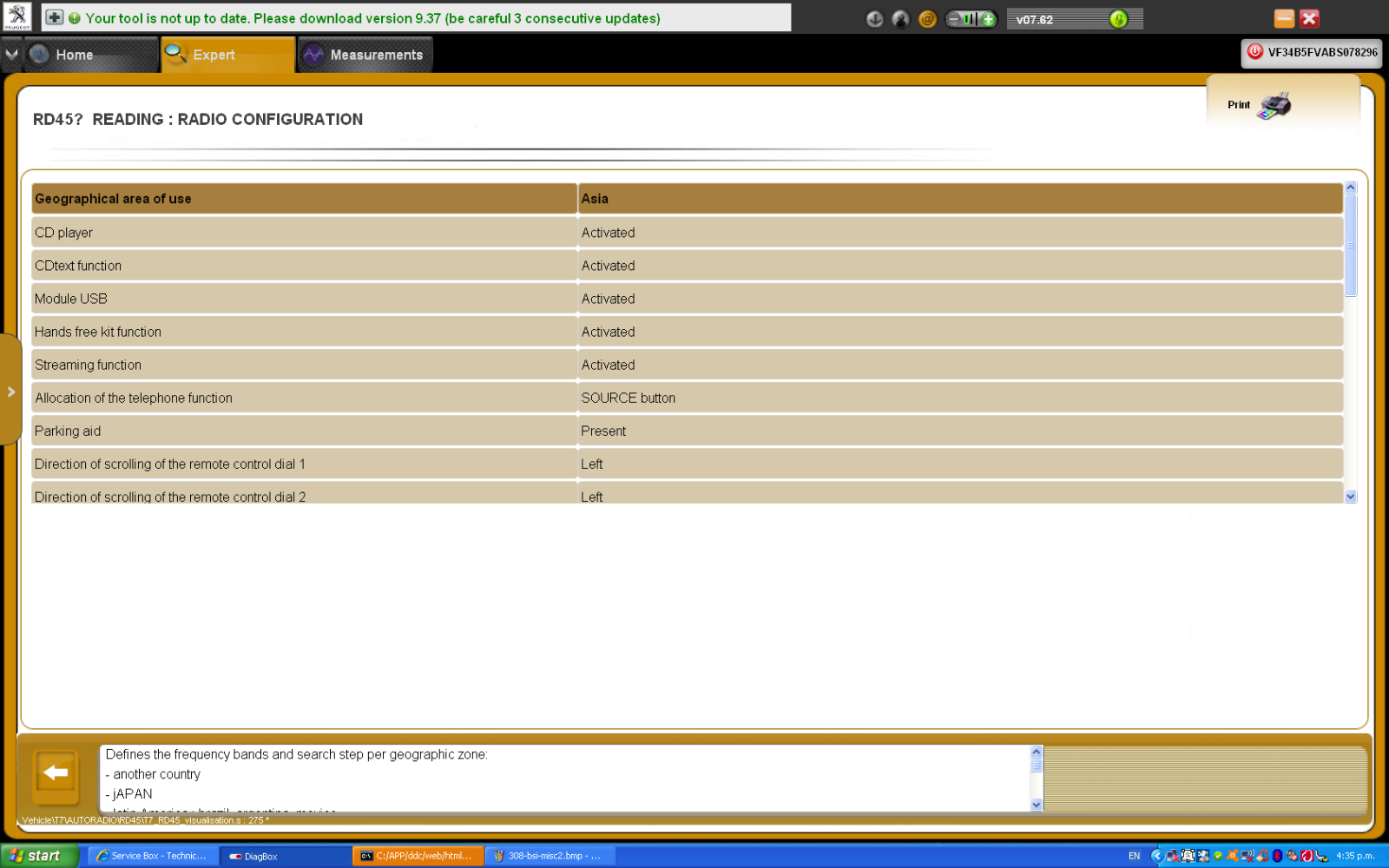

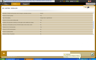

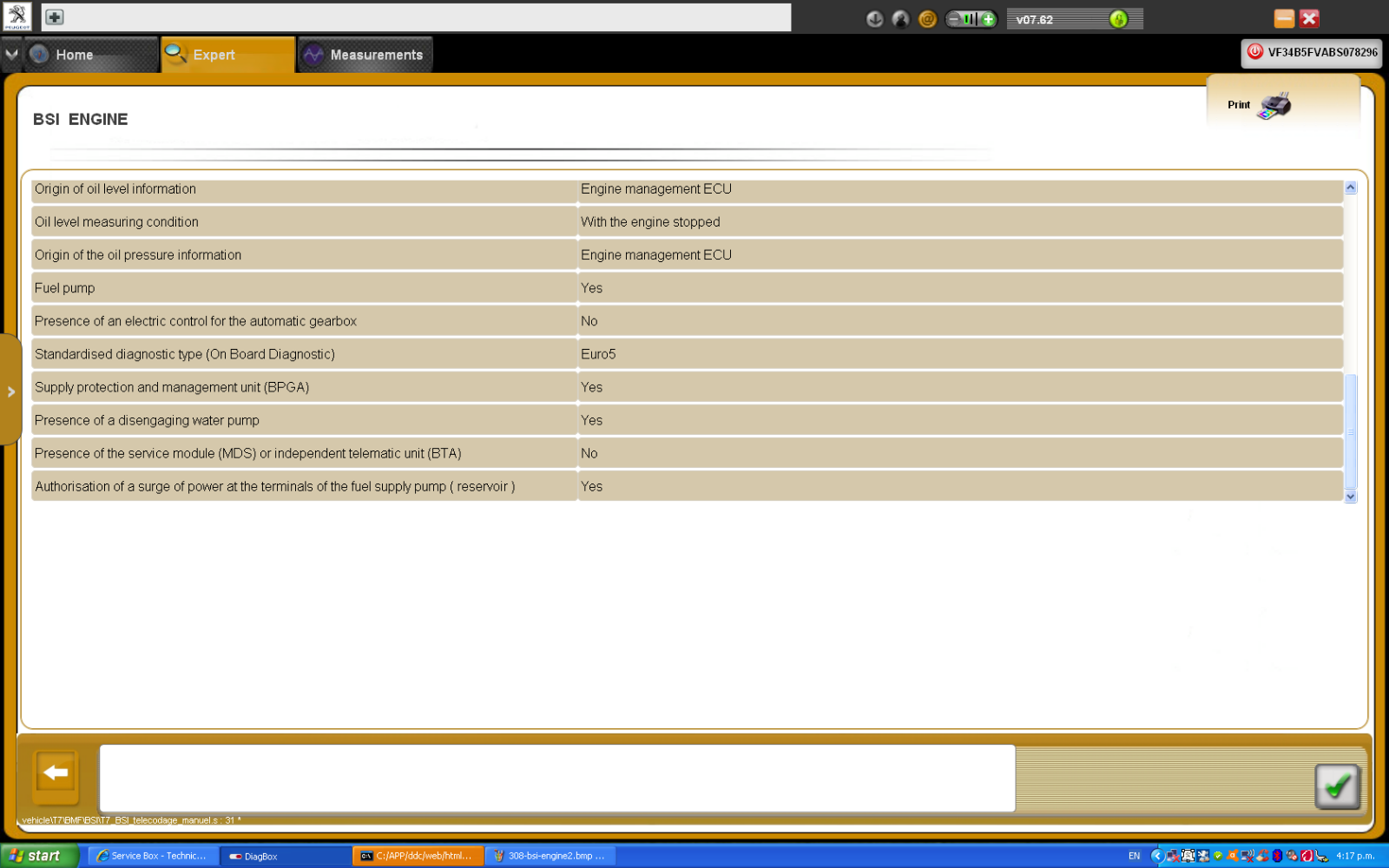

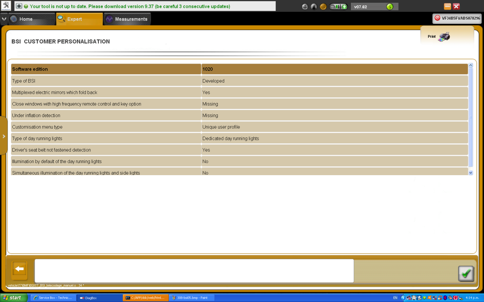

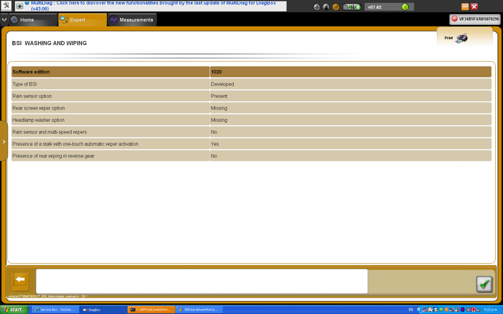

For info, here are the screenshots of the bsi and rd45 configuration from my car

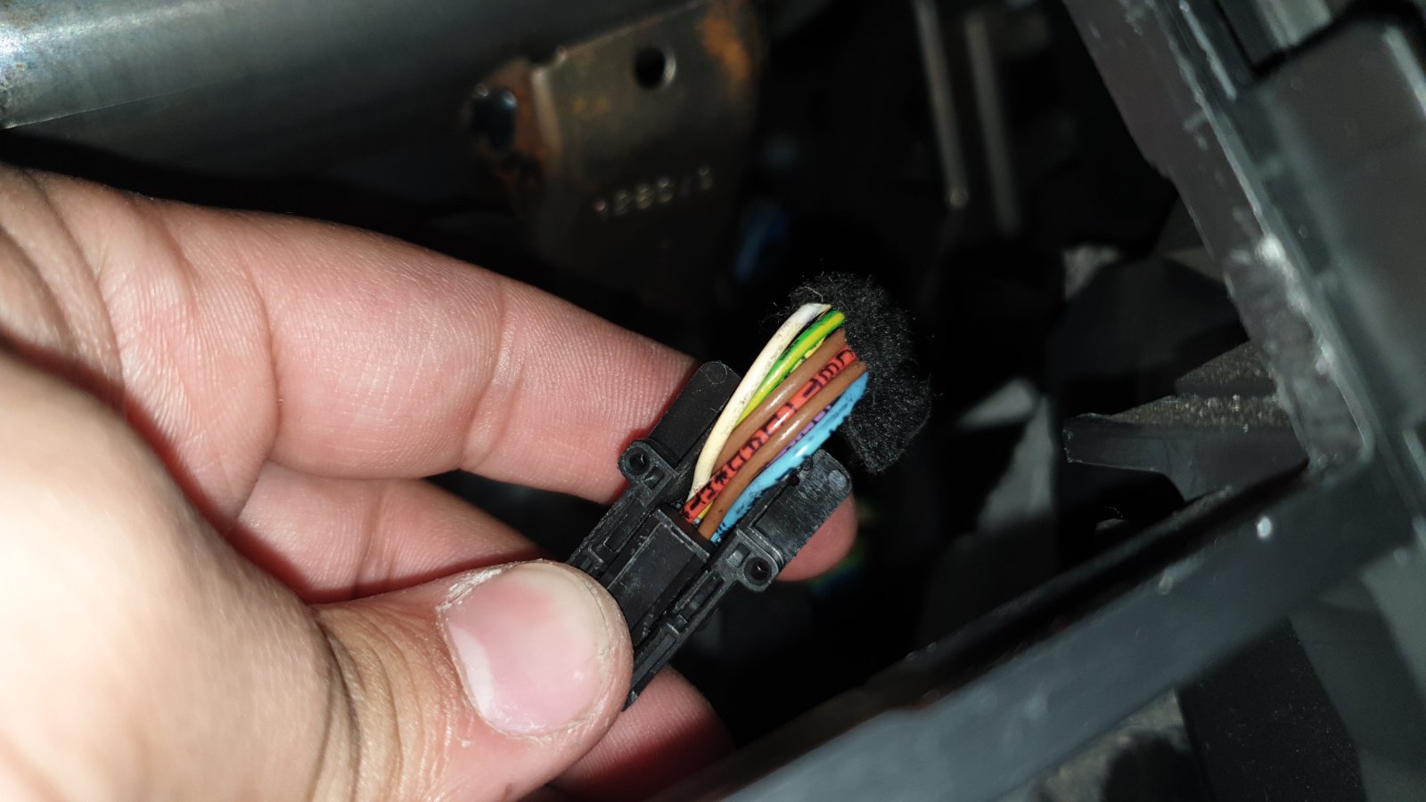

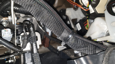

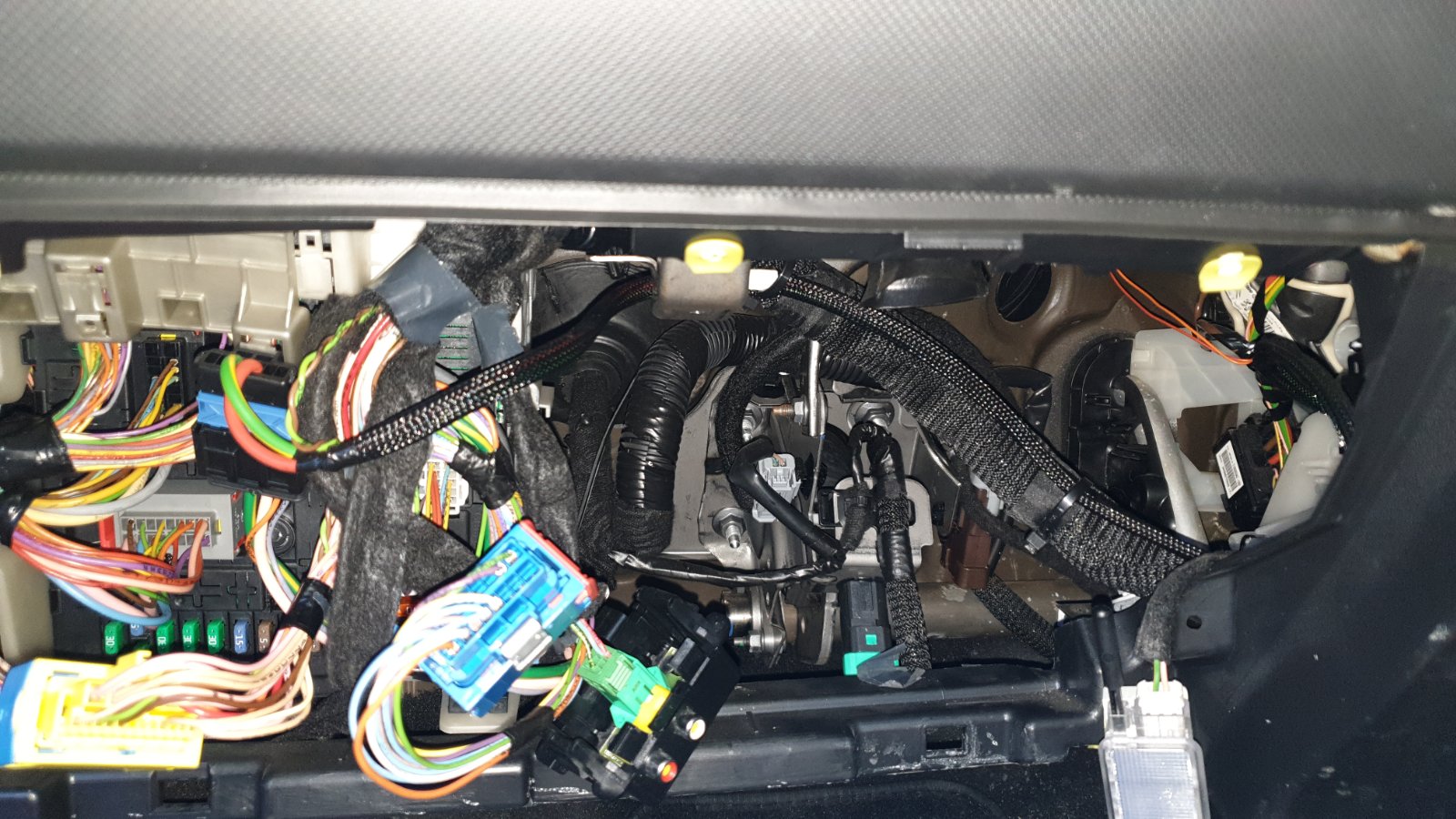

Ok. Found the plug with 20 pins. Took the multimeter and checked the wire continuity from roof to that plug. And yes that's the plug. Pin 18 and 17 is the same as pin 1 and 3 from the roof plug. But the question is , where those wires goes ? Is a brown and green wire on pin 17 and 18.
EDIT: I removed the glovebox so i can trace the cables better. I found that from pin 17 and 18 the wires are going in a big loom of wires which goes behind the a/c controls and from same loom exits another 2 looms. 1 is going to hazzard lights , esp and lock/unlock doors and another one it goes to cd player. Then i followed more and i found a spare connector same type as the one that goes in hazzard lights controls but it seems that are other cables not the one from the mic.
I saw on previous page a wiring diagram but i think that is from cars fitted with rd45 because from the 20 pin connector underneath the glovebox it goes straight to part B in RD45. But for cars fitted with RD4 i understand the mic cables might go into an aditional bluetooth box but i couldn't find any diagram where that box should be mounted maybe i can find a spare connector somewhere there.
Thank you
Thank you

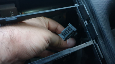

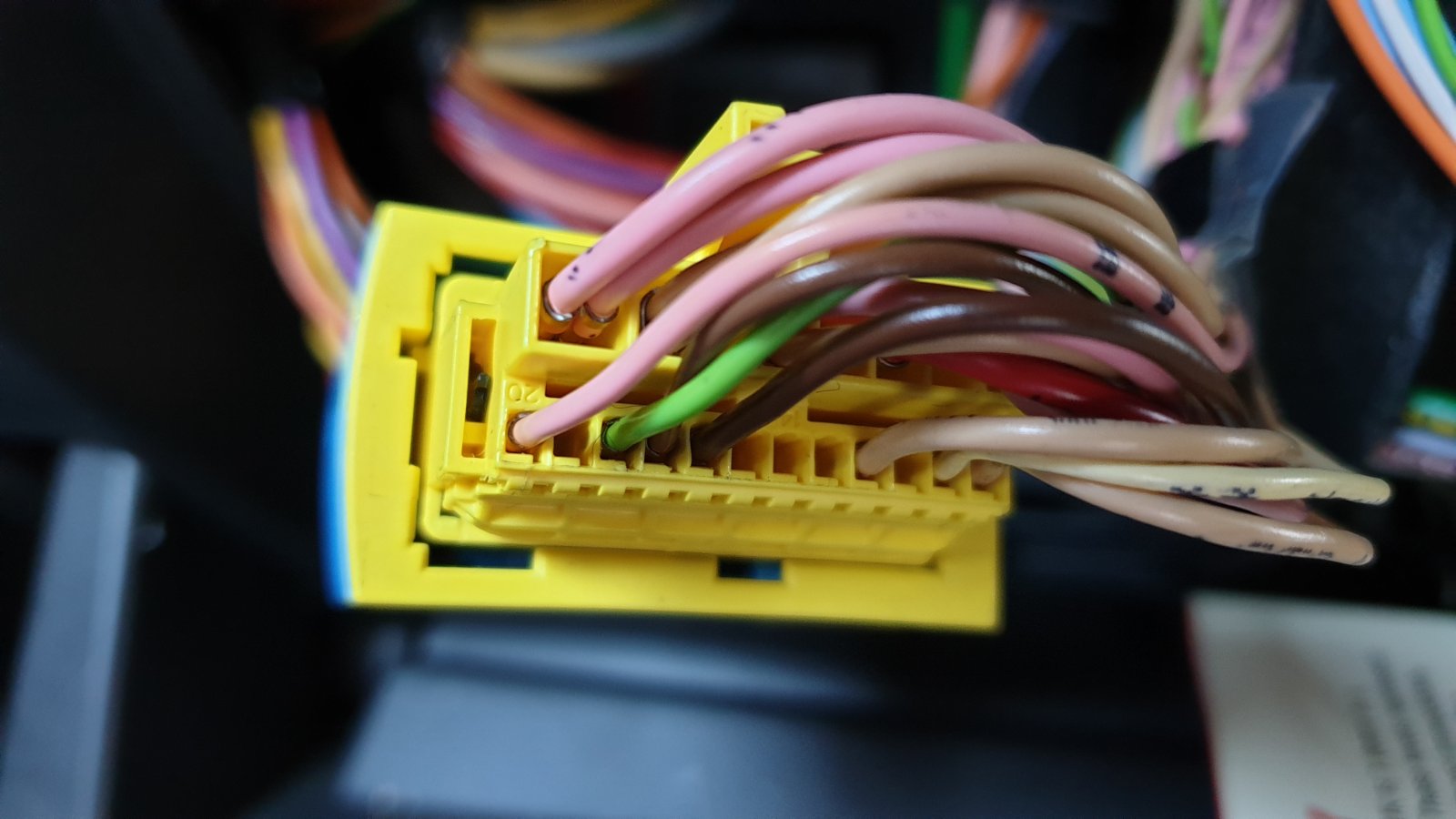

I took an old pc , and i took the cable from power on L.E.D that is mounted on the motherboard. That cable has a 2 pin black connector so i used that connector to plug it in straight into the radio on pin 3 and 9. To plug this i had to remove the white plug with aux cables , so no more aux1 , but anyway wasn't working with the new rd45. Then i tapped into the wires coming out from pin 17 and 18 and voila ! Microphone working , crystal clear sound. If i will have time and effort to make it properly i will do it , but for the moment will be like this.
Another way to do it better would be to take out pins from aux 1 out , move them to pin 3 and 9 and the other end of wires which is in the glovebox i could have unplugged them from rca connector and tap them into pin 17 and 18 from 20 pin connector which is in same place ( glovebox ).

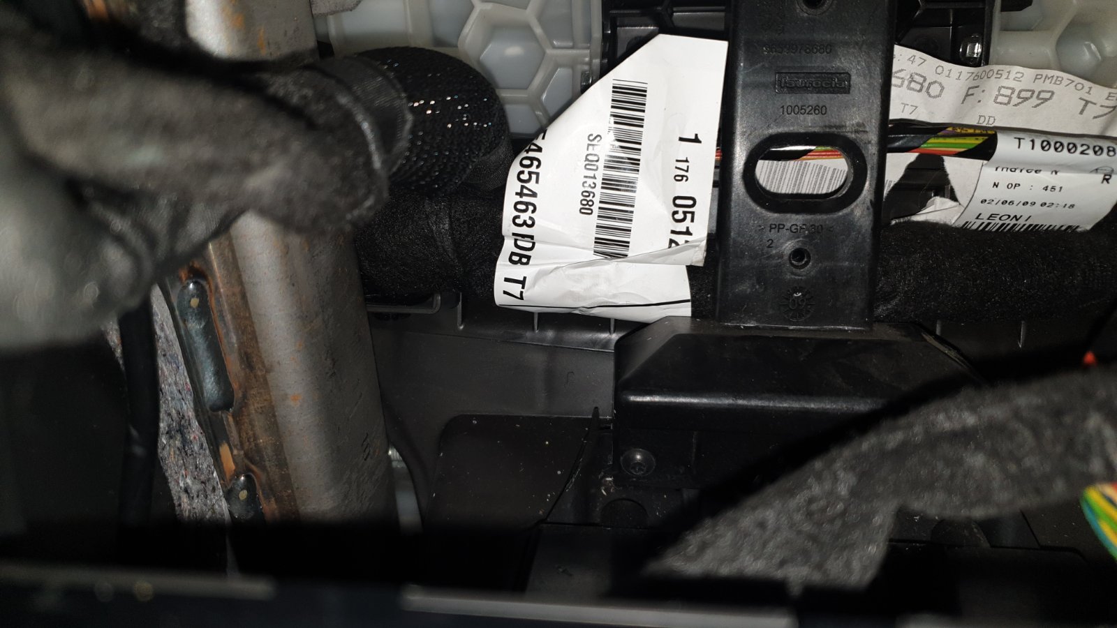

hey, dont mean to revive old thread, but just asking, was your rd4 somehow the 03 version? do you have a photo of the label? i am trying to swap fascias from rd4 to rd45 and its not fitting electrically, was wondering if its only the rd4 versions that worked with nomade v2 whose fascias you could interchange.

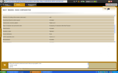

The RD45 menu in Diagbox allows for TA to be enabled:
But I can't see anywhere on the user interface to control whether it is currently active, maybe it is a long press on one of the buttons? The answer is probably in the user manual for a car fitted with RD45.
I am not sure about the door locking, I think that would be in the configuration of the display module.
I just noticed that the screenshot above has an option for digital tuner, I don't think I ever tried that (there is no DAB in this country).
