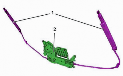

Here's some info in case it helps if some investigation is required:
(1) Motorised tailgate balancing struts.
(2) Motorised tailgate mechanism.
  • The motorised tailgate mechanism performs the opening and closing of the motorised tailgate.
  • The position and the speed of the assembly are measured by a linear potentiometer incorporated in the motorised tailgate mechanism.

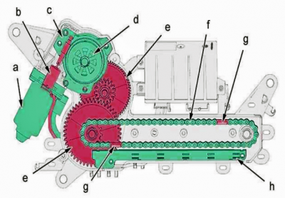

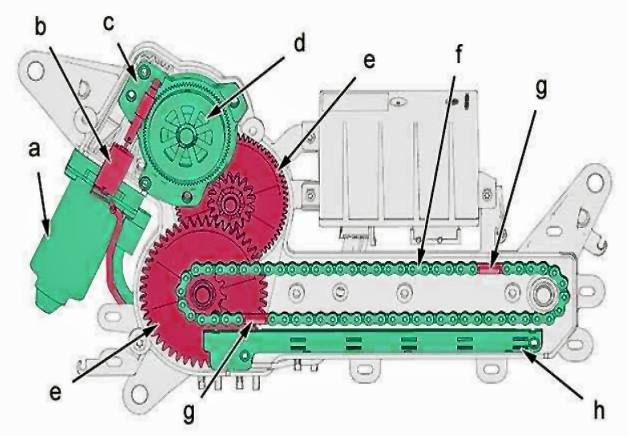

Function
  • The motor of the motorised tailgate mechanism "a" drives the gears "e" in rotation, depending of the direction of opening or closing of the motorised tailgate.
  • The rotation of the gears "e" drives the movement of the chain "f".
  • The fixings "g" of the motorised tailgate balancing strut cables are linked to the chain "f", driving the movement of the motorised tailgate balancing struts, making the tailgate open or close.
  • The linear potentiometer "h" gives the position and the speed of the tailgate to the motorised tailgate ECU.
  • The motorised tailgate mechanism can be clutched via the clutch "c" by action of the clutch motor "b" on the clutch spring "d", which locks or releases the central shaft of an epicycloïdal axle located under "d".

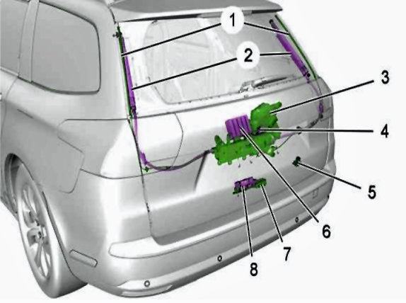

(1) Anti-pinch sensors.
(2) Motorised tailgate balancing strut.
(3) Motorised tailgate mechanism.
(4) Motorised tailgate opening control.
(5) Motorised tailgate closing switch.
(6) Motorised tailgate ECU.
(7) Motorised striker plate.
(8) Motorised tailgate lock.

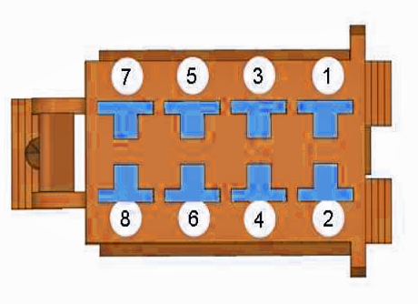

Channel No. & Designation
8-Way Black Connector
1 - Motorised tailgate motor control (Tailgate opening direction if at +)
2 - Motorised tailgate motor control (Tailgate closing direction if at +)
3 - Not connected
4 - Tailgate mechanism clutch motor control (Declutch control if at +)
5 - Potentiometer supply
6 - Tailgate mechanism clutch motor control (Clutch control if at +)
7 - Motorised tailgate position information
8 - Potentiometer earth

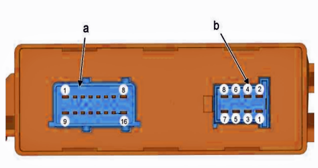

Here are the ECU connections - obviously part 'b' is the male connector of the female shown above in more detail.
Channel No & Designation
Tailgate Locking 16 Pin Connector 'a'
1 - Electrical earth
2 - Lock information tailgate open
3 - Positive control : LH anti-pinch sensor
4 - Positive control : RH anti-pinch sensor
5 - Negative control : RH anti-pinch sensor
6 - Motorised striker plate control
7 - Boot closing switch lighting control
8 - Motorised tailgate opening control status
9 - Power earth
10 - Motorised striker information: gone in
11 - BODY CAN low
12 - BODY CAN high
13 - Control - LH anti-pinch sensor
14 - Tailgate opening exterior control signal
15 - ECU supply
16 - Power supply
