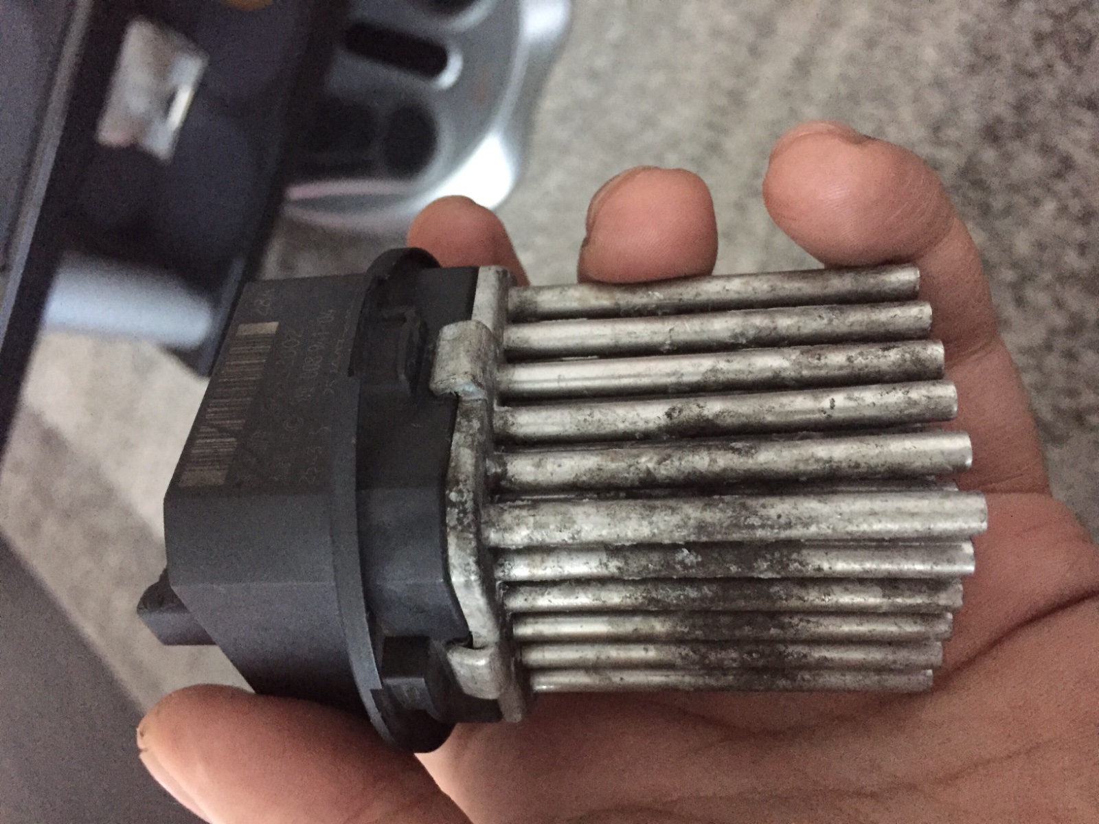

I found the ressistor, but tried for 20 mintues to get it out. But couldnt do it, what is the solution?

So you disconnected the connector - did you turn the control module in the right direction? I think it shows clockwise or right to left.
There's no other way to get it out - but there are no screws.

It looks like it was clockwise, I tried everything, even broke a little part of the ressistor.

It's anti-clockwise IIRC. About a 1/4 of a revolution. And it will eventually come. If you can disconnect the wiring plug first that makes it easier to grasp the top part. In fact, if you can disconnect the plug do that a couple of times and see if that solves the problem.

Paul-R wrote: 14 Nov 2018, 22:36 It's anti-clockwise IIRC. About a 1/4 of a revolution. And it will eventually come. If you can disconnect the wiring plug first that makes it easier to grasp the top part. In fact, if you can disconnect the plug do that a couple of times and see if that solves the problem.
So I have to turn it to the lett when im looking at it straight?
Tried to pull out the cable a few times, but it wouldnt come out.
But the ressistor was looking very rusty, so I think it has to be changed anyways

The plug isn't easy to remove as you have to depress a little plastic tab on the plug and it's something I could only do once I had unscrewed the complete assembly! Anti-clockwise is the left hand side of the assembly going downwards just like unscrewing a bottle top.
I'm curious about you saying it needs replacing because it's rusty as you can't see most of it. I'm wondering what you're really looking at and whether you're trying to undo the wrong thing.

Finally got the ressistor out. But «givemeabreak» the part number on this one is G4532002, not that one you told me. Wich one should I order?

Hi, that’s not the part number. It could be a manufacturer number. Use the one I gave you (6441S7), because that is the official Citroen one direct from their live database and is the same as the dealer will give you.
But again a warning, try not to go for a cheap one, as the quality can be quite poor on these.
Try and go for a HELLA branded one, which will be better quality and about £38 UK Mark, but still a lot cheaper than the original. Just use the part number I gave you for searching.

Ok, thanks. I found a OEM pre owned for 40 pound.
