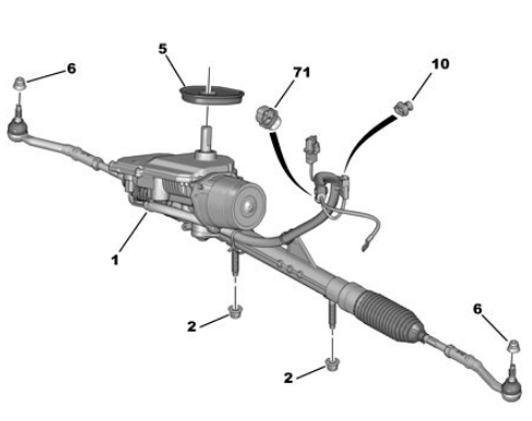

What sort of power steering is fitted to this car?
- x 6945
Re: ESP/ASR system faulty?
It has the electric steering unit fitted directly onto the rack Mike:
No connection to engine - directly connected to battery, type DAE

I imagine that the electric steering rack also has a position sensor for weighting the steering according to angle et, can this be interrogated via diagbox?
- x 6945
The torque and position sensor is incorporated into the unit itself - so the Op would have to see if Diagbox shows separate ECU or not.
