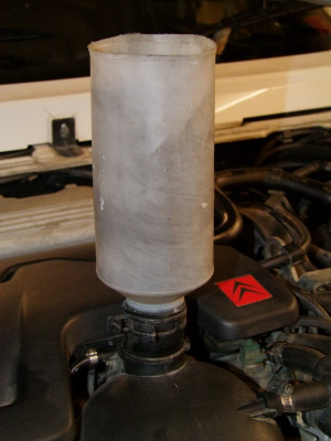

One cause of throw-out is as follows: A small air-pocket (usually in the head or engine block) overheats (because of lack of direct coolant contact) and then causes what is termed 'local boiling'. The boiling creates steam, which forces coolant up to and out of the header tank. (See also final paragraph, concerning the pressure cap.)Cutac wrote: 12 Nov 2018, 14:55 I know there's no theoretical risk to the engine, but what if I lose, let say 100ml while driving? If the tank is filled to the maximum, it would be alright, but if those 100ml's are on the bottom, it might be interesting. It's just that I don't want to risk it.
Also, why would it be a case of a throw out? It's been fine for 6 and a half years, why would it start to happen now?
Air pockets can be difficult to dislodge unless the cooling system is filled and bled thoroughly via all the bleed screws, and sometimes requiring the use of a temporary header bottle to push coolant down into the system via the bleed screws, and allow air out. This is one on an XM, where proper bleeding is essential; it may or may not help on the C4:
Header bottle makes a snug fit in the expansion tank neck, using a short bit of hose, and blocking off any overflow pipe.
Coolant level is brought up to about ¼ way up the bottle, and engine allowed to idle its way up to temperature.
Coolant level in the bottle will rise, and air trapped in the system can bubble out.
Level in the bottle maintained at at least ½ full.
Engine brought up to full temp, indicated by the fans(s) cutting in a couple of times.
Every one of the bleed screws (hoses, radiator, engine) opened in turn to allow trapped air out.
Large hoses can be squeezed to also encourage air out.
Engine left to cool; coolant level in the bottle will drop, as coolant returns to the expansion tank.
When cool, empty any excess coolant from the bottle, remove bottle.
Remove any excess coolant from the expansion tank, down to the normal Level marker.
There should be no real risk in driving for a reasonable distance with the expansion tank coolant level allowed to be low (when cold). It will rise as it heats up, and likely more than compensate for any loss which occurs from the tank. What is of interest (as said) is whether it falls to an even lower level after it has completely cooled - as this would suggest a leak from the system, if it isn't being thrown out at the pressure cap/overflow.
