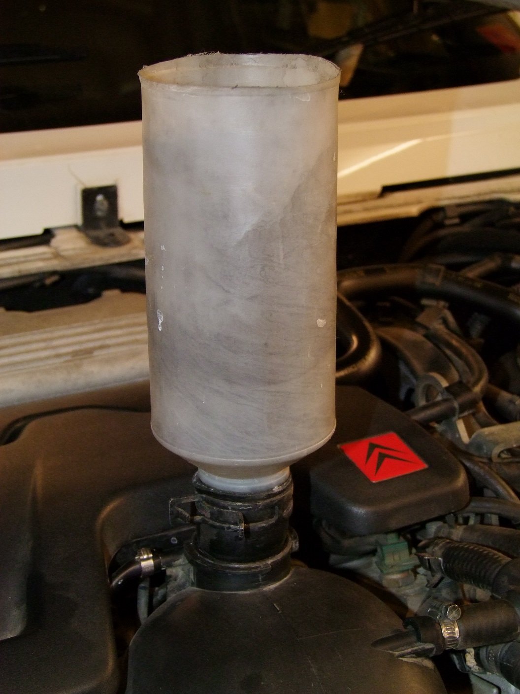

Header bottle makes a snug fit in the expansion tank neck, using a short bit of hose, and blocking off any overflow pipe.
Coolant level is brought up to about ¼ way up the bottle, and engine allowed to idle its way up to temperature.
Coolant level in the bottle will rise, and air trapped in the system can bubble out.
Level in the bottle maintained at at least ½ full.
Engine brought up to full temp, indicated by the fans(s) cutting in a couple of times.
Every one of the bleed screws (hoses, radiator, engine) opened in turn to allow trapped air out.
Large hoses can be squeezed to also encourage air out.
Engine left to cool; coolant level in the bottle will drop, as coolant returns to the expansion tank.
When cool, empty any excess coolant from the bottle, remove bottle.
Remove any excess coolant from the expansion tank, down to the normal Level marker.
There should be no real risk in driving for a reasonable distance with the expansion tank coolant level allowed to be low (when cold). It will rise as it heats up, and likely more than compensate for any loss which occurs from the tank. What is of interest (as said) is whether it falls to an even lower level after it has completely cooled - as this would suggest a leak from the system, if it isn't being thrown out at the pressure cap/overflow.
