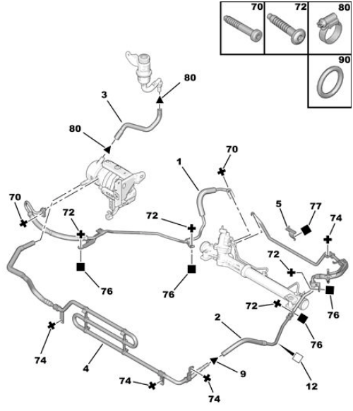

Ok, so this is quite interesting...
You have the DW10CTED4 163 engine and on this model the Low Pressure Supply Pipe to the PAS is not available on Citroen parts - in that it is simply not listed. Yet on other engines like mine (DW10BTED4) it is available.
Can you identify if it is pipe 2 or other from this diagram - Click image to zoom it up.

If it is pipe 2 in the diagram then the old one can be removed and new one fitted without too much drama. The pipe splits at point 9 in the diagram and you only actually need to replace the section from '9' on the diagram towards the rack. The 'S' bend section of the pipe at number '4' doesn't need to be touched.

I do know that there were various evolutions of 'pipe 2' over the years. The 'S' bend seemed to come and go on a whim with each new part number. I think there were a few minor changes of clamp/bolt down positions as well, but none of them were show-stoppers. I'd be inclined to think it's more cock-up than conspiracy on Citroen's part
I do think the problem with these pipes is that - in common with other manufacturer's - they're intended to be single use fitment as there's a 'crushable' element to the pipe where it enters the steering rack.
I do have a spare 'pipe 2' in the shed if comparisons need to be made
