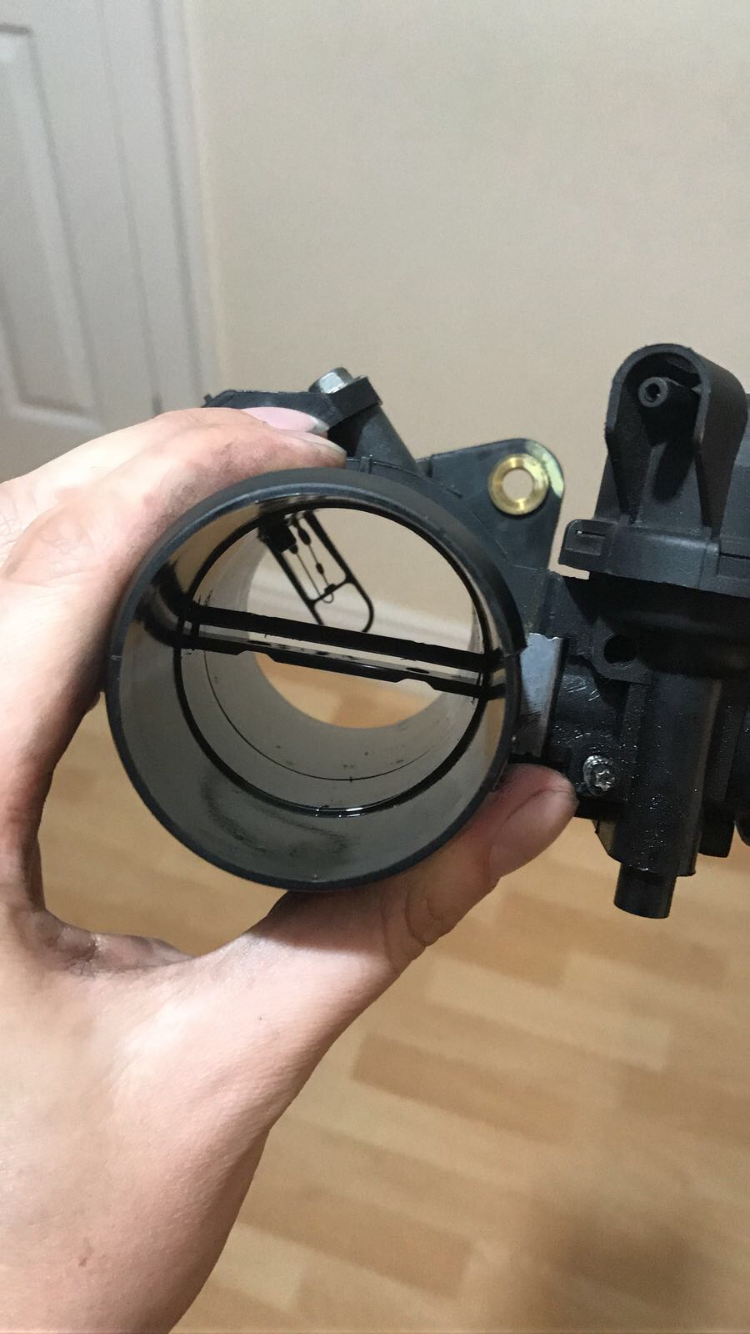

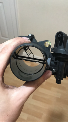

Well, I think perhaps the siemens double doser system is more sophisticated than the single Delphi one.
moizeau wrote: 02 Nov 2018, 18:43 So in effect, you could remove the butterfly from the body (or in my case both), leave everything else in place so the car thinks it's doing as it's told, happy ever after...
Something like this:
I tried that as at the time I suspected the flap was causing a hesitation that I sometimes get.
It behaved exactly the same with or without the flap fitted. The only difference is the rather rough way the engine shuts down; which the doser also assists with.
