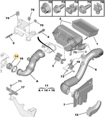

Sorry, I've been a little busy - he has an X7 Mike:
C5 (X7) 4 DOOR SALOON 1.6 HDi 110 particle emission filter (DV6TED4) Manual gearbox 5
Turbo Air PipingAir Filter Hoses
1434C8 is the highlighted Part 14 - the sleeve on the piping after the MAF

Yep, pretty much same layout as my engine, Marc
If #14 is leaking, the turbo will be sucking air that's unmetered by the MAF.

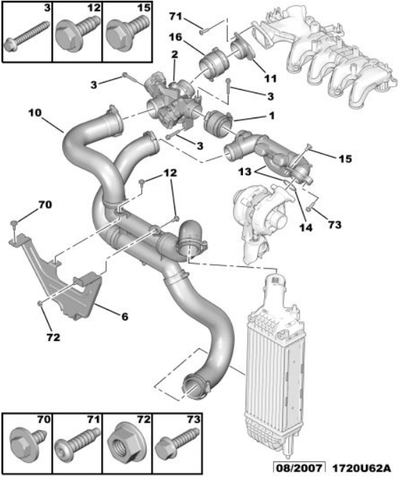

And here are the turbo air union pipes - is this what you were looking for?

Admiral probably asked for those as I mentioned them being a possible cause of his issue but I'm 99% sure he's ID'd the issue with part#14 being broken. Shame the mechanics didn't check it as they did say "low pressure" on the turbo inlet side - which I now take to mean low MAF reading.
ETA: That's also likely to have caused regeneration failure too and the risk of dpf clogging warning.

Thanks Marc,Mike
I was looking at the right parts just did not realise :cry:
I have put the sleeve back in, reason i noticed it was because oil ( not a lot ) has been dripping from it, j clip was and is still tight but guess oil is from EGR system.
I need to pay more attention to the car, do not drive it very often so could have been dripping for a while as i guess they did not remove the pipe :?
Not slating them, i asked for diag without proper equipment so stopped them as soon as they said TURBO lol
Going to order the sleeve regardless, not going to fit it until i have had a diag session, even i can change that part in under 4 hrs :)
Marc thankyou for the parts picture have now checked prices and all turbo vac lines and the sleeve come to about £140 , though if you could check it for me much appreciated.

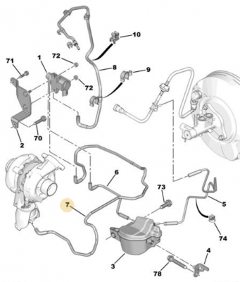

x 6957
Re: C5 2008 (X7 ?) Turbo Fault
Which numbers on the diagrams do you want prices checked?

Marc i am thinking 6/7/8 are the pipes that go to the vacuum actuator ?
Just looking at what i can change for not too much outlay, the sleeve insert that you identified as #14 i think is just under £19 inc vat much cheaper than a turbo :)
