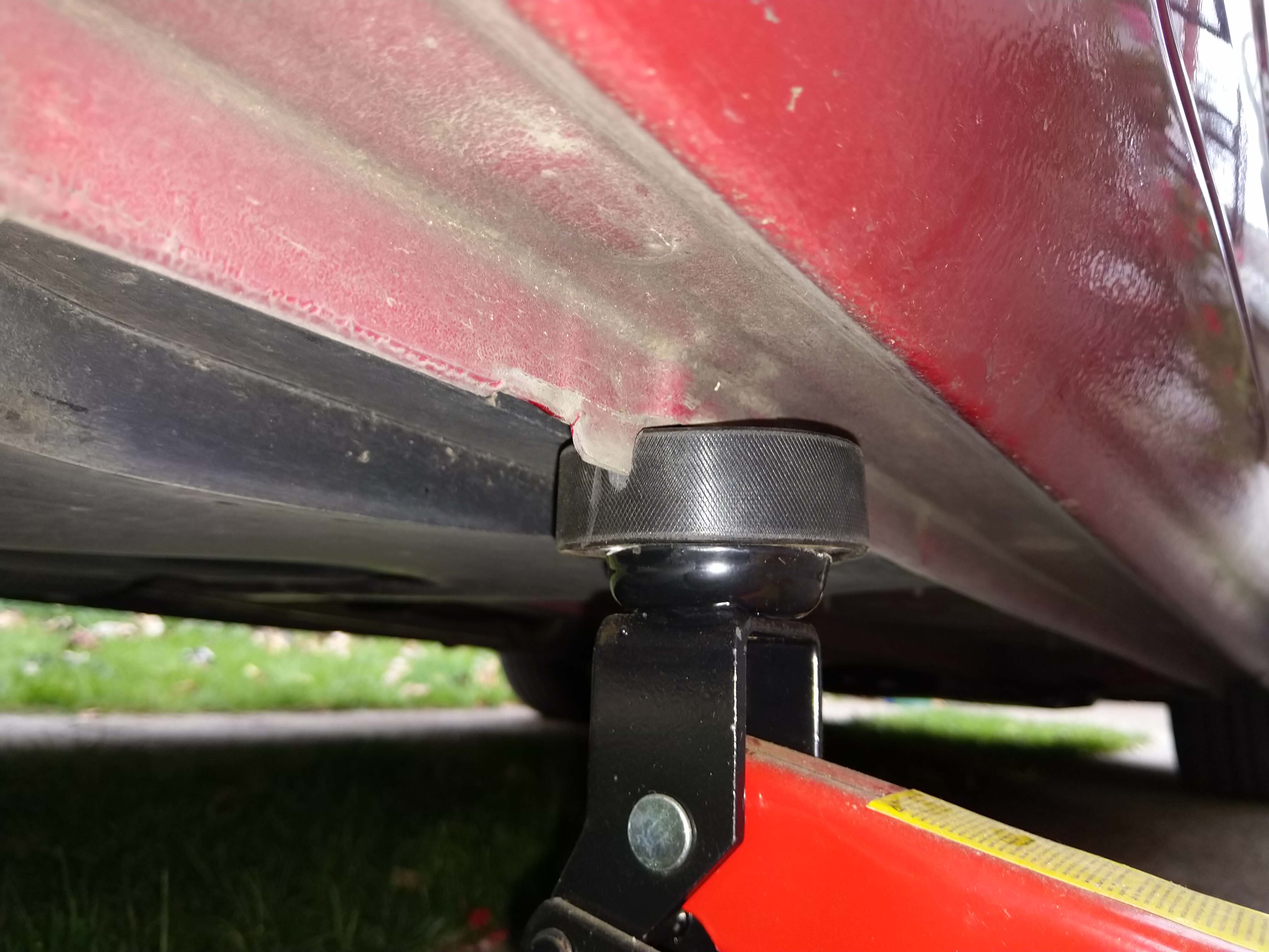

Why can't Citroen make a proper flat surface for jacking?

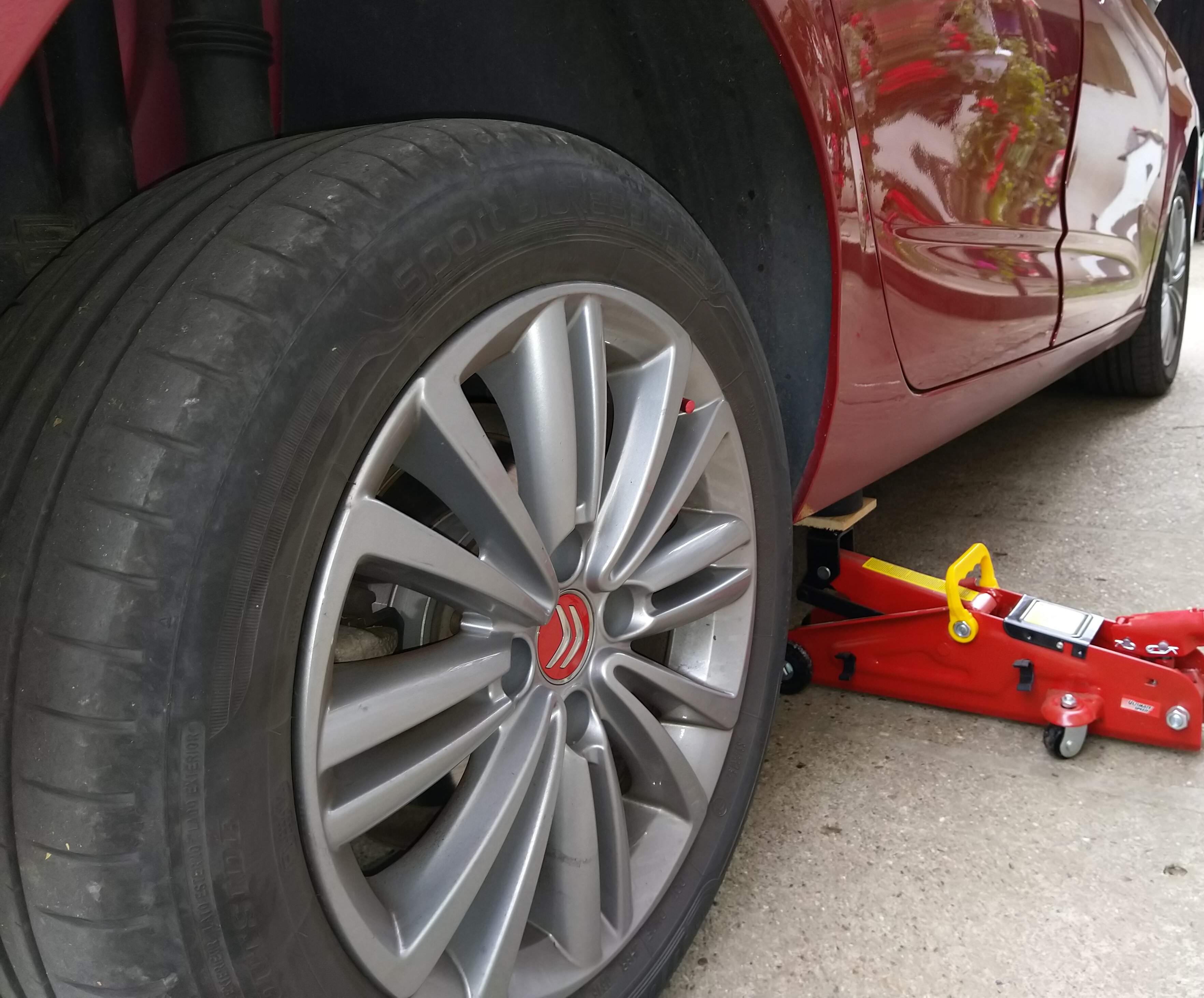

I still haven't found anything to put in between, I hope I'll find a hockey puck somewhere to buy.
And the problem is that the lug on the VTS is longer than the radius of the jack so it doesn't sit inside the cup. Especially with driver's side lug being bent. It's really giving me a headache...

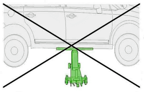

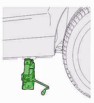

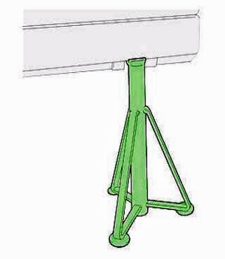

Re: How to jack up a c4(old and new) using a trolley jack?

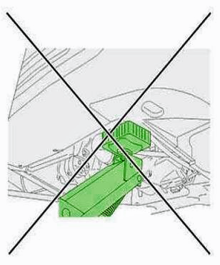

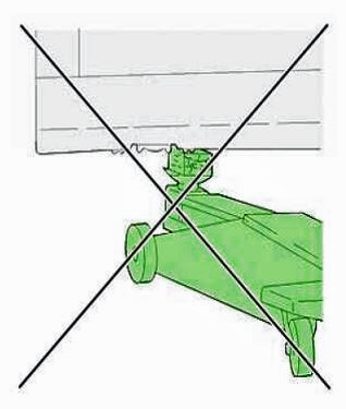

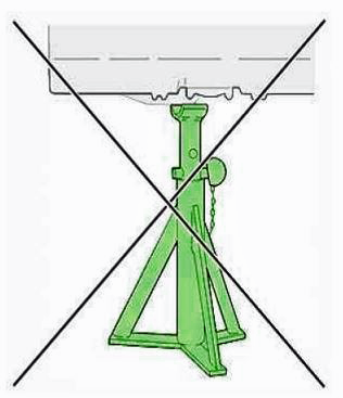

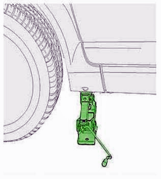

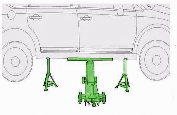

Just for completeness, here's the C4 lifting guides that I said I would post up for future reference and for others:
| Front of Vehicle: CAUTION: Do not lift the vehicle via the front. CAUTION: Never lift by means of the front panel supports. | Sideways Lifting: Do not position the jack away from the lifting points |
| CAUTION: Do not position the stands under the jacking points. | Correct positioning of the stand. |
| Vehicles with Body Sill Trims CAUTION: Do not lift the vehicle from the side by taking weight on the body sills. |

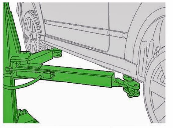

Vehicles without Body Sill Trims Side lifting crossbeam [0010]. Positioning of the crossbeam. Take weight on the sill with the crossbeam, as close as possible to the mating plate. Position the stand at the location provided for lifting the vehicle with the jack provided. N.B. : To have 2 wheels suspended, repeat the operation on the other side. |
| Lifting from the Rear CAUTION: Do not lift the vehicle from the rear. Lifting by Vehicle Jack Lifting from the Front | Lifting from the rear. N.B. : The jack is specific to the vehicle, do not use for other purposes. |
| Column Lift: Where it is possible to access the jacking points:- Position the lifting blocks underneath the lateral jacking points. |

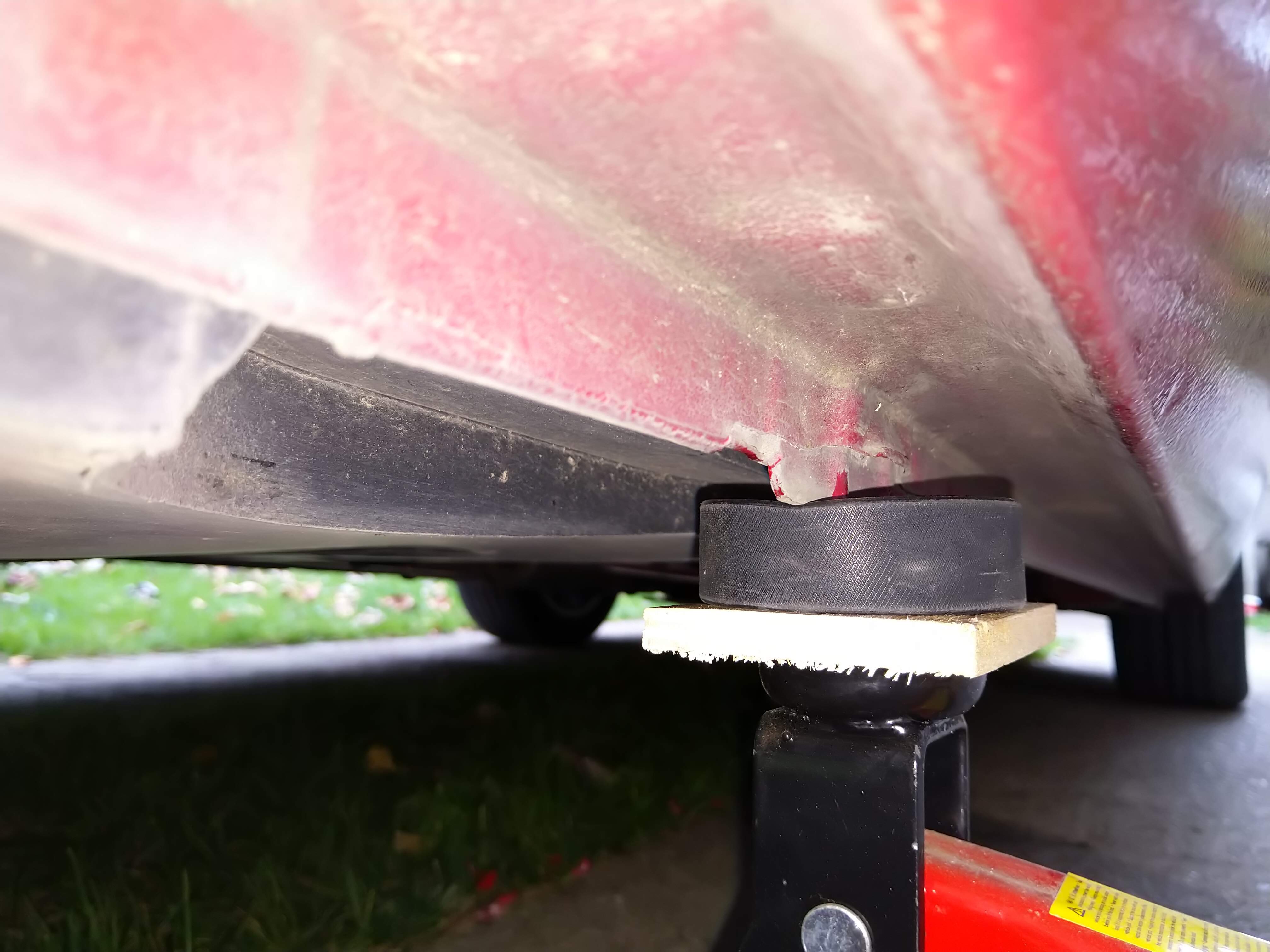

Bought two pucks. I've slotted one and left one as it is. Both seem to be working fine.
It's just that I feel uneasy after the incident with the VTS's sill...

They look just the job!
Cutac
- Posts: 348
- Joined: 28 Aug 2016, 19:36
- x 20
Yup, and I honestly hope nothing is going to slip this time.

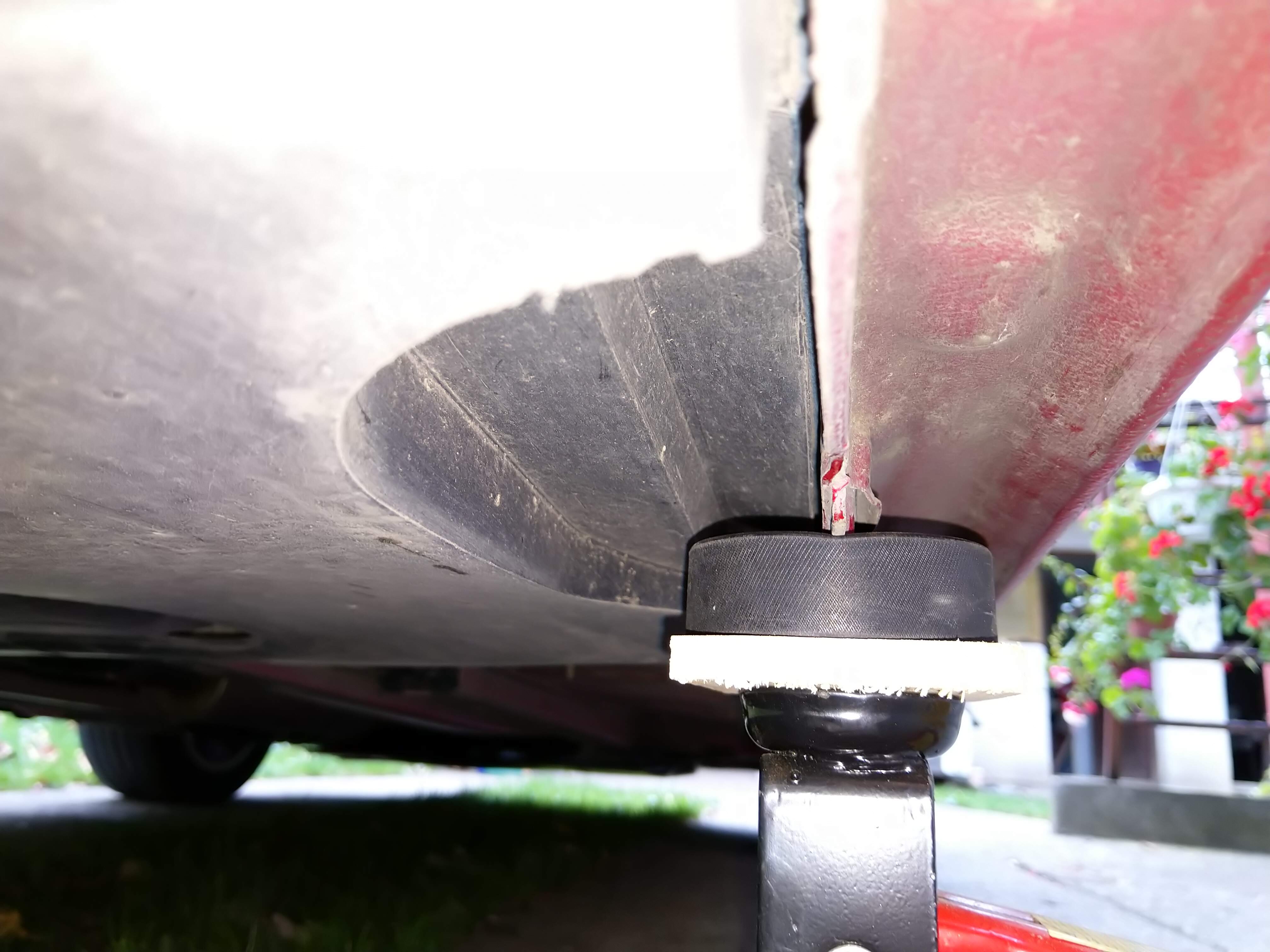

Puck proved itself great. Two cars, VTS and Panda and it handled them with no issues.
Will see tomorrow on the c4 and an Insignia.
I used the slotted one and it didn't split or show any signs of splitting.

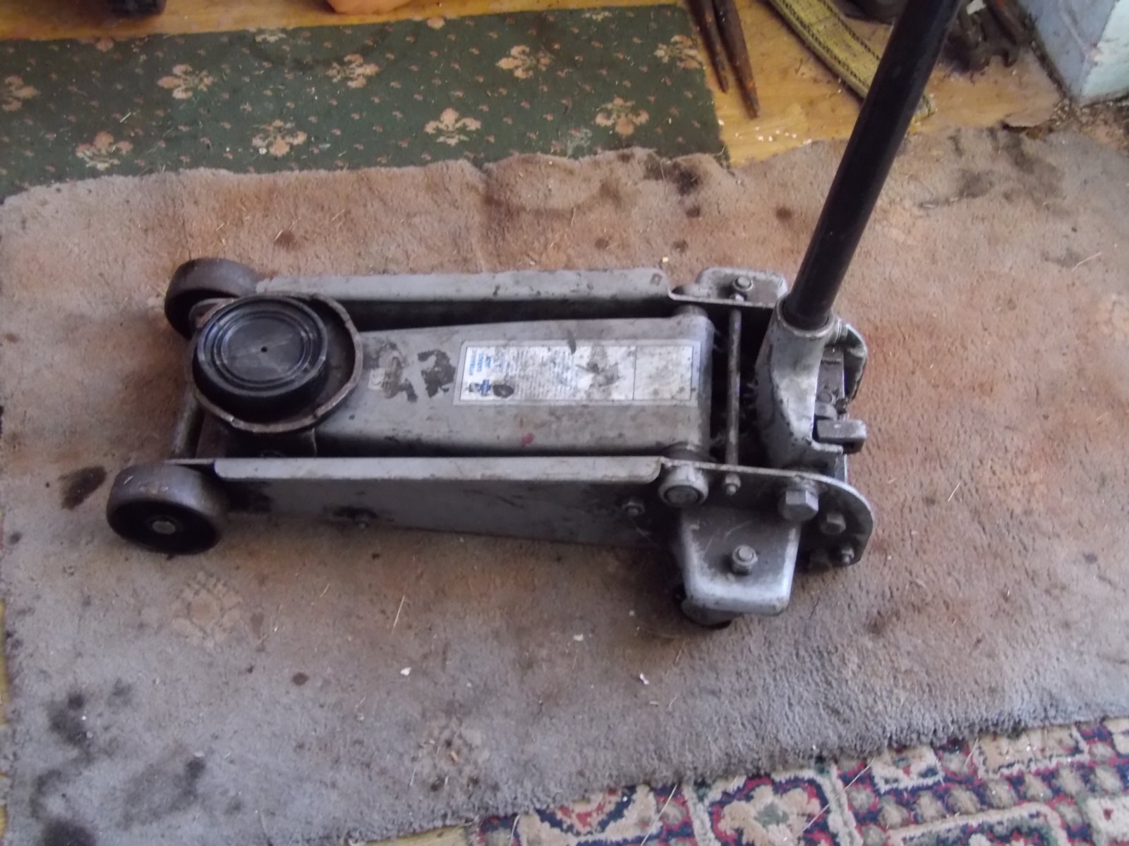

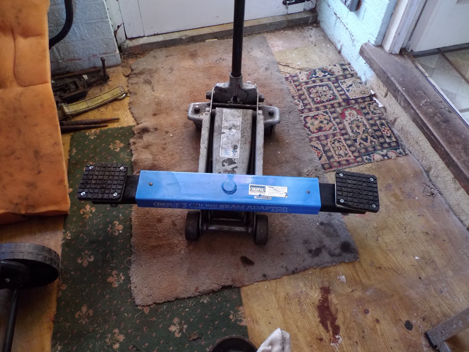

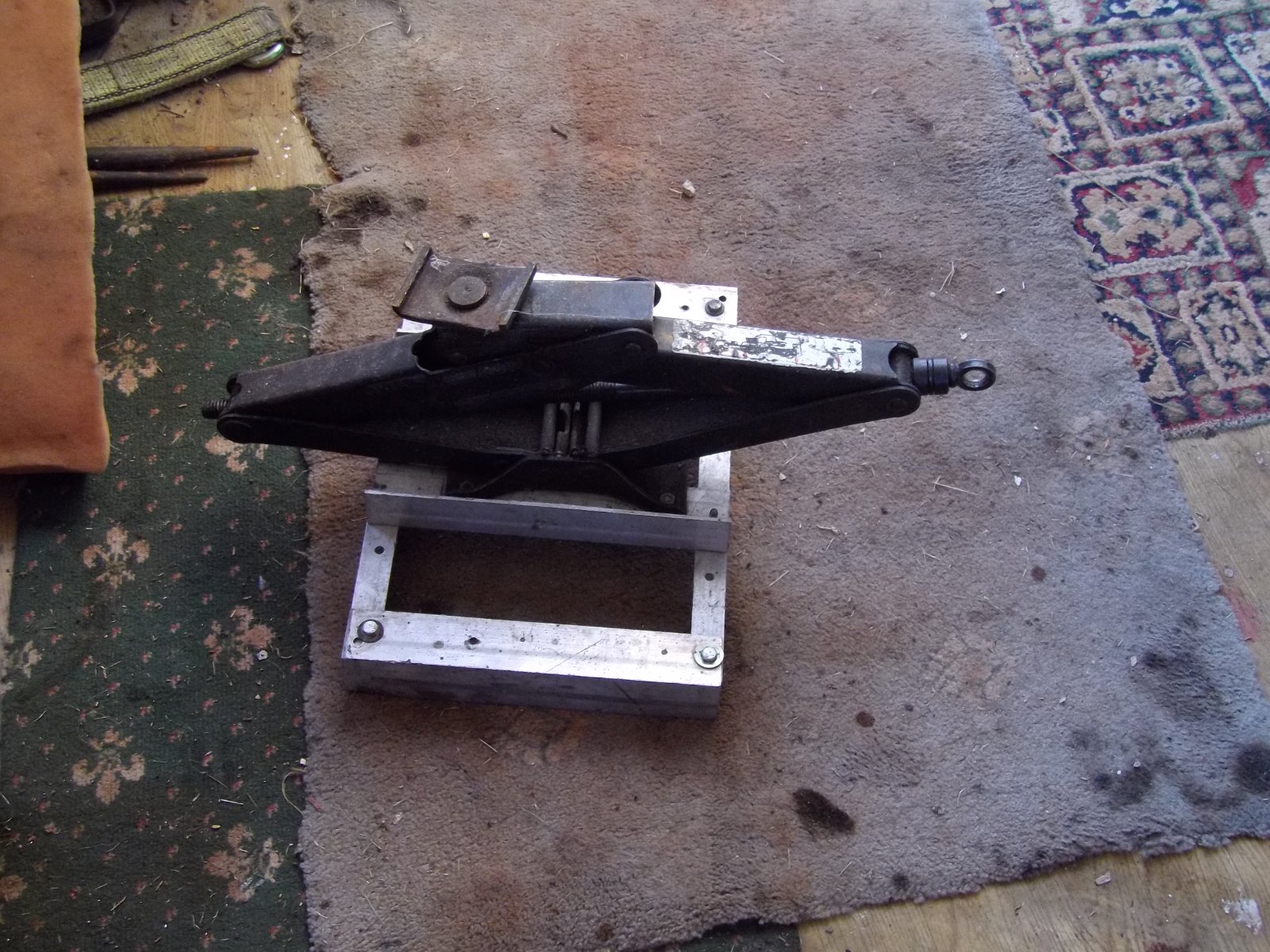

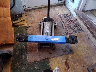

- x 2941

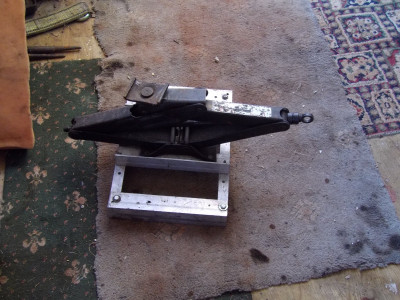

Here's a couple of my many jacks collection. One jack with rubber pad, same jack with Draper adapter, can be used to lift under both side jacking points at once or under front and rear and an engine jack I knocked up for when removing a gearbox.
