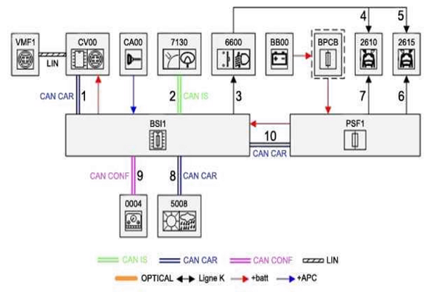

Going back to what Sparksie said. that was what I was trying to convey about the BSI and the electronics involved on these modern cars. The lighting system has a lot of 'and', 'or' 'if' logic to determine what and when lighting comes on and for how long and under what circumstances. Of course manual switching on of the lighting always takes preference over the automatic functions. However the digital Body CAN and Comfort CAN and LIN data networks also play a significant role in the sending of communications between all the components.
These are the functions managed by the exterior and signalling lighting on an X7 and also the systems equipment used in their operation:
  • Automatic switching on of the dipped headlamps by means of exterior brightness management (Rain and brightness sensor )
  • Flash of headlamps
  • Directional headlamps (dynamic cornering lighting and automatic beam height correction) or manual beam height correction
  • Manual follow me home lighting (Switching on of the lights on unlocking)
  • Automatic guide-me-home lighting (Follow me home)
  • Remote switching on of the lights
  • Remote location of the vehicle
  • Management of the daylight lamps
  • Automatic lighting of hazard warning light on high deceleration
  • Management of the priority of the direction indicator lamps
  • Switching on of the lights for the trailer
  • Number plate lighting
  • Detection of faulty bulbs
  • Management of the lights-on warning buzzer
  • Instrument panel - Central instrument panel display.
  • Hazard warning light indicator.
  • RT4 audio/telephone.
  • Manual headlamp beam adjustment.
  • Switch module at the steering wheel (Lighting switch part).
  • Steering wheel with fixed central controls.
  • Rain and brightness sensor .
  • Trailer relay unit.
  • Built-in systems interface .
  • Connection board - fuse box(Engine compartment).
Example Flow Chart (for Halogen System only) Dipped / Main Beam

Yes, following my visit today, I can confirm you're correct, the fog lights on this one don't work in SIDE, but they do in OFF, AUTO and HEAD. I repeat, the only way to extinguish the headlights is to turn the ignition off.
There are no faults in the BSI relating to lighting.
This not being my car, and given the extraordinary rate at which faults are developing with no interference from me, I'm very reluctant to touch it at all, let alone deviate from the standard.
If I ever find myself in the unfortunate position of owning one of these, I'll cheerfully chop out all nonsensical computerised gimmicks at the first sign of trouble and design my own loom for required functions, secure in the knowledge that, if it all goes wrong, it can be weighed in and all I'll have lost is some free time.
With this one, my fingers have been badly burned and my charitable streak has been virtually erased.
