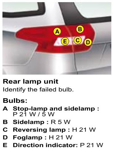

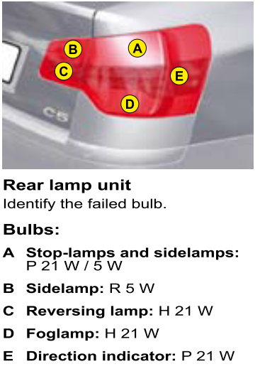

Yes all C5s are multiplexed. The X7 is a full CAN vehicle (and I'm assuming this is an X7, and not a late registered Mark II (facelift).
Assuming I'm correct, you'll need to ascertain which tail lights have gone as there are 2 lots. One on the combined Stop / Tail Bulb and a separate one. Here are the locations for a Saloon and a Tourer:
Just to make life simple - the bulbs are contained in 2 sections - the actual body wing and the others are in the boot lid (Saloon) or tailgate (Tourer).
I think it is safe to rule out an earth as both the left and right hand sidelights have separate earth points, so unlikely for these both to have a poor earth at the same time.
ALL front lighting is controlled by the Engine Bay Fuse Box, ALL rear lighting is controlled by the BSI.
Get ready with Diagbox as you'll probably need that to get a code.
| Saloon | Tourer |
