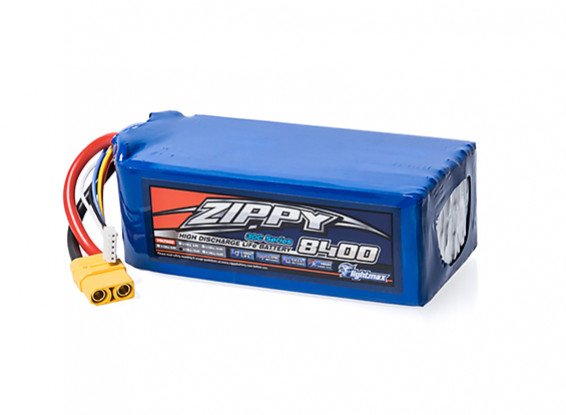

Found an alternative to headway single cells - a readymade 4S2P 8.4Ah (40C burst) with balance lead.

Meanwhile found a similar 4S1P 8Ah (40C burst) pack in their UK warehouse for £20 less so have ordered that instead.

It's one of those prebuilt hobbyist zippy packs (made up of rectangular soft cells), bought from an online model shop. It's what I used originally as a portable car charger only this one has more voltage/current than the packs I was using. Comes with balance lead and XT90 connector.

This is the LifePO4 pack I've ordered.
