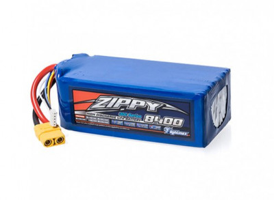

Found an alternative to headway single cells - a readymade 4S2P 8.4Ah (40C burst) with balance lead.

Meanwhile found a similar 4S1P 8Ah (40C burst) pack in their UK warehouse for £20 less so have ordered that instead.

It's one of those prebuilt hobbyist zippy packs (made up of rectangular soft cells), bought from an online model shop. It's what I used originally as a portable car charger only this one has more voltage/current than the packs I was using. Comes with balance lead and XT90 connector.

This is the LifePO4 pack I've ordered.

I expect my pack to be capable of delivering 650A without damage though I'm bit short on real-life data of what Amps my car(s) use.

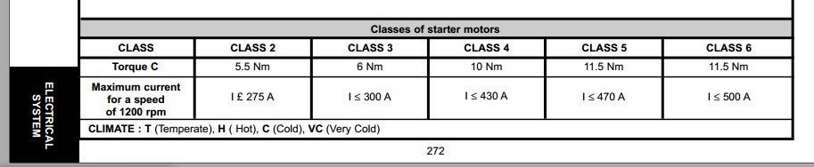

Can't see this data in the C5 pages, but for XM, where several levels of starter motor were fitted (2.5TD = Class 6) . . .

The MK II C5 was only fitted with a starter from Class 3 to Class 6, depending on, engine type, equipment option and country of destination (for climate).

Assuming I have the Class 6 500A starter, what would be worst case scenario - coldest day (-12c last year!), is it likely to exceed say the 600A limit of a clamp-on ammeter?
