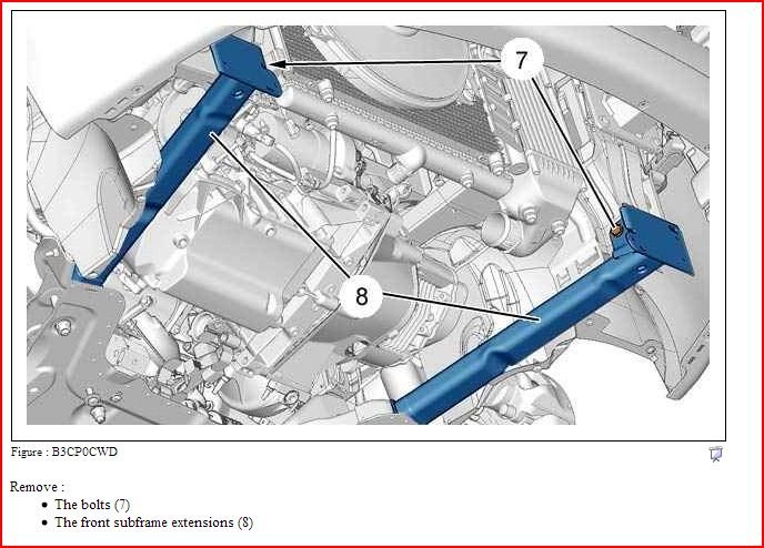

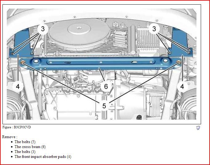

That bit directly under the gearbox is separate from the subframe, and can be removed:
Yes, the bolt / nut you pointed at is the one that will likely prove difficult......

GMAB that's what I thought with the can clip, until I deleted xp, then my interface didn't want to work with W10.
Legend, Richard can I ask where you got these images from? That looks so much easier

GiveMeABreak wrote: 14 Oct 2018, 20:09 No, all correct.
Cheers GMAB, i was thinking that this might have been the case!! What about those pictures, are they from a workshop manual etc?
Regards
x 6955
Re: C4GP Gearbox, noise, wont start & Video
A few of us have access to some material that we can help out others with the odd diagram.
