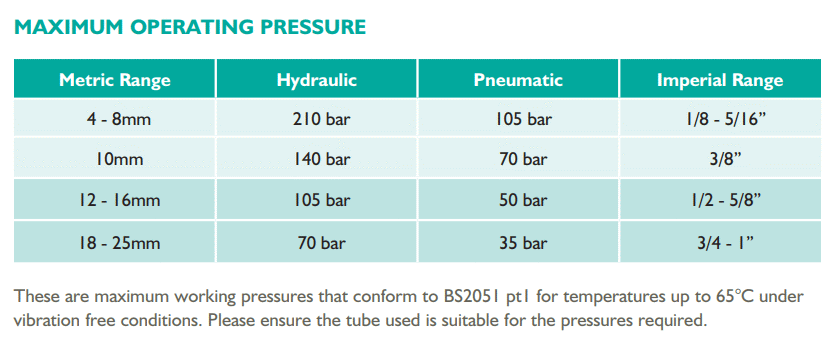

Just out of curiosity, I looked at the question of whether compression fittings are suitable for Citroen hydrauulics or not. I'm not sure it's as clear-cut as suggested earlier.
I've attached an excerpt from the specification published by Wade, a UK compression fitting manufacturer. They state that the maximum operating pressure is 210 bar.
Now, the obvious caveat is the bottom line - please ensure the tube used is suitable....
One thing I noticed is that Wade use parallel copper olives which may give a better grip than the more usual shaped brass ones.
Equally, the entire hydraulic system on a Xantia is not exposed to the maximum pressure achieved at the accumulator. A good example is the power steering. I've tried and so far failed to find a specification that sets out the peak pressure in this circuit, but the pump has a high pressure (2 piston) and a low pressure (six piston) side, so my guess is it operates at less than 100 bar, probably a lot less.
I haven't done it yet, but the next time I need to replace a rotten section of PAS pipe on a Xantia, I don't think I'd worry too much about using a compression fitting.
I probably wouldn't try it on a brake or suspension line.

...and the remainder of the caution too: vibration-free, and temperatures up to 65°C.CitroenCrazy wrote: 06 Oct 2018, 21:10 Now, the obvious caveat is the bottom line - please ensure the tube used is suitable....
Under-bonnet conditions regularly top that figure.
My understanding is that current MoT regulations prohibit the use of these fittings for high-pressure vehicle hydraulic lines, unless the olive involved is brazed or welded to the pipe, or an integral part of it. I can't quote chapter and verse on this, but someone here may be able to.
Do take your point about lesser pressures in some parts of the system.
