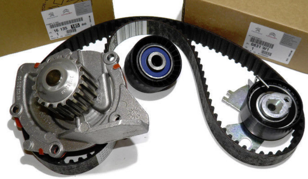

I found an item on eBay under the same part number ?1613561780? would this kit be ok?
https://rover.ebay.com/rover/0/0/0?mpre ... 2223607260
- x 6946
Re: Cambelt change on an automatic c5 tourer 2010 2.0 HDI
I’m struggling to locate that part number anywhere in that listing.....
There’s one here though OEM genuine £120
https://www.ebay.co.uk/itm/TIMING-CAMBE ... 2260584559

Thanks Marc, I think I’d rather buy the genuine kit from the main stealer.

But as for the parts - I always quote official parts for the very reason that people then know what the original [art numbers are for their specific car as per the VIN - which tells everything it has when it left the factory. Vehicle registration numbers and third party databases are notoriously flawed and I won't use them without a proper part number. I've seen too many end up being wrong, incorrect or dead on arrival.
Incidentally, that part that I linked to is a genuine Citroen one on ebay - I can tell from the photos - it is in original packing with the correct part numbers on each box - and even with the postage totalling £131 - it is still £80 cheaper than the main dealer.
