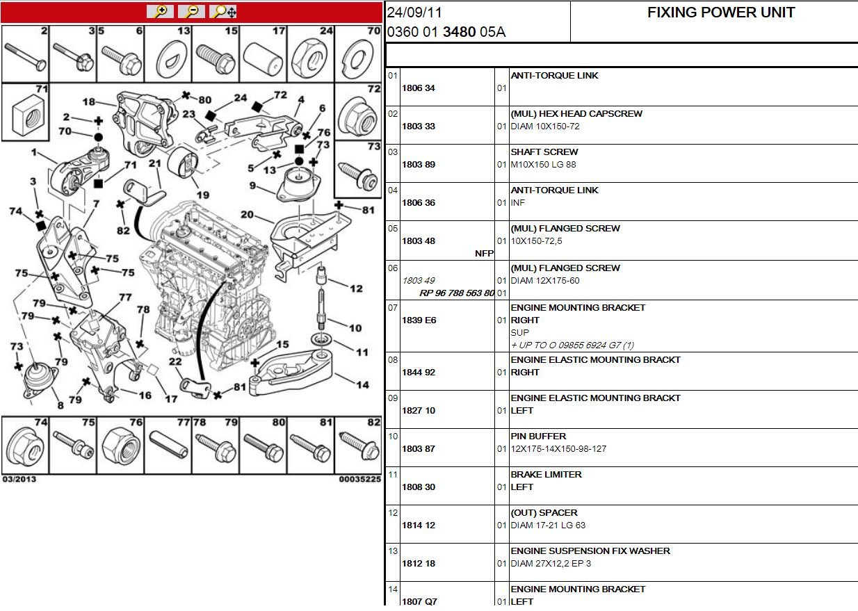

- x 6945
Re: C8 left Engine/gearbox mounting bracket
I will have a check for you..
Yes the driveshafts are both the same - but beware the gaiter kit for item number [4] on the parts diagram I posted up previously is different between the 2 models, so if replacing make sure you order the correct one with the part number in the schematic on the previous page.

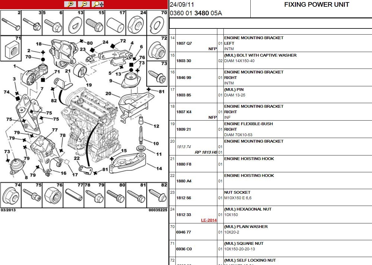

Hi new here does anyone know the part number for the left engine mount that goes between the mount and bolts to the engine please Citroën c8
- x 1746
VF7**************[VIN obfuscated, can be read by forum staff] thank you
Hi Paul,
Hope you can identify from here:
C8 FAMILY SALOON 2.0 i 16v 138 Manual gearbox 5
? Click to enlarge
? Click to enlarge
Thank you white exec it is 16 mate
- x 6945
Item (16), Part 184699, is £135.74 inc. VAT from Citroen.
