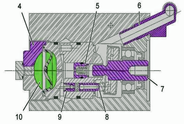

The BHI, a monoblock which cannot be taken apart, is composed of the following components:
But honestly, if the pump is running but no height movement is occurring, then I can only suggest that the electrovalves are not moving and permitting any fluid through. As you have now depressurised the system, it would appear that the anti sink valves have opened allowing the fluid back into the tank, but because of the remaining issue, you can't get any fluid travelling back.
So the codes are really needed to progress.
- An electric motor to drive the hydraulic pump
- A hydraulic pump with 5 axial pistons
- An anti-pulse accumulator, flow regulator
- 4 electrovalves : 2 per axle, 1 for inlet (raising the vehicle), 1 for outlet (lowering the vehicle)
- An electronic suspension ECU
- 2 anti-sink valves
- 6 hydraulic fluid filters : upstream and downstream of the electrovalves
- 1 overpressure valve
| Reference | Designation |
| 4 | Anti-Pulse Accumulator, Flow Regulator |
| 5 | Overpressure Valve |
| 6 | Hydraulic Pump Air Intake Aperture |
| 7 | Hydraulic Pump Shaft |
| 8 | Hydraulic Pump Piston |
| 9 | Delivery Valve |
| 10 | Chamber Containing Compressible Gas |

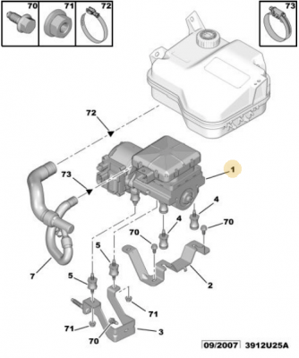

You need either part 5277K0 or 5277J9.
Item 1 below
Item 1 below
