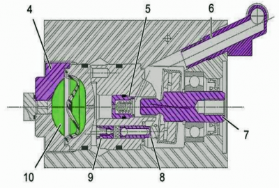

The BHI, a monoblock which cannot be taken apart, is composed of the following components:
  • An electric motor to drive the hydraulic pump
  • A hydraulic pump with 5 axial pistons
  • An anti-pulse accumulator, flow regulator
  • 4 electrovalves : 2 per axle, 1 for inlet (raising the vehicle), 1 for outlet (lowering the vehicle)
  • An electronic suspension ECU
  • 2 anti-sink valves
  • 6 hydraulic fluid filters : upstream and downstream of the electrovalves
  • 1 overpressure valve
ReferenceDesignation
4Anti-Pulse Accumulator, Flow Regulator
5Overpressure Valve
6Hydraulic Pump Air Intake Aperture
7Hydraulic Pump Shaft
8Hydraulic Pump Piston
9Delivery Valve
10Chamber Containing Compressible Gas

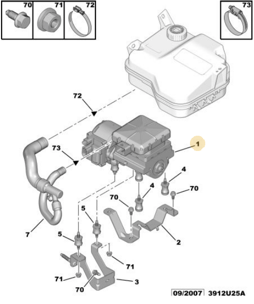

You need either part 5277K0 or 5277J9.
Item 1 below

The pumps are generally the same - it is the ECU (the square unit that sits on top) that have to be configured according to Engine Type, Saloon, Tourer, Gearbox Fitted, Whether Crossback or not, etc., as this affects the suspension programming and operation.
x 6950
Re: C5 suspension fault
Hi Phil
So we know you have the identical BHI and pump unit as a replacement (confirmed by PM).
So what you need to do now is ensure the system is properly bled.
The procedure is in my post here:
viewtopic.php?f=3&t=59281&hilit=10+time ... 15#p573444
Sometimes it can take a while to rise after the fluid has been changed (or in this case the pump replaced - which will have needed a depressurisation and fluid top up).
You may need to apply a bit of air pressure in the top of the tank to get it going - but try the procedure first.
