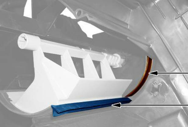

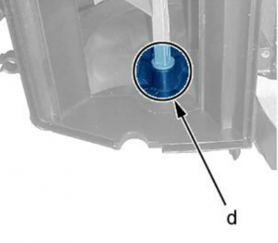

Ok, bad news on the heating issue I think Gav. It was a known fault on the C5 and the 407 that the mixing flap control rods were too weak and tended to snap off. They did issue a Technical Service Bulletin (TSB) for this back in 2009. If it is the control rods that have snapped off, then it's the dashboard off and disassembly of the heater block to get to them for a repair......
The replacement of the strengthened parts and all the labour was about 5.7 hours :shock:
Perhaps it's time to get out the thermal budgie smugglers or the air conditioned undies - depending on where it's stuck at!
