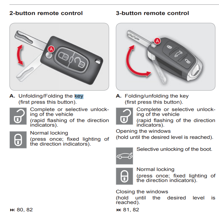

The manual shows 2 types of fob (as does Citroen Service), but he has the 2 button one specified as supplied at the factory. As we know the manual covers both models.
So if you want another fob - get a proper one from the dealer or one with that part number I quoted previously.

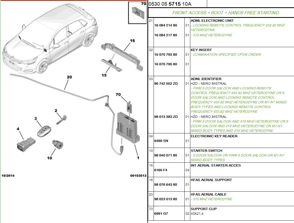

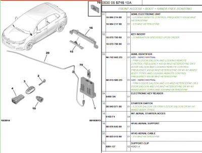

There were 2 options on this C4 . One version that had what they call "FRONT ACCESS + BOOT + HANDS FREE STARTING" That includes the following equipment that is NOT available under your VIN - so no middle button function as you don't have the kit below:
It uses a completely different fob to talk to the receiver unit.
Posts: 9352
Joined: 07 May 2009, 16:24
x 1943
Re: C4 Replacement Fob Not Working
Unread post by Paul-R »
That looks to me as though it's for hands-free starting. It's difficult to tell from the drawing but the text seems to say that it's a three button type remote.
Does that imply that if the car does not have hands free starting then it has to be two button? Or is there a three button non-hands-free fob/key assembly?
x 6957
The 'Keyless' entry system didn't come out on the C4 until December 2014 on, so we know that won't of been available in 2011. So I suspect there will somewhere be a C4 model that uses a 3 button 'DS' style fob - as well as the 2 button version that just unlocks the boot as the middle function. Probably on the higher spec model maybe.
