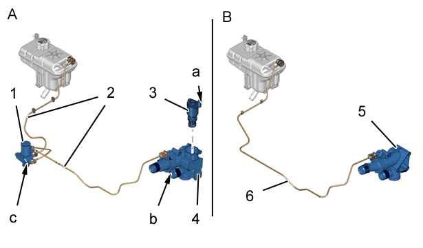

Apparently they modified the housing to do away with the two solenoid valves (the other is a "degassing" valve).
"A" : Previous assembly.
"B" : New assembly.
The following parts have been discontinued :
(1) Venting electrovalve
(2) Degas pipes
(3) Bypass solenoid valve
(4) Coolant outlet housing (piloted thermostat)
The connectors of the following components are disconnected :
Bypass solenoid valve (at "a")
Coolant outlet housing (piloted thermostat) (at "b")
Venting electrovalve (at "c")
Replacement parts available :
(5) Coolant outlet housing
(6) Degassing pipe
3 plastic tie wraps
3 connector protectors
N.B. : The plastic tie-wraps and the connector protectors are fitted on the engine electrical harness connectors.
3. Additional operations
The elimination of these 2 solenoid valves results in the appearance of the following 2 fault codes which do not give rise to any customer complaints :
P1579 : Cooling circuit degas solenoid valve
P1597 : Cooling circuit by-pass electrovalve
If the 2 solenoid valves are absent : Ignore the presence of fault codes P1579 and P1597.

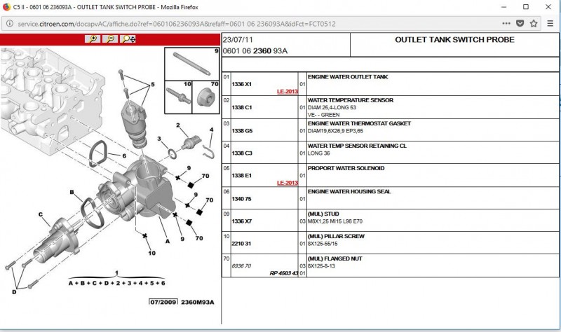

I just checked under the hood. I have the older type with 2 solenoids.
So if i understand it right: the best option is to convert to newer (and simpler) design?
The only thing i don't understand is how the f..... cooling is working at all? :?:
x 6948
Re: C5 II runnig hot (overheating) when towing
So your build date was 2 October 2004 (10190) and that mod was made to vehicles produced from 27 February 2005 (10338). So if you still have those parts the fault could still be relevant, unless you've had the modification in which case it's a ghost.

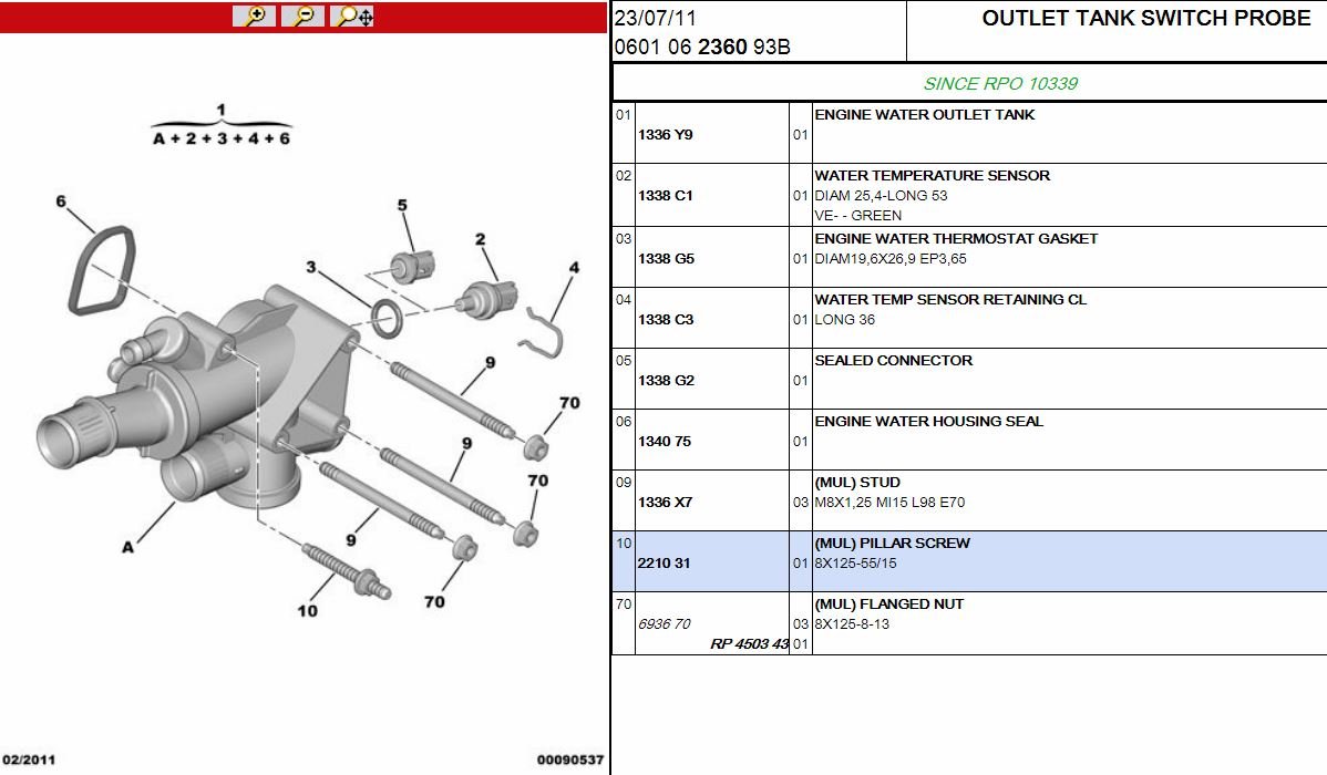

Looks like you'll simply need to replace the complete water outlet tank with the later type...
You'll need the studs, #9 and #10.
Does that housing come complete with its thermostat?
