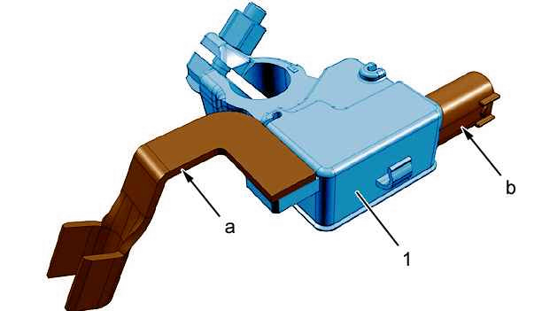

A tip also for you - if you ever charge the battery, it is recommended that it is charged on the vehicle - but make sure that you attach the negative charging lead BEFORE the Battery Charge Status Unit, not directly onto the negative terminal. This is so the unit knows it is being charged and can factor that into any data it sends the BSI.

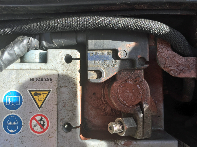

Here;s a few pics of this magic unit:
Always attach the battery charger negative clamp to 'a' on the Battery Charge Status Unit when charging.Here it is on the Battery. (and that's copper grease by the way not rust :-D )

Phew, not much happening then!. Have noticed battery status unit on sons C4. Apparently a new battery was fitted recently as was to my mk1 C5, maybe a swop might be in order as my one is a known age (3mths) and quality.
Deeply in your debt for info, I do like to know how things work.😃
